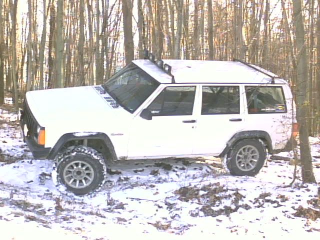

Well first off, I name all my jeeps by color hence the name of the thread, simple right? I currenlty have four jeeps: 95 XJ, 93 XJ, 88 XJ, and 84 CJ-7. This thread will be about the 95 XJ. I bought it in October of 09 with a 3in "lift" utilizing 1''+2'' spacers up front and 1.5" home made block and 1.5'' shackle with stock shocks front swaybar links broken on ford ranger tires and wheels. The main plan for this one is a capable weekend wheeler that i can drive cross country. i have the other three to get crazy with lol
Current specs are:
4.0L 153K
AW4
NP231
D30/C8.25 (27sp)
4DR
Manual doors/windows (which i now prefer after the wiring disater that PO of my 88 bestowed upon me)
RC 3in coils
RE Superflex LCA's
RE GenII disconnects
bastard pack+ 1.5 shackle
RC nitro 9000's
2 hella 500's on the bumper
4 Baja lights across the top on a home made roof rack
235/75r15 treadwright atg's
Hear are some pic's of when i bought it(after the tires/rims:
After lights

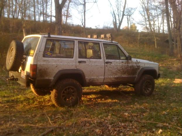

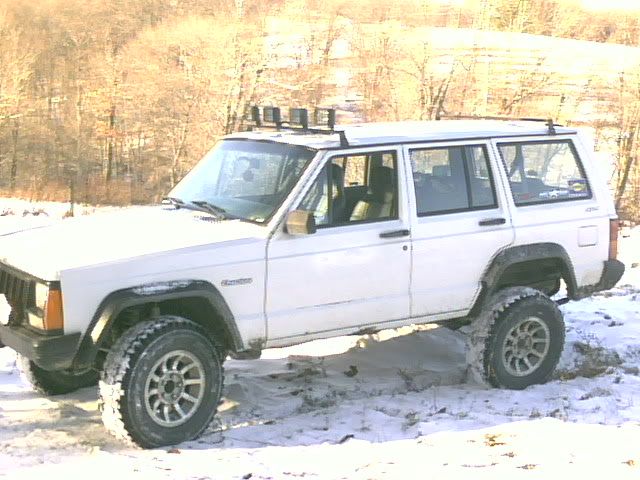

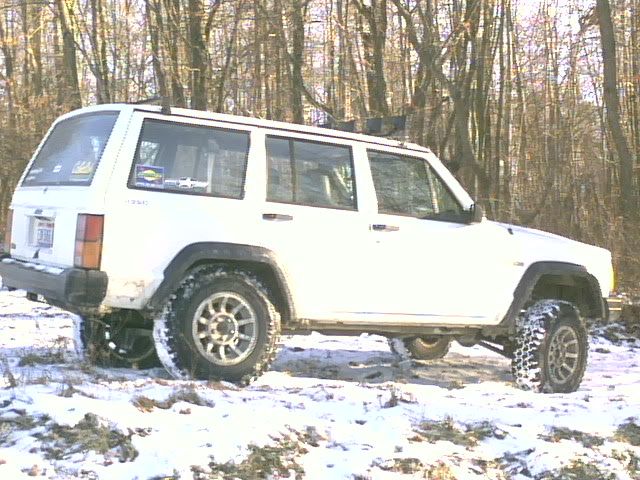

I snapped some pic's of it today while i was out gathering some kindlend(sp?0 to start the wood burner in the garage. hopefully tonight i will get the rear using a bastard pack i built

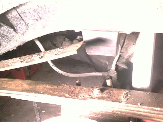

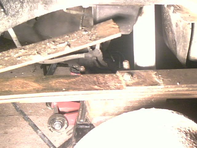

this is why blocks + stock leaf springs on a cherokee can be a bad idea
she isnt sitting on all fours yet. last week i noticed some brake squeal, so i checked the drums while the wheels were off. there isnt much left of the drums or the shoes so im gonna replace them since ive got it all taken apart and im extending the brake lines.

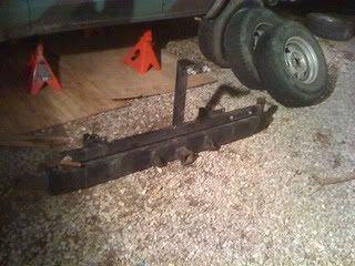

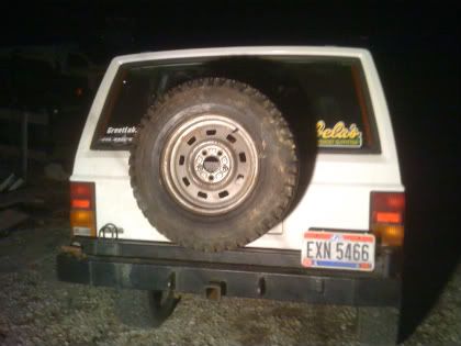

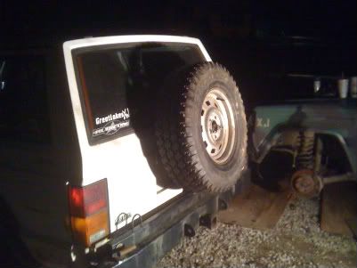

Installed my c4x4 hooks and pick this up on craigslist today:
installed:
I'm probably gonna pull it back off this weekend and recesses to add lights, weld up the ends and repaint it

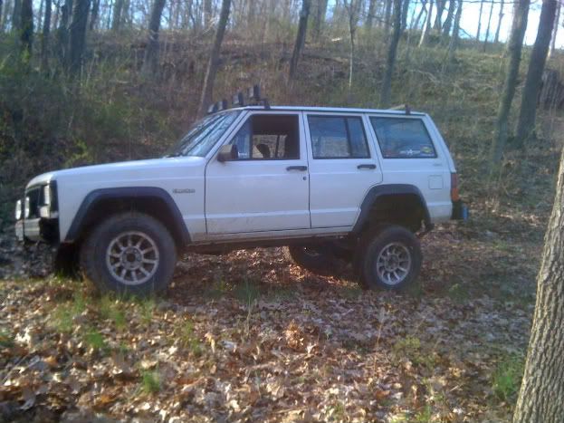

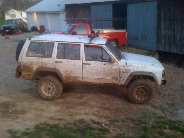

did some wheeling today:
progress halted for a sec

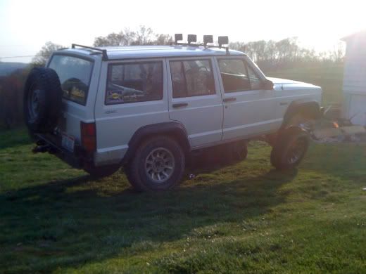

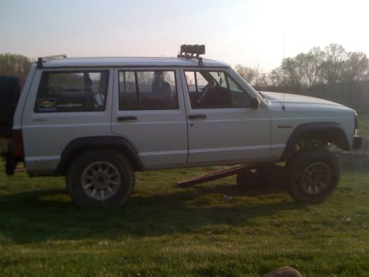

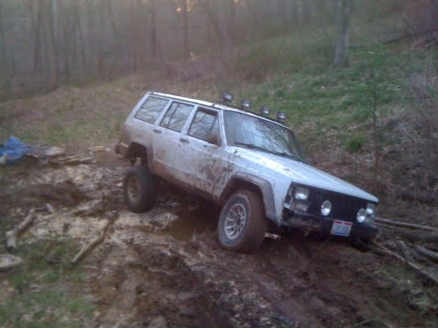

Since i'm gonna be ordering new tires next week hopefully, either 30's or 31's. i stack up some logs while i was doing some yard work. So i took a little break to test the flex and cycle the suspension to see if i needed to adjust anything as far as bumpstops. I extended the rear brake line when i installed the packs so ive got plenty of lieway. i just bent the hardlines up front still have a few more inched of droop left if need be. I need to get new/longer bumpstops in the back so i wont invert the springs. heres few pics.....
still connected:
disco'ed
