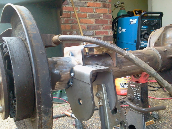

Making progress, ground off the old brackets:
Im using different coil buckets than what came in the kit from ballistic. also, i will be going with a custom track bar bracket.
you can see i had to cut the coil bucket to fit with the LCA bracket
brackets are mocked up, im going to loosely bolt it in without the springs to verify everything is where it should be, then it will be time for final welding

Great build man! When you added the brackets to the 8.8, did you just pull the 35 to compare and pull dimensions off of while you work? My brother-in-law wants to install an 8.8 but was curious if we could do it with out the artec truss.
Thanks! I bought my brackets from Ballistic...they dont come with any directions. You got it, i am just measuring off of the stock dana 35. It will look a bit different, as the diff is not centered on the 8.8...it sits over to one side a few inches more. No real need for the artec truss IMO, just weld the tubes to the center, to prevent them from spinning.

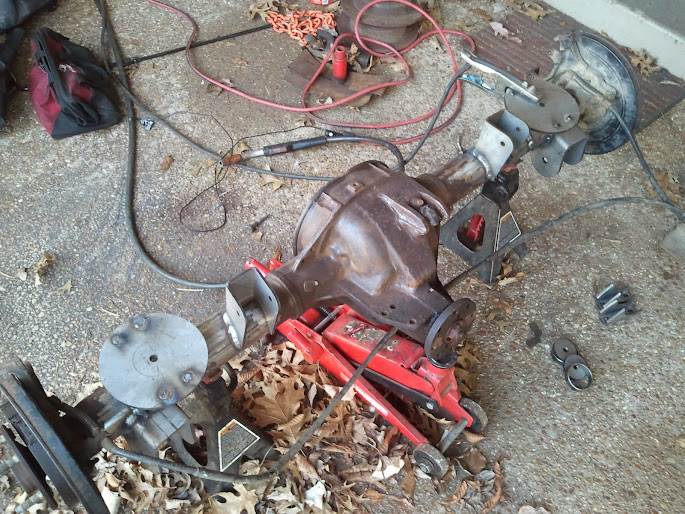

Pretty much all the welding is done on the 8.8:
Here you can see the coil buckets, these are different than what Ballistic includes in their kit:
Welds came out ok:

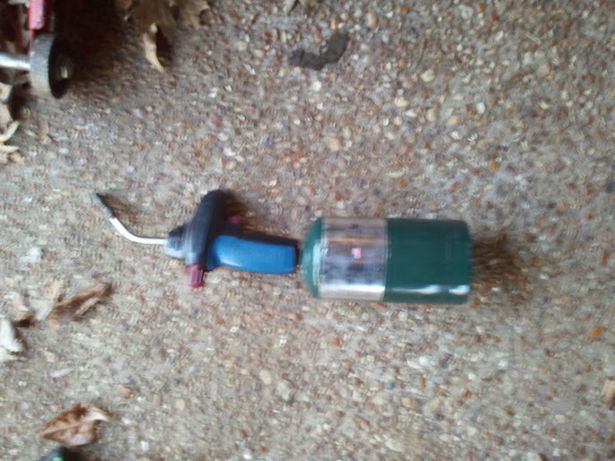

went ahead and welded the tubes to the center...used my handy torch to heat up the casting:
cleaned them real well:
then started doing 2 inch sections, on one side then the other, so i wouldnt warp the housing:
I would weld a bit, heat a bit, and repeat:
Then when i was done, i wrapped it up with some old shirts...just so it would slow the cooling process down, and help prevent cracking of the welds:
