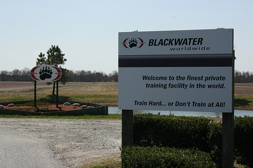

Moyock?
I would Kill to work at/for "the company" in moyock! Holy ****.

Moyock Storage ??

Posts: 716
Academi

Originally Posted by MattGATRTJ View Post
was blackwater, then it was Xe, now it's Academi.

Originally Posted by StillYDGN View Post
haha done! Lets just say i see why shes a STAR
What do they train in at said training facility?
You've never heard of Blackwater?
http://en.wikipedia.org/wiki/Academi
"Private Security Contractors" aka, mercenaries.

The money is hella good depending on what you get into.. One position pays ~$650/DAY on a 90/30 day rotation to Afghanistan. Do the math. Yeah.
Kodiak,
If you do, it would be beneficial to get into the Teams, MARSOC, SOF, TACP or the like prior to getting in touch with them.
Edit:
Or you know, www.academi.com
(we're hijacking the **** out of this thread.... )
