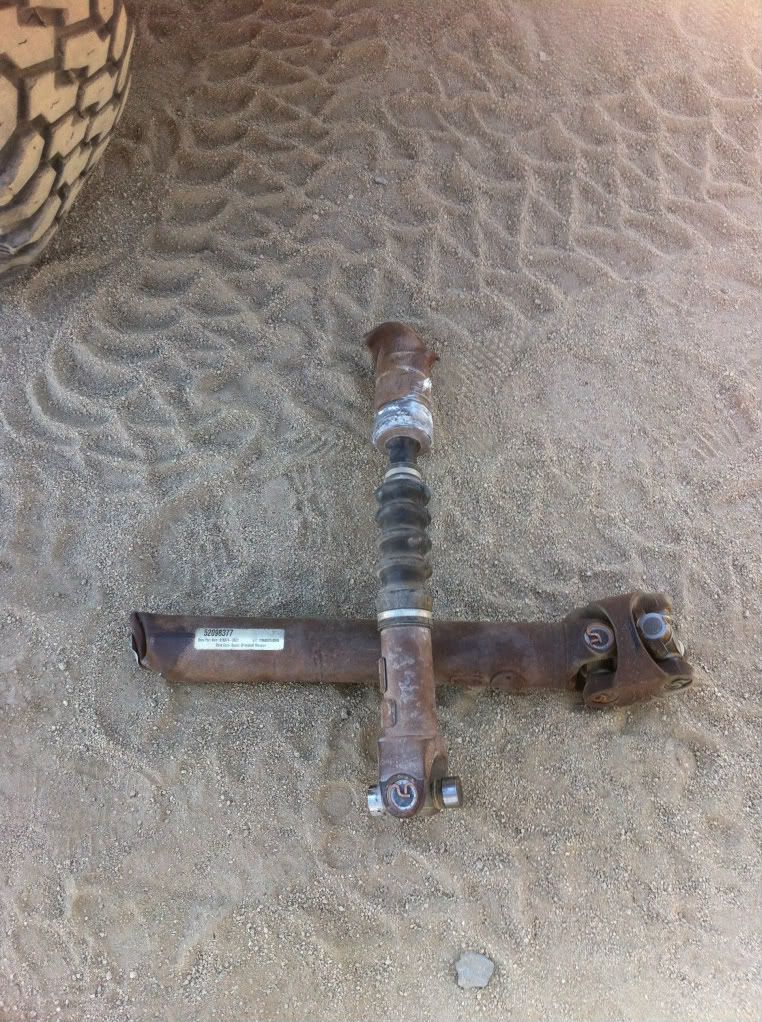

Pictured: Which is NOT where a driveshaft is supposed to be at any point in time.
I'm still just totally befuddled by how quickly that cap came off. I literally tapped the yoke with a small hammer and the joint popped loose, and as soon as it was loose the cap just slid sideways and aimed itself straight for the floor. Thanks, gravity. I could understand this a bit easier if the cap had been pointing straight downwards, but it was facing horizontally to prevent exactly what ended up happening, anyway; I didn't even had time to grab the roll of tape I had sitting at hand, ready to wrap the joint and hold the caps in place. Now, I've started wondering whether or not there was something amiss with the joint itself...and although I'm not the world's leading expert on the internals of universal joints I can tell that there are a couple of slight differences between the contents of the two caps shown below.

I'm thinking now would be a good time to try and get some grease in that cv yoke if possible. Angry sparrows are no fun at all!

Agreed... The shaft is already out. Rebuild it and clean up/ grease the centering ball yoke. Then it's one less thing you need to think about. I just went through this myself last week.
Also... not sure if it's because of differences with the rubicon, but on my X all three u-joints were the same. I replaced them all with the greaseable spicer 5-153x as seen in Stu's writeup on the matter.

Looks like the caps are missing the seals too.
