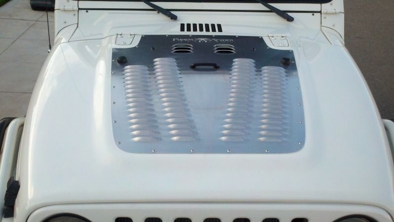

Opinion Request: Best louver panel for the hood?

Poison Spyder. It's on my short list.

I like my poison spider but I got mine when they only had the spider on it, now they have the spider & their company name plastered on it! Lame!

I almost feel useful sharing this, having the same color jeep and everything! I've been VERY happy with the PSC Louver. Very nice install, love the look, no issues with intrusion and the logo you don't even notice. And you literally see the heat escaping.... just a bad *** mod for so little money.

highly recommended for the PSC louver. agree with everything above.
Also take the time to sand and paint every new edge made when the holes are cut for the louvers and the drilled holes for screws. A tedious task i half assed that came to bite me in the *** a few months later.

Hmm...after thinking on the matter, I absolutely do NOT like the logo and wording being cut into it; aside from that it's a beautiful piece of work. Anyone have thoughts on the Hyline Offroad offering?

Ive got the genright 3pc short set on my wish list. I do agree with the other folks that the pac louver looks cool. I just like that the genright doesn't take up as much space.

Ive been debating the same thing. I look (probably to much) at all 3. I love the psc but that damn logo kills it. If aluminum welding wasnt such a ***** to do that much on that thin id just do that but.. ya know. So that leaves hyline or genright. Hyline is my fav but seems a little pricey for a steel piece but does come with a fancy metal template. Decisions..
