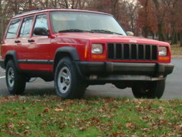

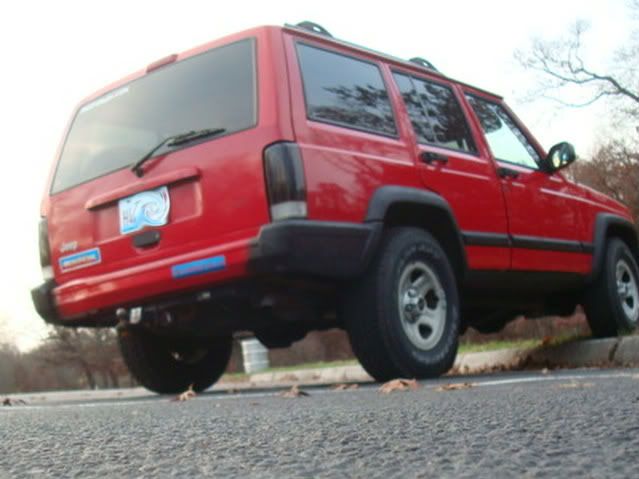

wanted a xj
so i got me a xj.just got home with it.105,xxx miles, 99,aw4,np231,stock.straight 6
http://i699.photobucket.com/albums/v...j/DSC02244.jpg

Good looking Jeep, specs? Year, manual or auto, etc.

nice XJ! I will hopefully have a XJ added to my driveway soon. what are the plans?

Its 99 auto,stock . plan right now is mild lift. its my first jeep/4x4 so not really sure

That's a nice looking XJ. A lift first is a good idea. But are you looking to also get bigger tires too?

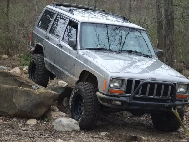

I could easily fit 32"s on my 3" lift with the trimming I've done, and even 33"s if I would bump stop a little.
An RE 4.5" lift and trimming like I've done would easily fit 33"s

nice.like your brushguard

Thanks, it's an OR Fab

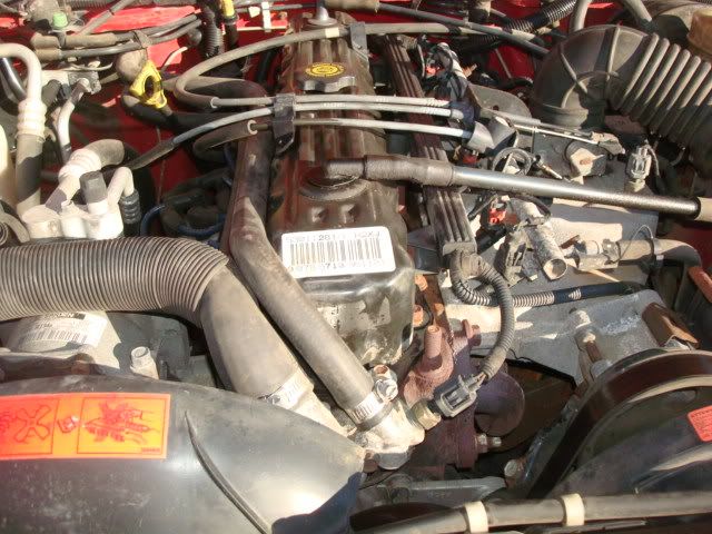

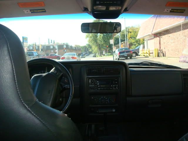

more pics

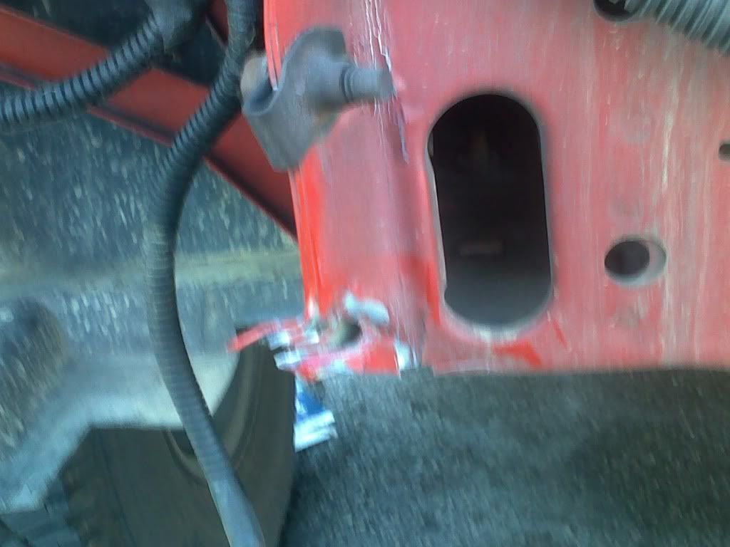

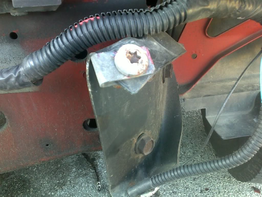

1umf
i had a set back on the jeep build first was lifter collapsed. i been savin for a new engine or rebuild
second is this :
old lady came by fast and too close to me as i was reversing in alley.
What bumper should i go with? how should i stiffen the frame/mounts?
edit: i was thinking stiffer tow hook mounts

You can bend those mounts back flat, trust me.
use a vise to get them as close as you can, then hammer and anvil (or I-beam like me).
I may have heated them a little, but I didn't burn the paint.
Also, you'll need a flat piece of steel - maybe 1/4"? with a hole in it to pull the frame-tube out flat again.
