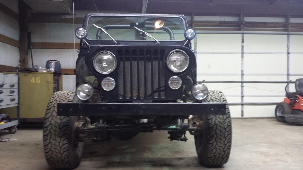

Finally got some time this weekend and stopped playing with the jeep. I knew once I actually started in, that play time would be halted for a while.... So I took her off roading on some of our property and drove her around as much as I could with only low gears.

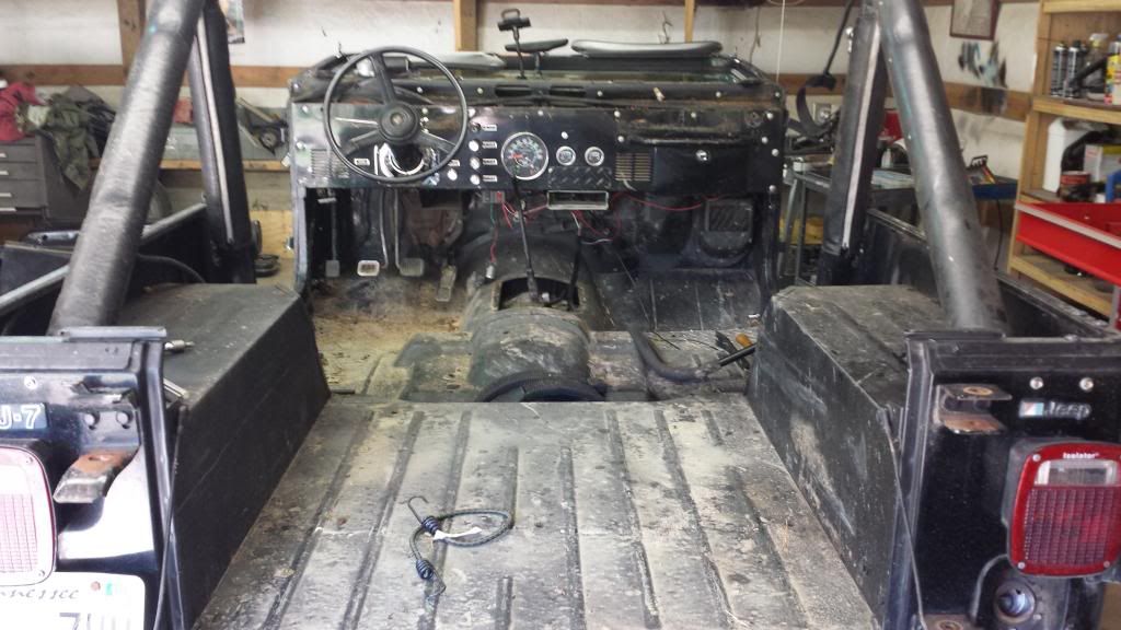

Went ahead and stripped her down to to take a good look at what all will be needed. the frame has no rust, but the body is riddled, so there will be allot of cutting and fabing, sanding and painting.

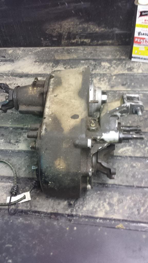

And finally got the culprit out.
It was actually very simple......
Disco'd the speedo cable and some other connection. dropped the drive shafts. Noticed the transmission was not installed right by the PO (more on that later) Pulled the tranny up with some straps through the rafters (working alone, so safety is paramount) dropped the skid plate (which was missing half the bolts). Jacked up the tranny from underneath so I had redundant safety measures. Took the 5 bolts out of the Dana 300 and wiggled it right off. Careful not to crush my head and arms cause I'm not really that big of a guy.
So back to the Transmission .....
Only one side had a mount in the back and all the bolts were loose. Teh mount itself was SHOT.
I know deep in my gut that this is one of the reasons my drive train is Effed right now.

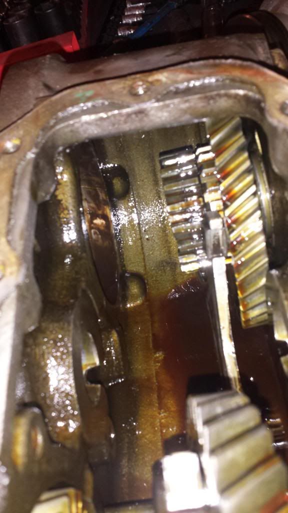

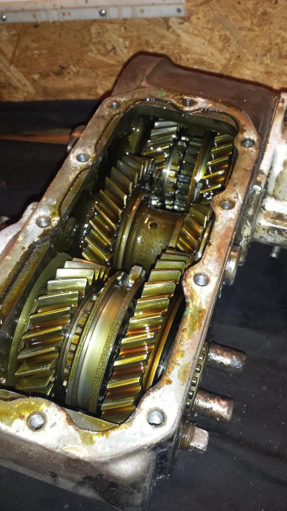

So got most of the TC broke down. Cleaned it up a bit first in the parts washer. It had some GUNK all over it. Mostly oil from 30yrs of abuse. Cracked it open, was able to get most of the bearings and gears out no problem. Knocked the center post out with a hammer, but I'll need a bearing puller for the remainder. After tear down, It's still waiting on parts..... so no rush.
