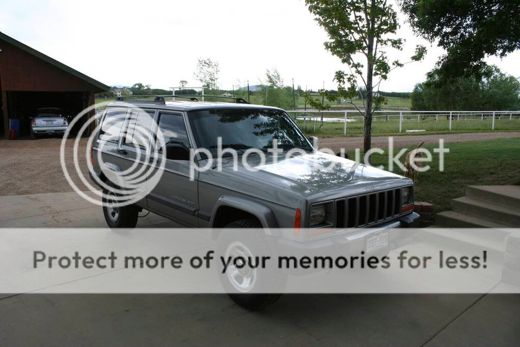

I bought this rolled cherokee when my jeep had a RE 3.5 on it
as you can tell, it was totaled, on road and was pretty messed up
but the rear axle was good, and had all sorts of goodies on it!
I swapped my front LP 30 to a JY HP30 and pulled the 4.56 and ARB outta the trashed jeeps front axle.
The rear 44 was fine, so we swapped that in for my 35... also had ARBs and 4.56s. Has after market shafts and disc brake conversion done.
Transfer case has a 4:1 and SYE in it, swapped from the rolled jeep.
Suspension also came off the jeep, RE 5.5" with drop brackets!
Then I tore stuff off of it and sold it!

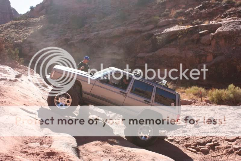

Rolled it like that for awhile, still on 32s. KICKED A$$ that way!
Went to EJS among many other wheeling trips
