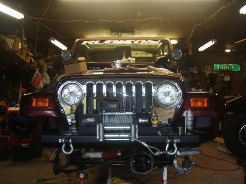

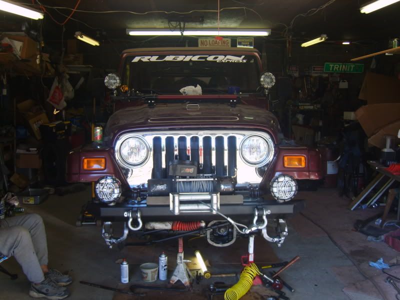

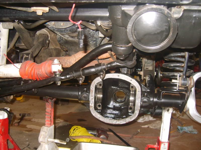

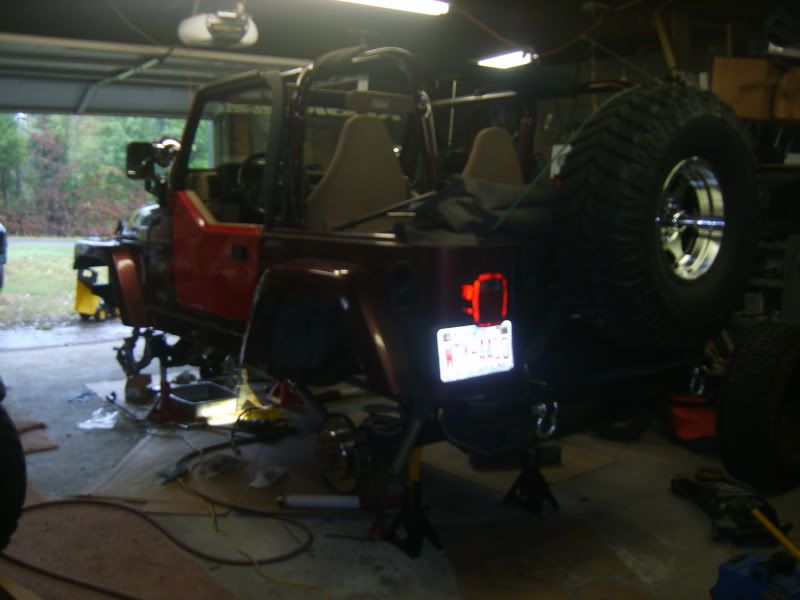

Small update as I am slowly gettin this thing done.
Put it up on jackstands so I can work on it a bit easier.

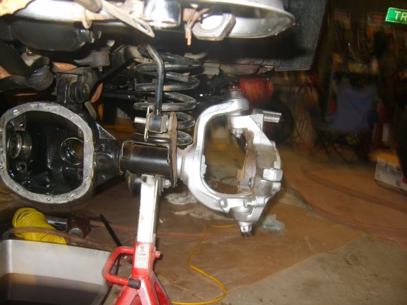

As you can see painted the knuckles silver and painted the axle with the Eastwoods chassis paint as well as the tie rod, drag link and track bar. Still need to paint pass side knuckle silver.
Got the front diff tore down axle shafts out ready to be re geared by one of my Dad's coworkers.
Put the real spare on the back of it
It's flying!

Got the other knuckle painted silver, and did the regear today. What sucked was I didn't know that I needed a 3.73 up carrier for this regear. My TJ came factory 3.07. So in the middle of the regear the guy I had doin it put all shims on one side and then said the carrier was too small. I said oh crap. Well he called a friend who has a bunch of Jeep stuff lyin around and lucky me! He had a carrier out of a 4Cyl Wrangler with 4.10s on it already. So we went and got the carrier and threw my new ring on it, shimmed it up and it is perfect now!

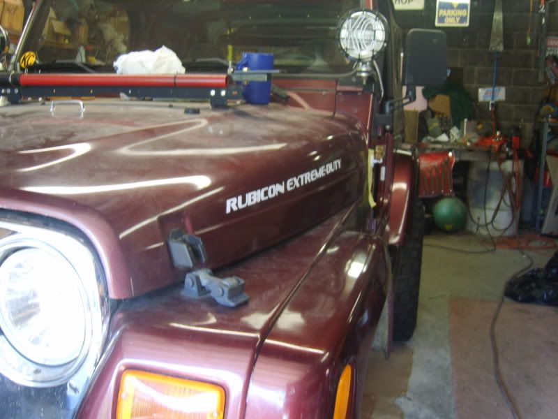

Put the Rubicon Express stickers down the hood

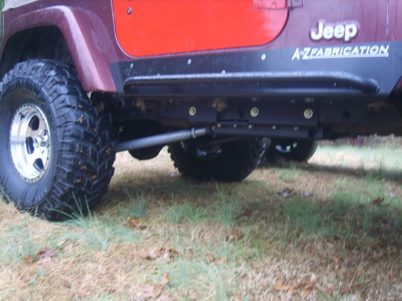

Got the AtoZ sliders on

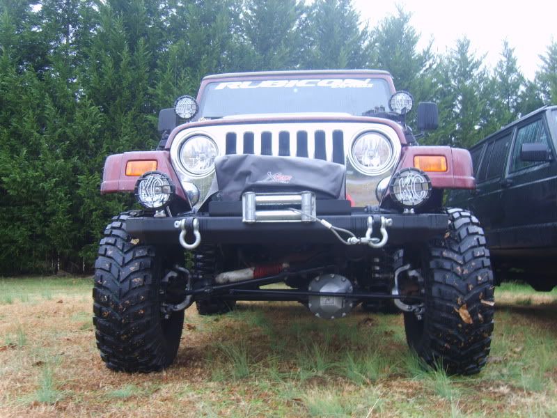

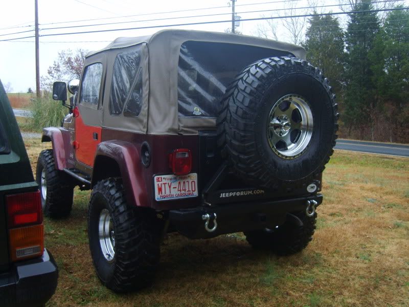

Well she is done (for now) i drove her round yesterday. Speedometer is inop but who cares Here is some pitchers for you to to:
I needs another Nightcrew sticker to go opposite of the JF sticker...
See the Riddler? And I painted the knuckles silver just because
Side shot. I am tryin somethin at the moment. Long Arm rear and Short arm front. This thing doesn't ride like a Jeep anymore, its actually quite comfy

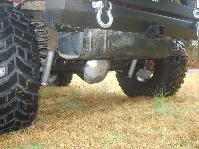

Rear Riddler
AtoZ Slider
Like how I did the antenna?
Stay tuned for some wheelin' pics.

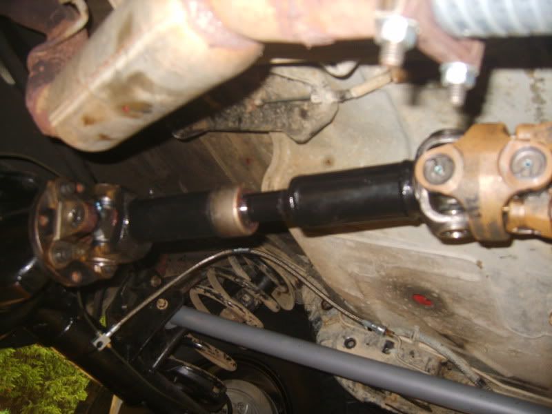

Oh and my new driveshaft
$300 from Fleet Pride
