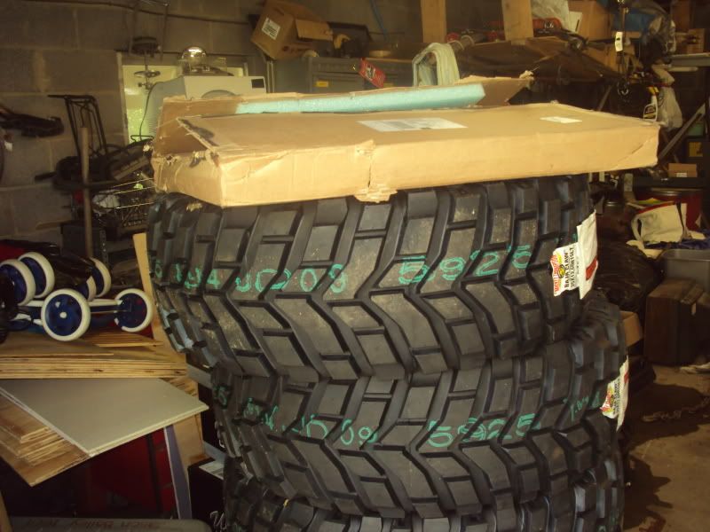

So at last I have some pics of what my new wheels looks like
And for good measure the Claws
Well looks like I'm gonna be busy come September.

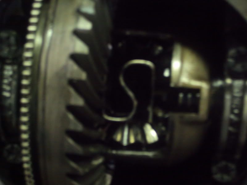

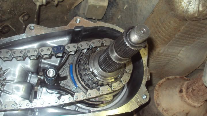

So some pics of the 8.8. And yep opening the diff cover reveals it is a LSD
Anybody see anything wrong? I don't know too much bout diffs. I do know I need to put Ford LSD additive in there.
The heck is that? V Looks like a flywheel but duh I know there ain't one in a diff.

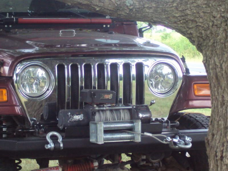

Got the winch and chrome grille put back on. Need to get those KCs back on the front now.

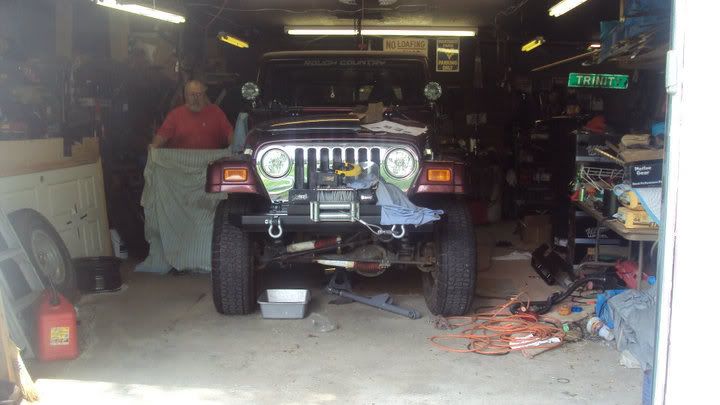

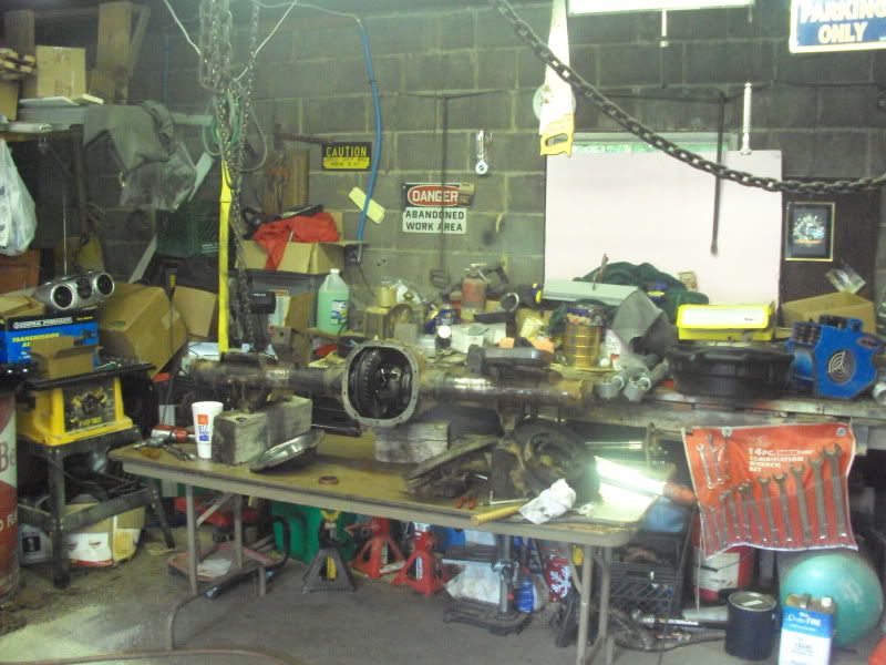

So lets get some updates goin. All credit goes to my Dad. He is bored and there are parts stacked up in boxes in the garage. He is retired with nothing to do. Here goes.
The garage he is workin out of:

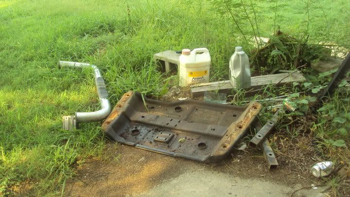

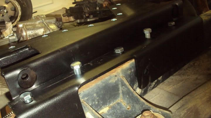

So far he has gotten the skid plate started for the RE Long Arm to go under it. Old one out and free to a good home. It has only been leaked on once. Oh and you see the chrome steps? Free to a good home as well. And yea that little square tubing is a TC skid plate drop. Free as well
New skid being started.

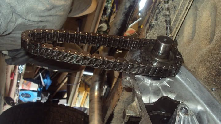

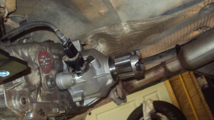

SYE time!
Done with that

Referring to the pic of it sitting in the garage in the last post: Unless your tires are turned a good bit, it looks like you need an adj trackbar. That axle looks like it is kicked way over on the driver side yo! May just be the angle of the pic though... Nice work regardless
Apocalypse is offline
post #38 of 58 Old 08-12-2010, 04:58 PM Thread Starter
USAFRecon
Location: Weidenthal
Posts: 1,421
Suggestions on a good adjustable track bar? I wanna fix it but dunno how. Talkin to Mikey he says since my control arms are adjustable no worries with the trackbar but I will be doin this to it soon:

I have heard JKS ones fit well., I would see what is available for your lift height and check the review section of this site. When you mock it up note whether it will clear the front diff cover when the suspension articulates otherwise that could be a bad day on the trail. Another option is to relocate your track bar mount that's on the axle. One particular argument Against adj track bars is that with higher lift heights it is centered while sitting flat but way off center while flexed due to the way an adj track bar works

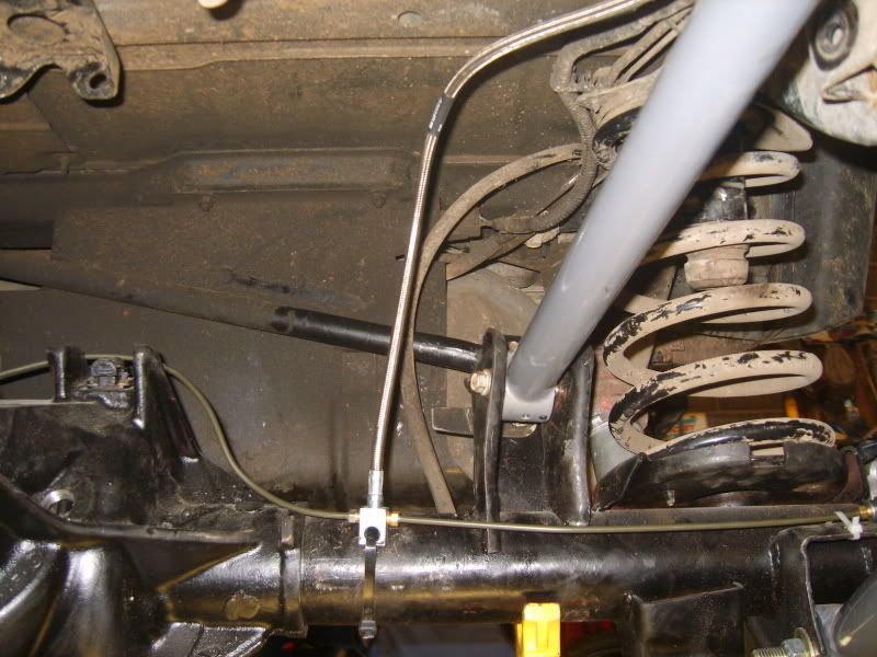

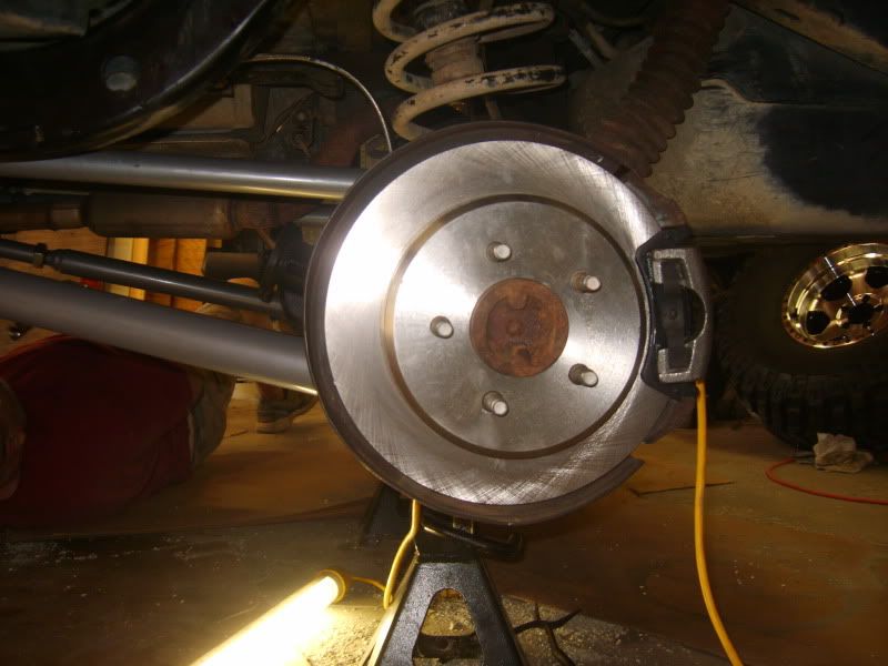

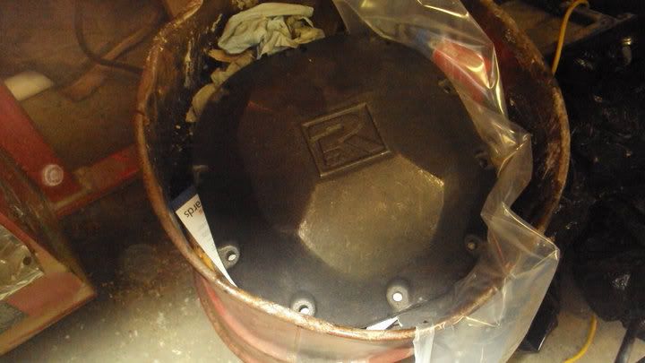

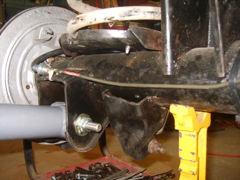

So I have got the 8.8 in, rear long arm done, rear brake lines made from scratch, new discs, calipers and pads, and a Riddler diff cover. Painted the whole axle with Eastwood's chassis paint.
The long arms put in place and dang did that top one on the driver side put me trough hell. The instructions said for the lowers to be at 32 5/8'' and we put em at 33 just to push the axle back a bit. For the uppers it said 33 5/8'' and we put em at 34. Pushed it back a tad.

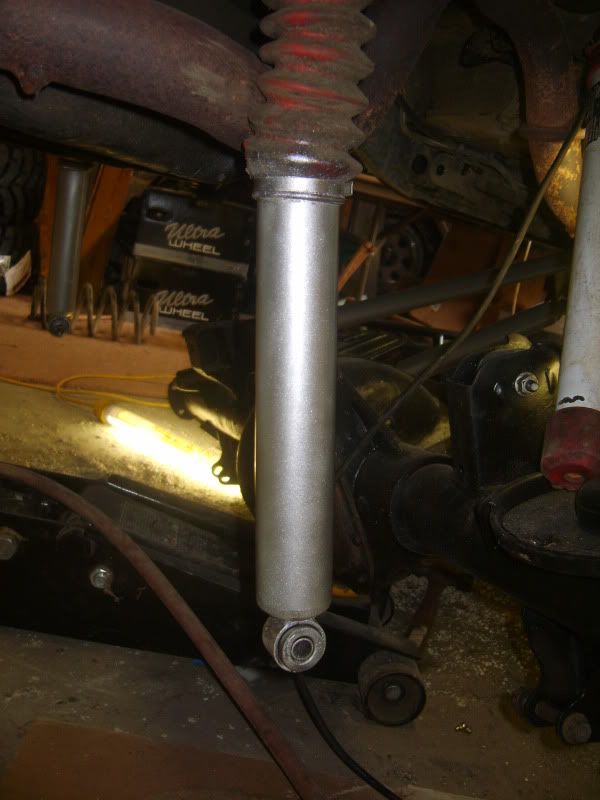

Then I was lookin at my crusty white shocks and decided to painted the shocks silver cause I got way way too much paint for the diff covers.

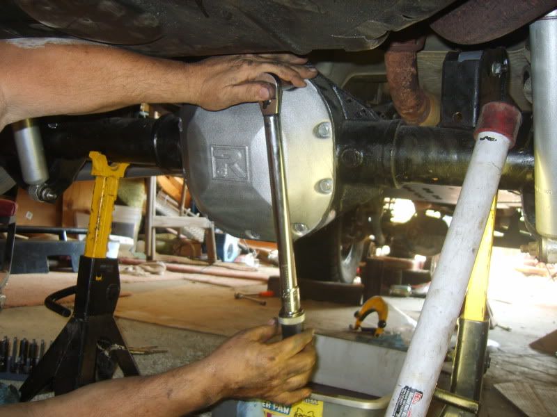

Puttin the Riddler on and torquing the bolts to 20 ft lbs.

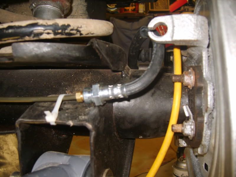

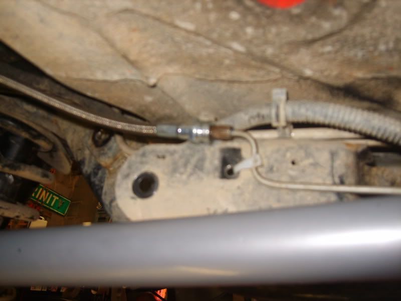

Rear brake lines.. Starts at the hard line from the Jeep into the supplied flex line that has a T on the end of it. From there it goes to either side as a hard line then at the calipers goes to a rubber line where it meets the caliper.
Lookin at the bottom of the tub...
Goes to the axle where it T's off and don't laugh at how they are permanently attached to the axle
The discs on the rear
Tires on it ready for the front to be done! My plans for the rear axle is to find me a Ford Exploder and pull the front CV driveshaft have it shortened to the 20'' from my center line of the SYE yoke to the flat flange of the 8.8 and get this to go on the flat flange: 8.8 1310 Conversion Yoke Kit [2-2-1379] - $39.99 : Mad 4 Wheel Drive

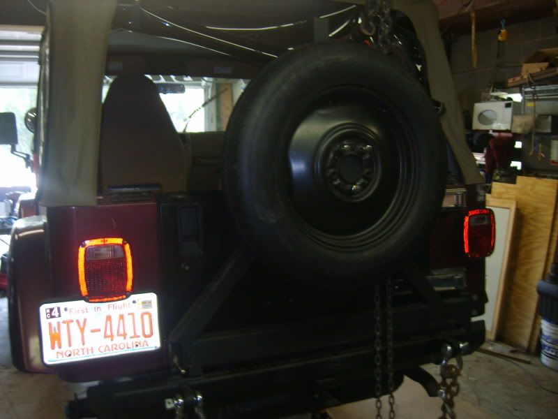

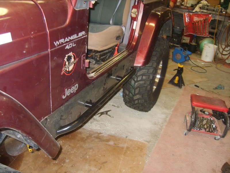

And here you can see the AtoZ rocker mocked up. The tires are hangin out quite a bit even on Sahara flares And that tire is sittin real pretty nice and centered in the wheel well
Like the spare?

Call me crazy, but I dont think that doughnut for a spare will get you home...Just an observation though, it gave me a slight chuckle when I seen it.
TehWicked is offline
post #45 of 58 Old 09-25-2010, 10:57 PM Thread Starter
USAFRecon
Posts: 1,421
Nah I put a fullsized spare back there I just did that for grins
