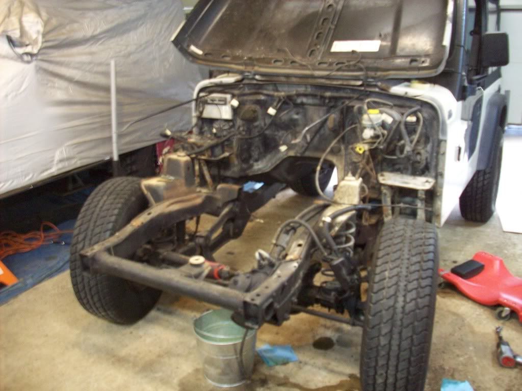

It's out!

Yeah buddy! What are you doing with that old radiator? And are 4.0/2.5 rads interchangeable?
--chris-- is offline
Parts book shows 5 different part numbers for the radiator, BUT the first one listed is copper/brass and checks with both engines, so I guess it would work with both.
I'm going to try to sell it, along with anything else I can salvage.

It's yours if you want it. Some of the fins have come loose, but the coolant was clean when I drained it.

Did it leak? The new heeps radiator leaks somewhere, had a baseball sized puddle after sitting my barn for a few hours.

Nope, no leaks. The drain cock is broken, if you care, but I was able to open it with some tiny vise grips.
