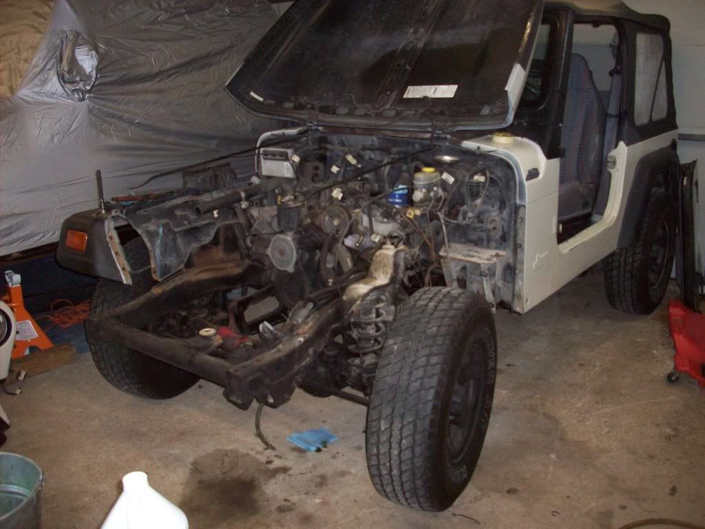

I'm not looking forward to the wiring, which pretty much brings me to the point that I am at right now. I have the wiring harnesses freed and the grille and fenders removed from the Jeep. All that needs to happen is undo the fuel line and starter wire and I should be able to pull the 4 cylinder.

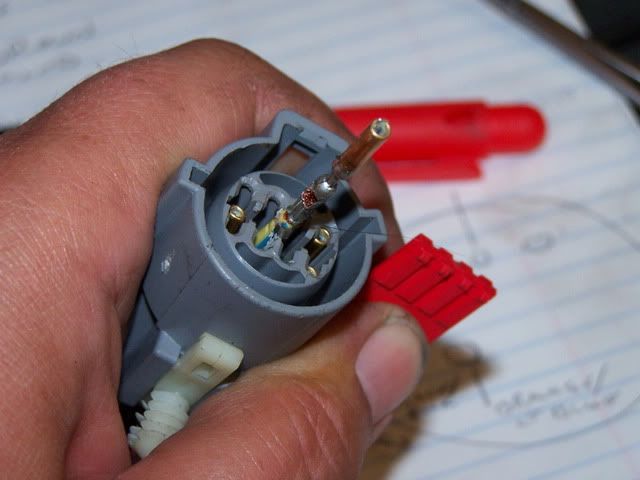

I spent a lot of time cutting and soldering and used marine grade heatshrink. And a little time re-pinning a few connectors.
This was before I wrapped this section OE style. Pain in the butt. But the truck started with the first twist of the key. So it was worth it all.
I wish you luck! Patience and document!

What did you use to de-pin the harnesses? I have hook tools and tiny screwdrivers that I've used for getting pins out out of harnesses on the rare occasion that I've needed to, but wonder if there's something better to use for a project of this scale.
Pretty much what I used. I'm sure there are better tools for that, but I can't afford them. Just remember to take a break when you can't tell the colors apart anymore.
