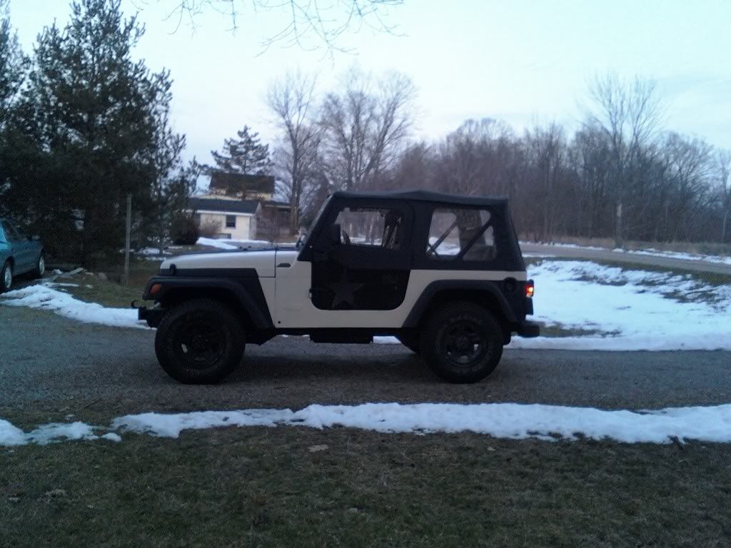

post #388 of 746 Old 02-14-2013, 02:08 PM Thread Starter
Jason
Location: North Port
Posts: 6,566
Crappy pic because it was getting dark, but it's sitting pretty level now.
We're men! We don't need no stinkin directions!
Jason is offline
post #389 of 746 Old 02-14-2013, 02:36 PM
Rubicon0311
Location: Kalamazoo
Posts: 3,341
It's like a sleeper TJ....awesome

post #390 of 746 Old 02-14-2013, 02:38 PM Thread Starter
Jason
Posts: 6,566
I know, right? Looks kinda, well, ugly. It sure does get some looks when I start it.
It needs a cam now. Lol.
