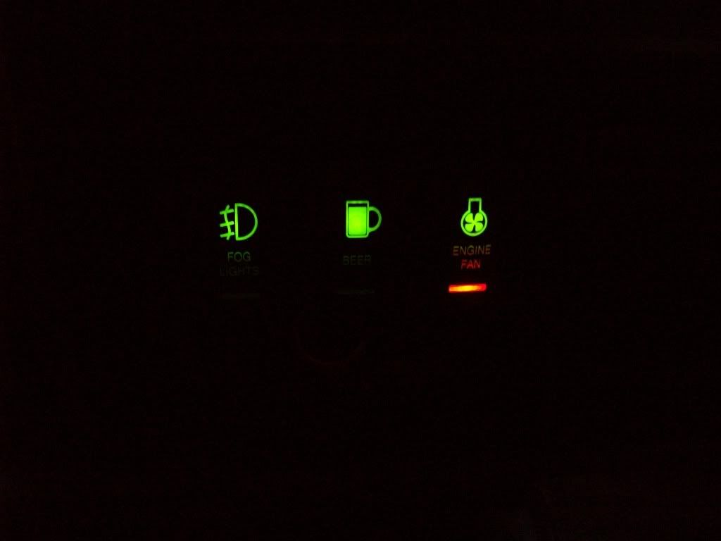

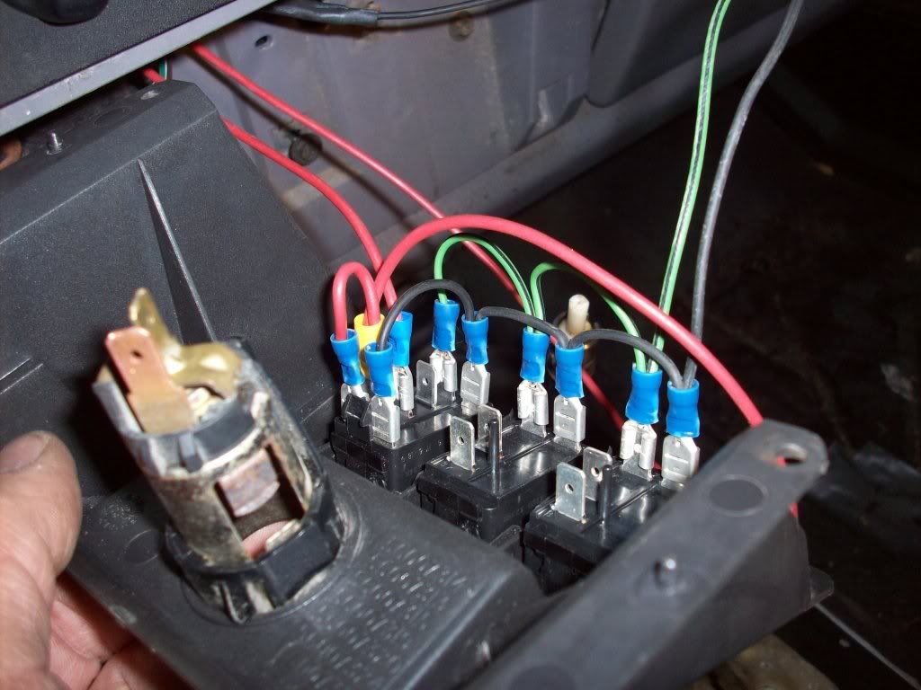

I got my switches wired up.
The fan switch turns the fan on and off, the other two just light up for now. I got the top part of each switch with the icons to light up with the dash illumination. They dim with the interior lights too.
I got the center mini-console bolted down, along with the shifter and the gear indicator. I found an extra bulb under the dash, so I pushed it into the gear indicator, so that lights up too.

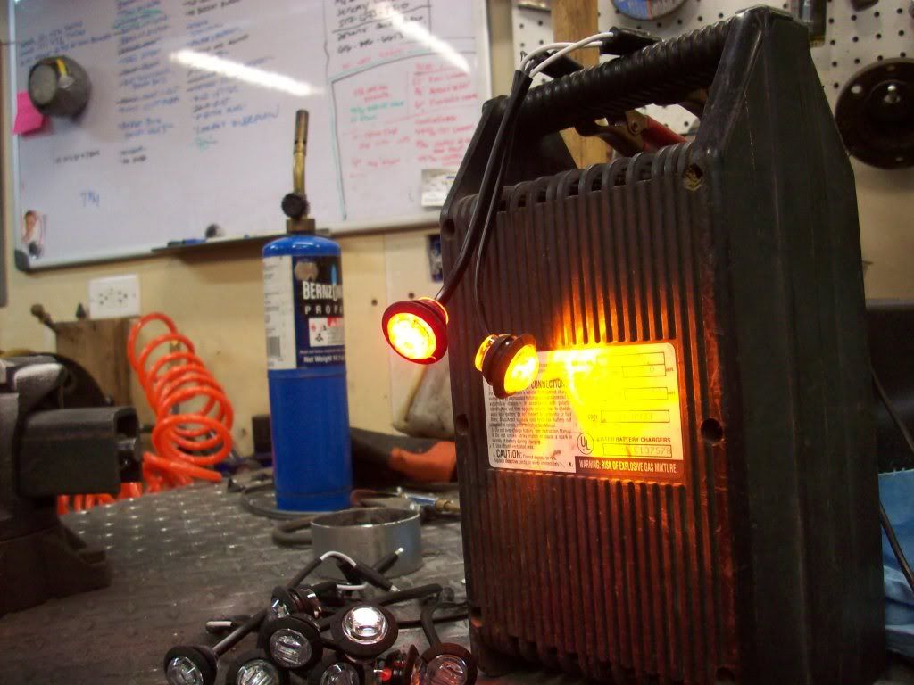

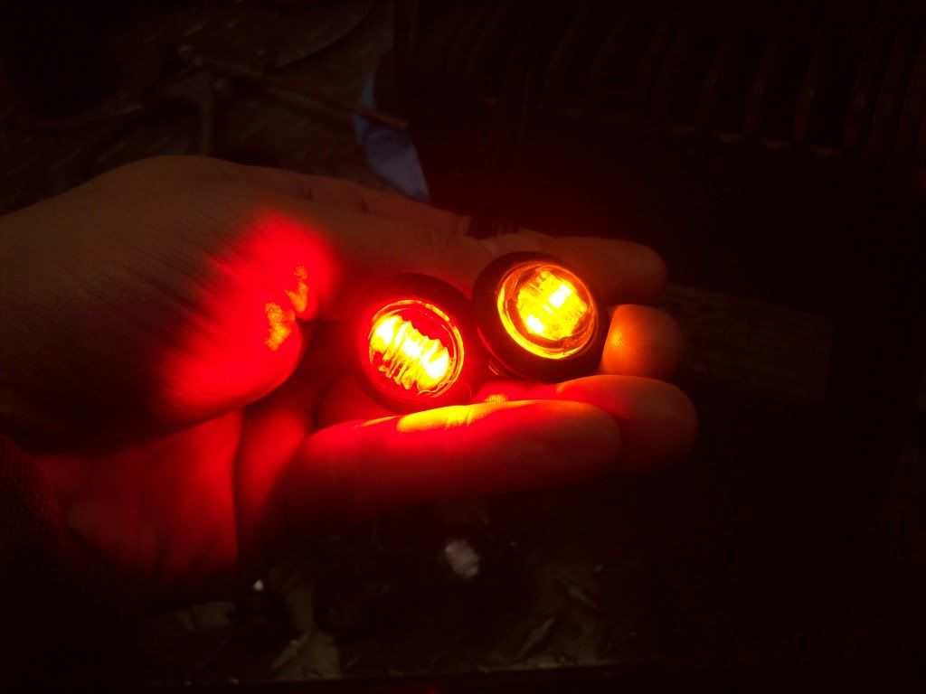

I'm also terribly addicted to LED lights. I got 3/4" red and amber with clear lenses, 5 each, to serve as marker lights in the rear and turn/marker in the front. Figure I'll use 2 in the rear for side markers and 4 in the front for forward turn signals and side markers. My camera blows when it comes to picking up bright lights, but trust me when I say these dudes are bright.
I need to get some reverse lights and a license plate light that doesn't stick out too much.
