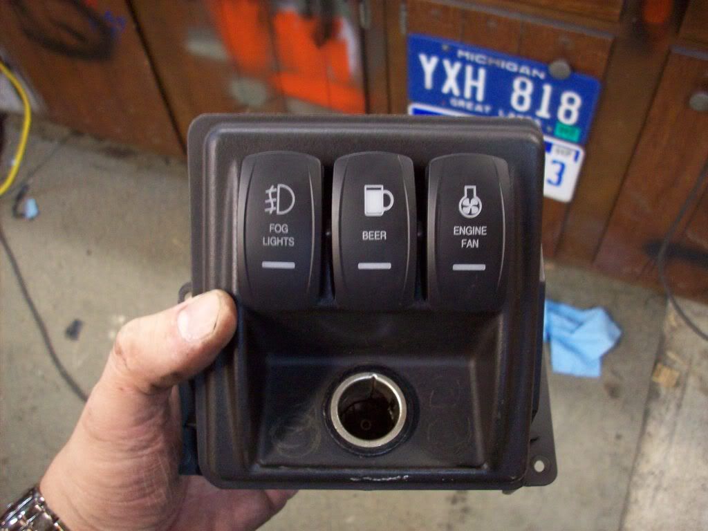

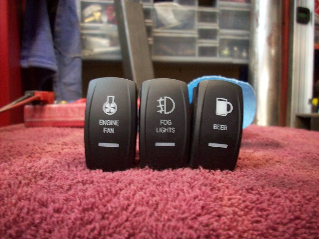

Got my switches today too.

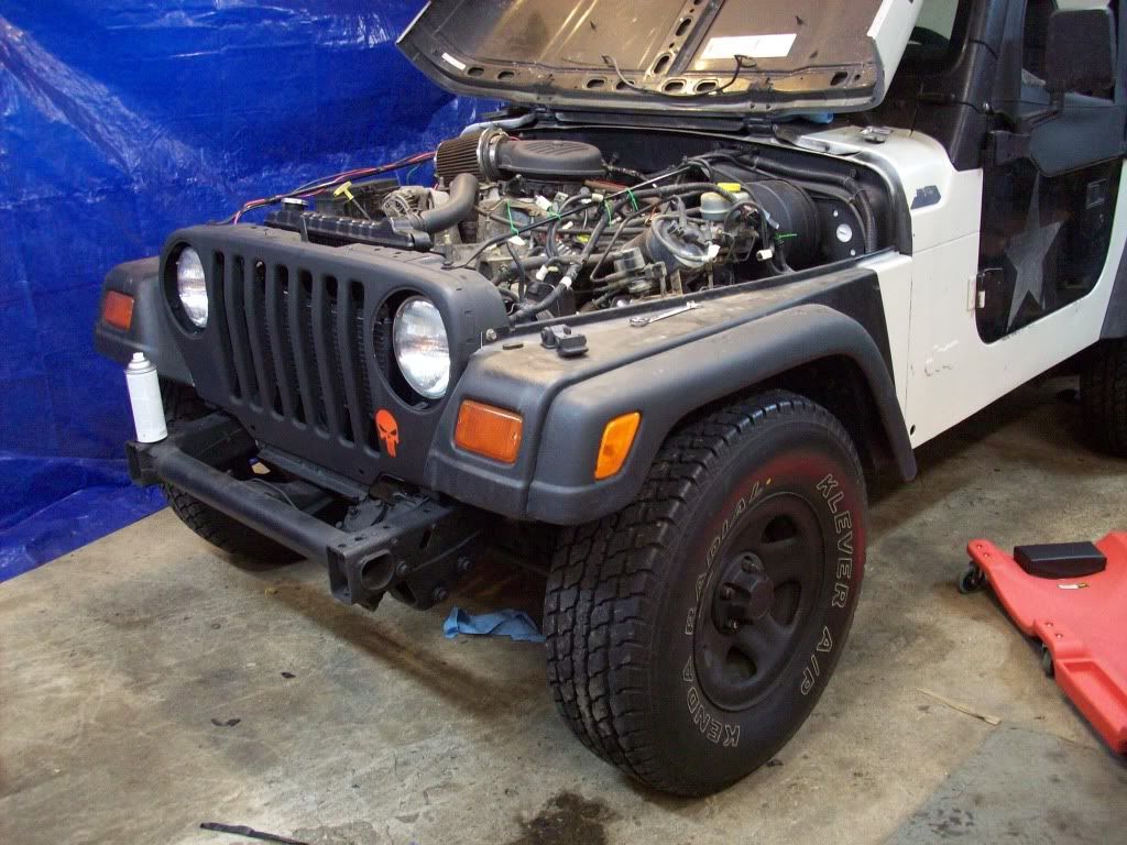

I strapped the power steering lines down to the frame, which was more tramatic than it should have been. At least it's done. I may go back and strap the brake lines down later, but they're pretty stationary right now.
I was worried about the fitment of the switches I ordered. They ended up fitting real well.
I got the fenders mostly put back on. The driver side interfered with the power steering line and the washer pump hit the power steering pump. I was able to tweak the the steel line coming off the back of the PS pump for clearance. Haven't figured out what to do about the washer yet.
