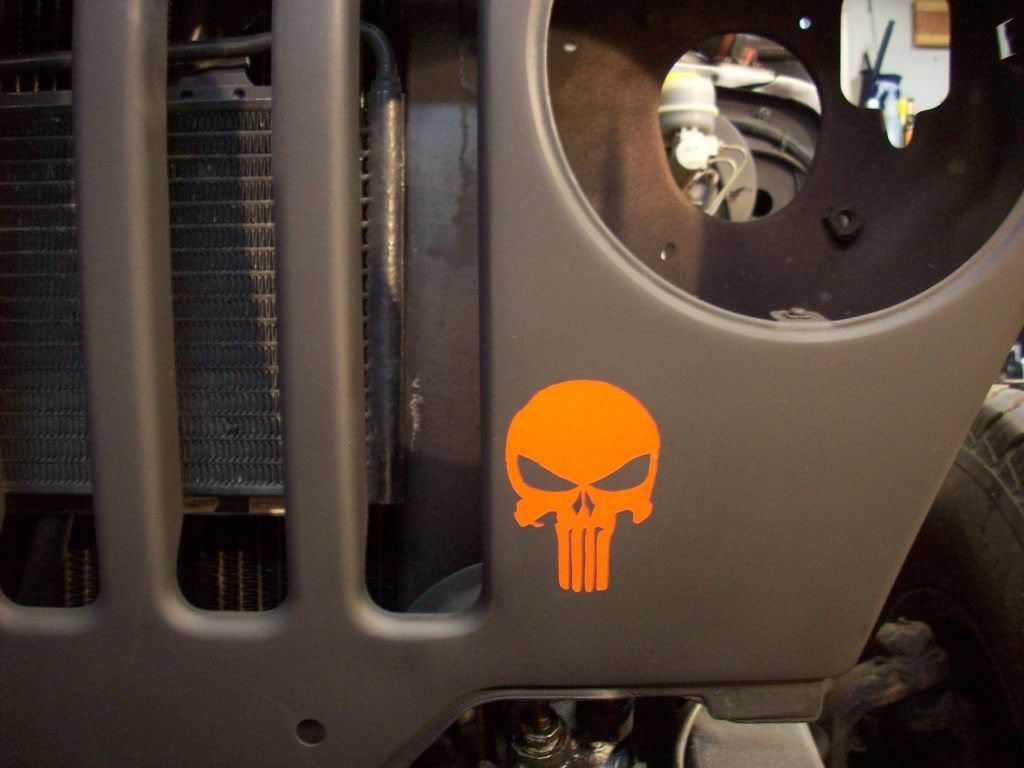

I think you should paint Betty the color in your avatar and accent it with that orange, that would look sweet. Or is that the plan??

That's been the plan all along, but I was keeping it secret. So
That's the orange paint in the pic -- not a decal. Plan is for flat black grill, fenders, rocker and rear corner guards. Tub, hood, windshield frame in orange.

Oh, in your avatar it looks almost like a flat gray, which would also be pretty sweet

Yeah. A gray gray would be cool too. The flat black just looks sinister, so I had to do it.
