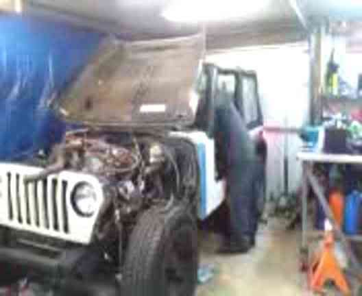

Congrats Video or it didn't happen!
I did take a video, but I look like a cheese ball, so I decline to post it.
Originally Posted by bangintin View Post
Atta boy!!! Great to hear!
Thanks guys. I kept thinking, there's no way this thing is going to start. I couldn't believe it when it turned over.
I think more people will care about the engine running than what you look like!

Ok, I got it. I had to convert it from the weird format my phone uses to something useable. Sorry the quality sucks.
