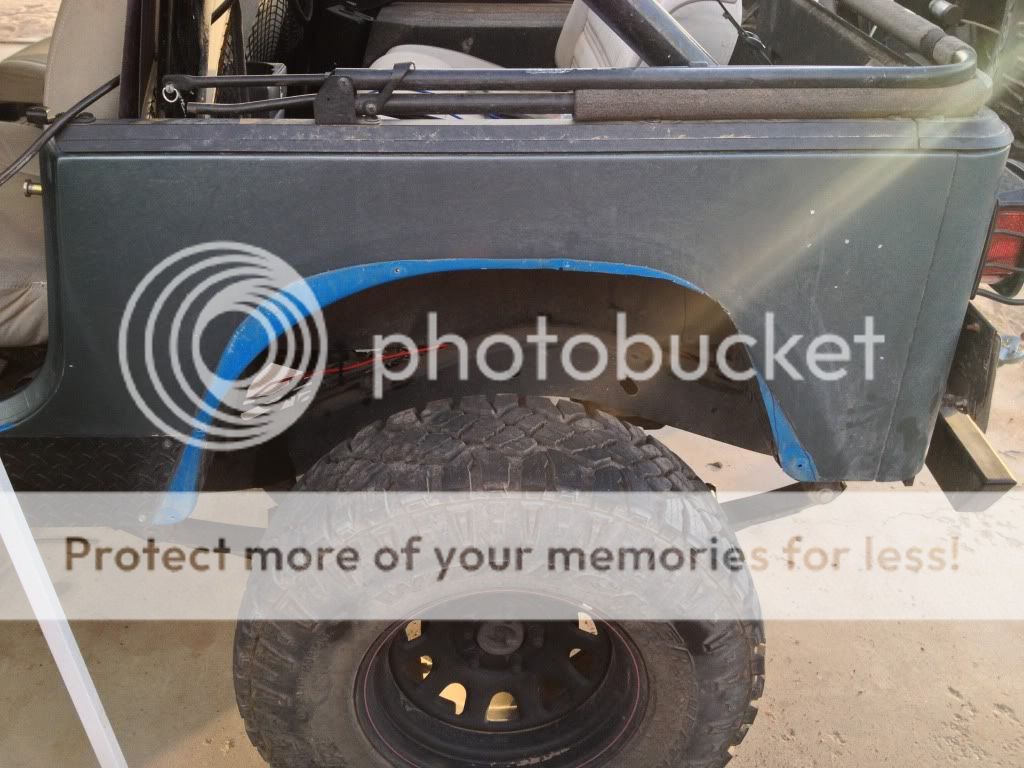

I did a little trim work in preparation for the rear flares while letting her cool off:
The cut follows the inner fender well lining.
