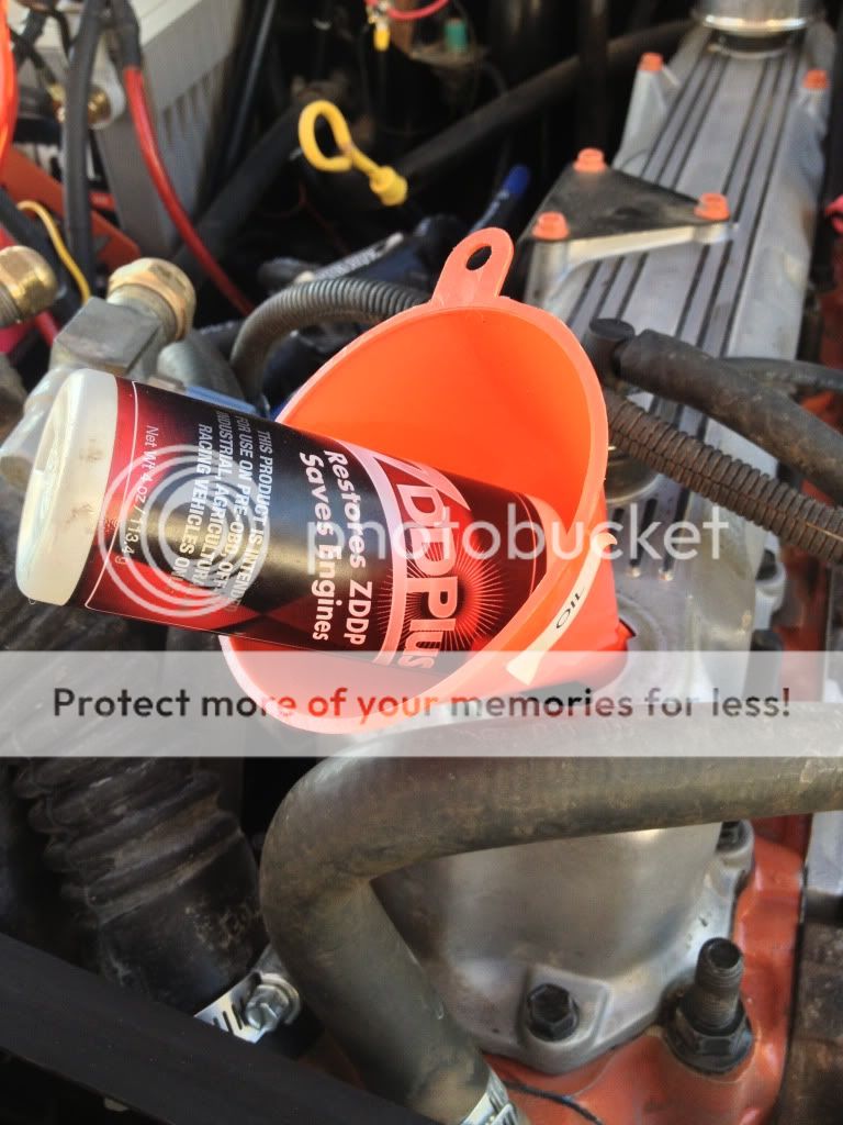

I then filled all the fluids, used valvoline conventional 10w-40 with a bottle of break-in oil and connected up the battery:
She fired up on the third try (adjusted the timing a little each time until it fired). Cam break-in went flawlessly. She did get pretty warm, but that aux fan i run mounted to the radiator kept it below 240* the whole time.

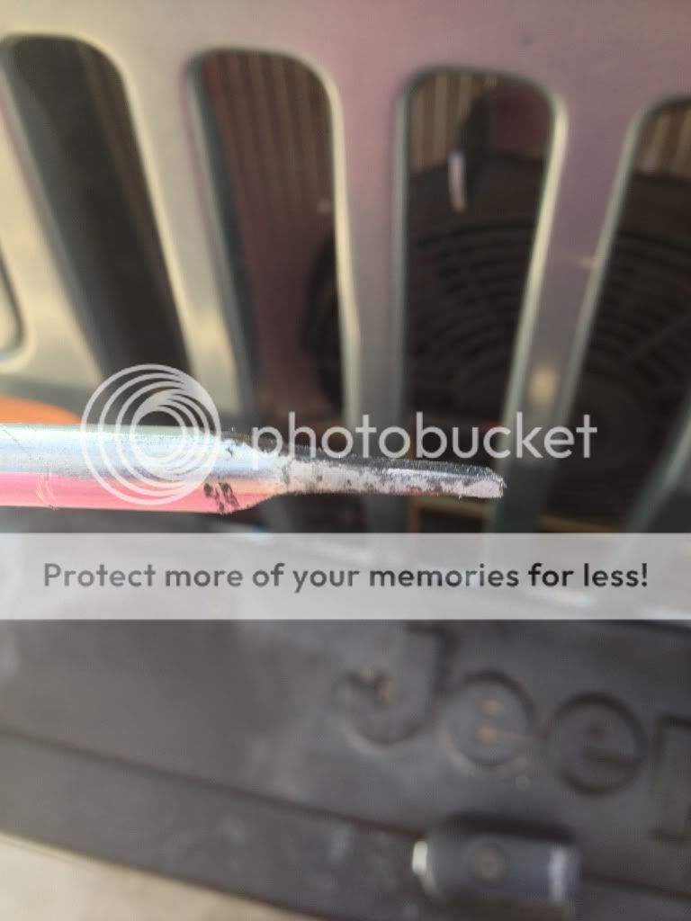

Well, I installed a new harmonic balancer, tuned the timing and the carb, fixed the air cleaner hold down, found the rattling from the trans and took it for a 'shakedown' run. Whew. It's been a few busy, very hot days.

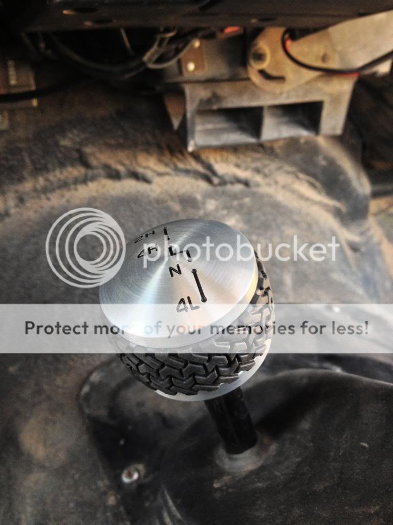

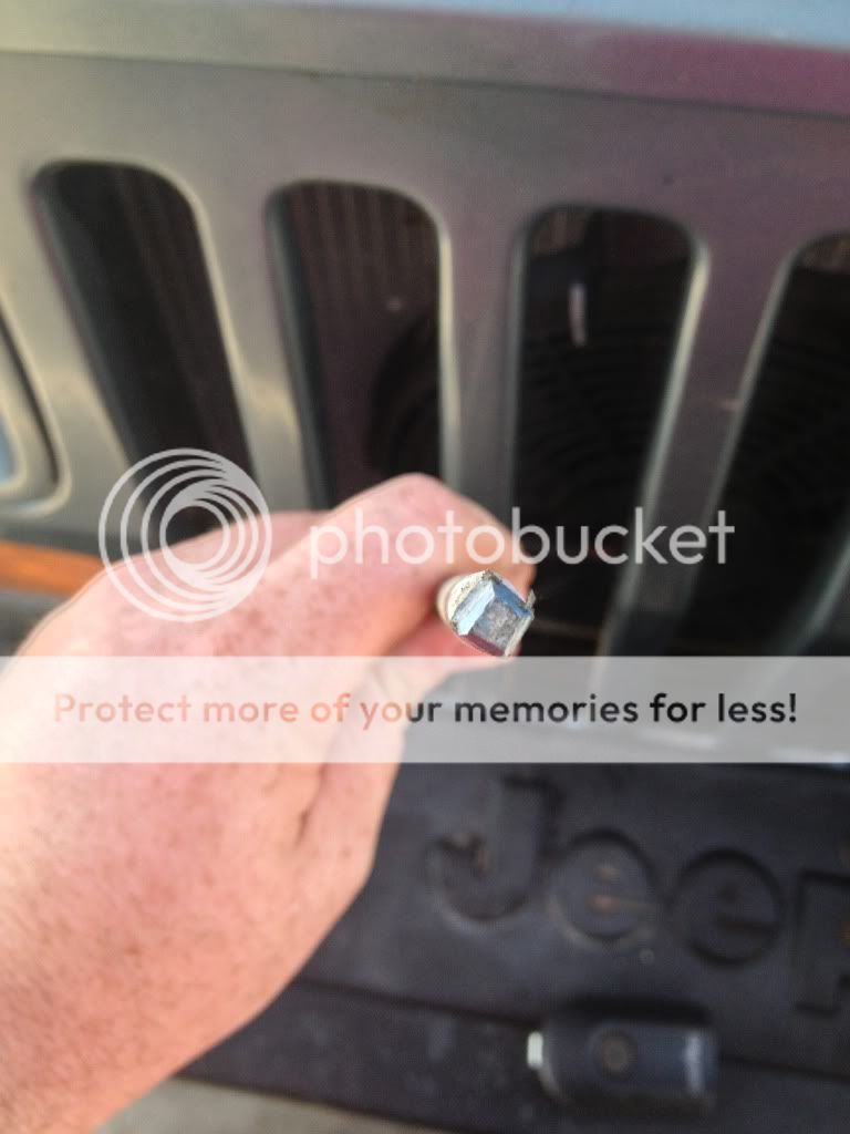

New transfer case shift lever (after i sheared the old one off):
Found the rattle that I swore was loose torque converter bolts:

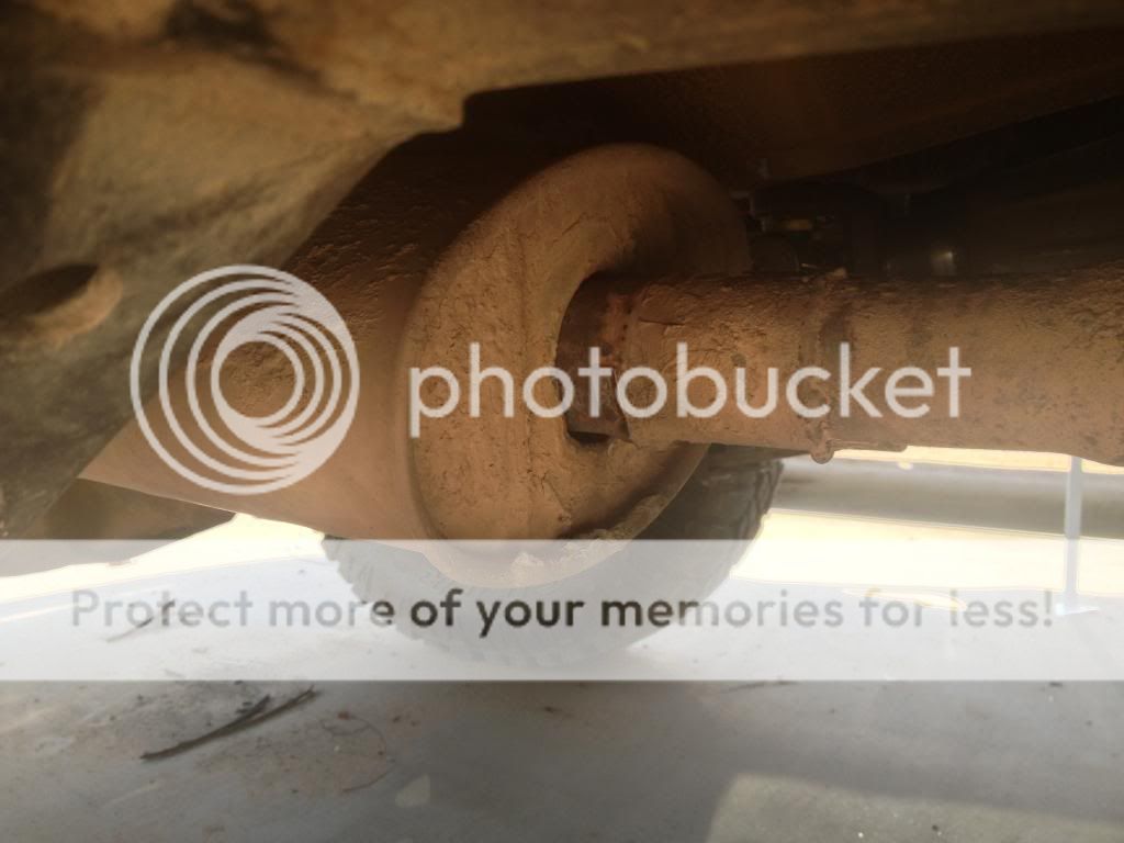

I had a dynomax muffler welded in for $85 at a local exhaust shop. No difference from the stock muffler (aside from no more drone from the massive leak).

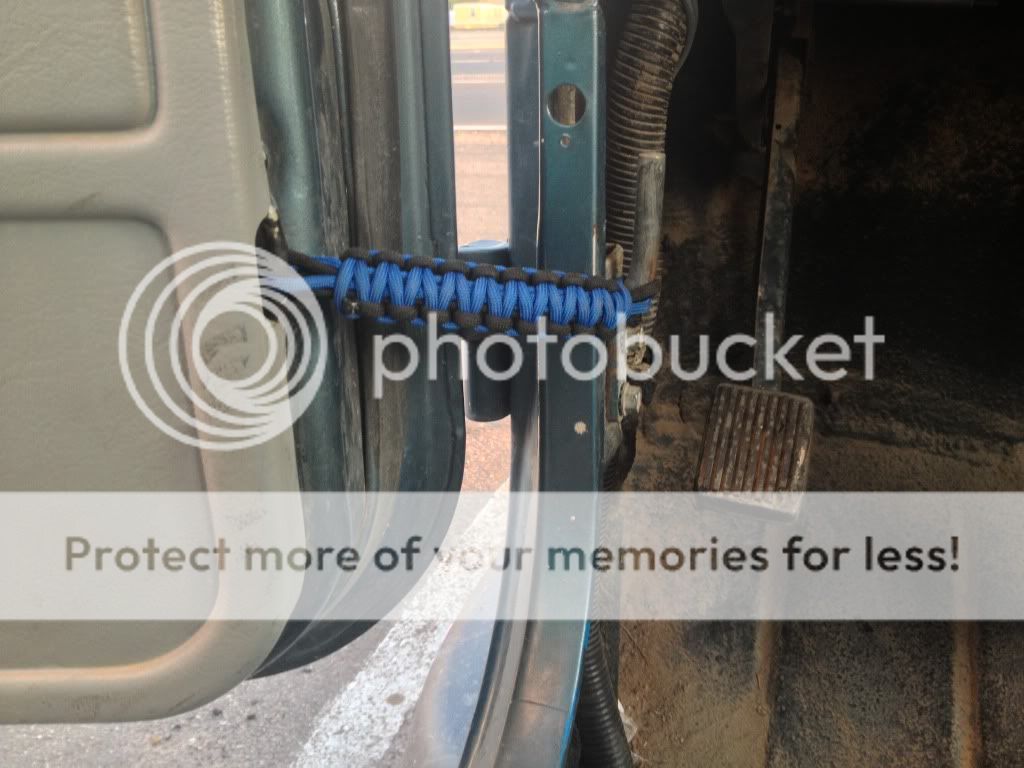

I added some door limiting straps that were made for me:
One of these days I may somehow manage to get pictures of my Jeep wheeling, until then I just have the poser shots I took myself.

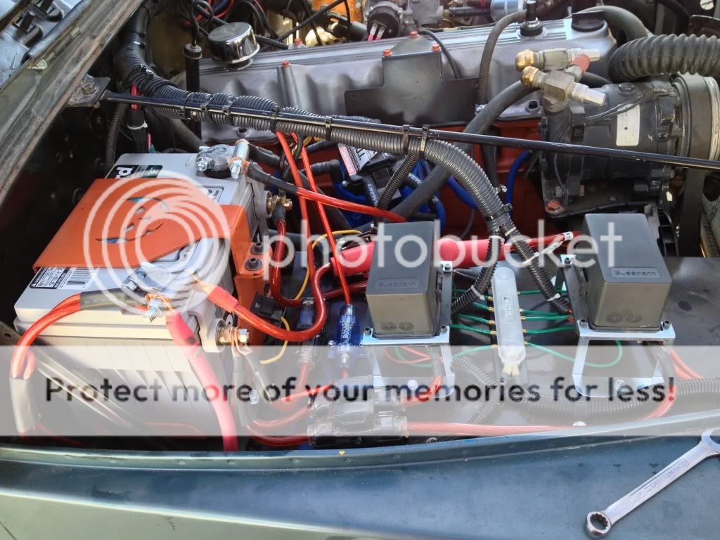

Ok, so the Howell TBI install:

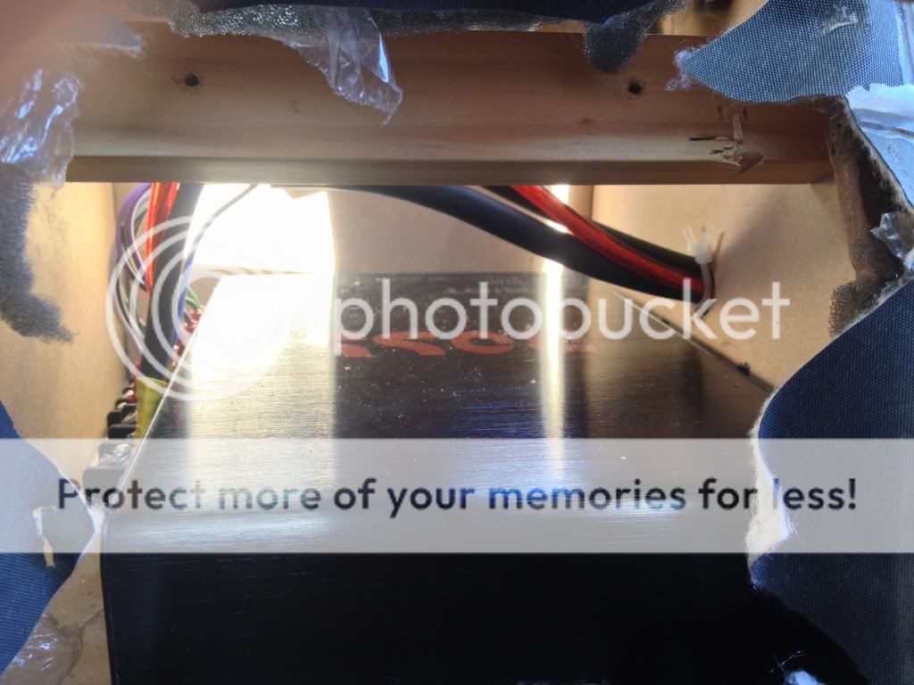

First, I had to relocate the amp which i had behind the glovebox where the computer used to be. The howell wiring harness is specifically designed to mount the computer in this location, so i needed to make room. Initially i went back and forth and tried to find a 'safe' location to mount the amp. I didnt like the option of mounting it under the seats because I drive the Jeep with a bikini top most of the year and this would leave it in harm's way. In the end i decided to modify my center console to mount the amplifier in the unused space under the cupholder.
Once that was resolved the Howell install began in earnest. I'm not about to go into too much detail as there are plenty of write-ups on the installation but I will say that the kit was VERY complete and very well laid out. Every piece of the wiring harness was labeled and easily installed. I had to lengthen a few of the connectors in order to make the wire routing work for me, but the instructions mentioned that this was likely needed regardless.

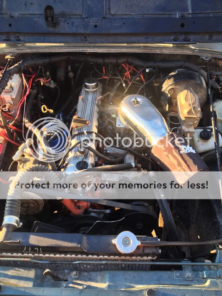

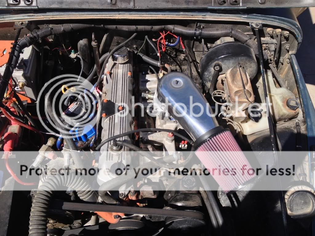

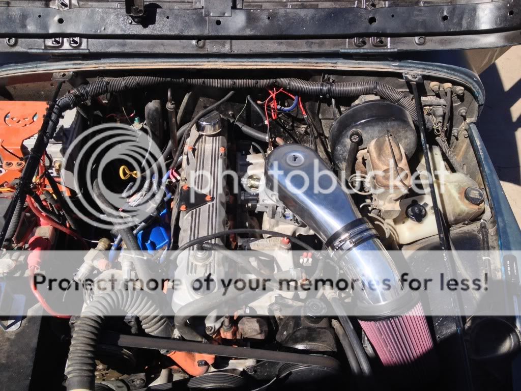

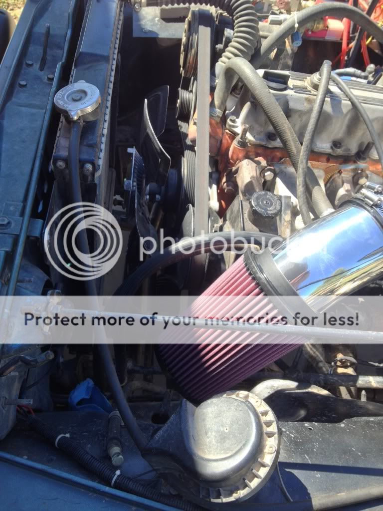

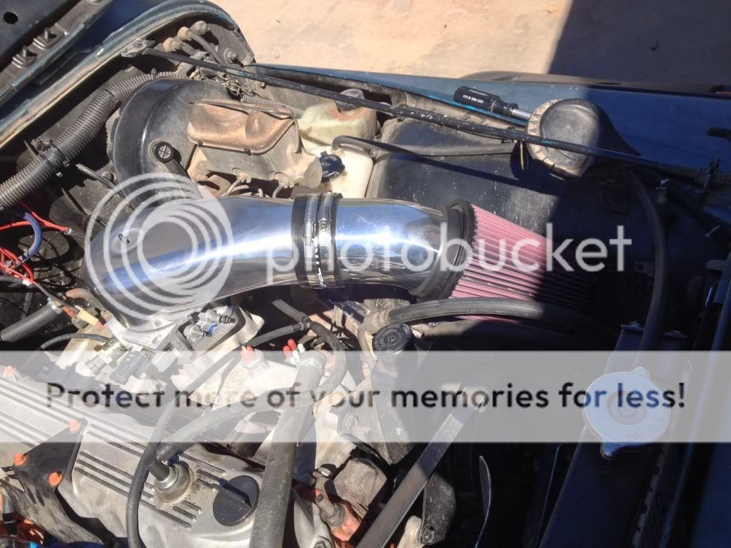

I pieced together an intake off of amazon using a Spectre brand plenum, 22* elbow and a universal 4" diameter filter. The plenum is VERY high quality, well worth the money and much better than the ebay intake i used to have on the carb years ago. I only ran into one problem with it. I initially planned the intake to place the filter as close to the stock air inlet in the side of the grill as possible. After mocking it up I noticed that it would be in the perfect position to allow water thrown off of the mechanical fan to hit the filter directly.

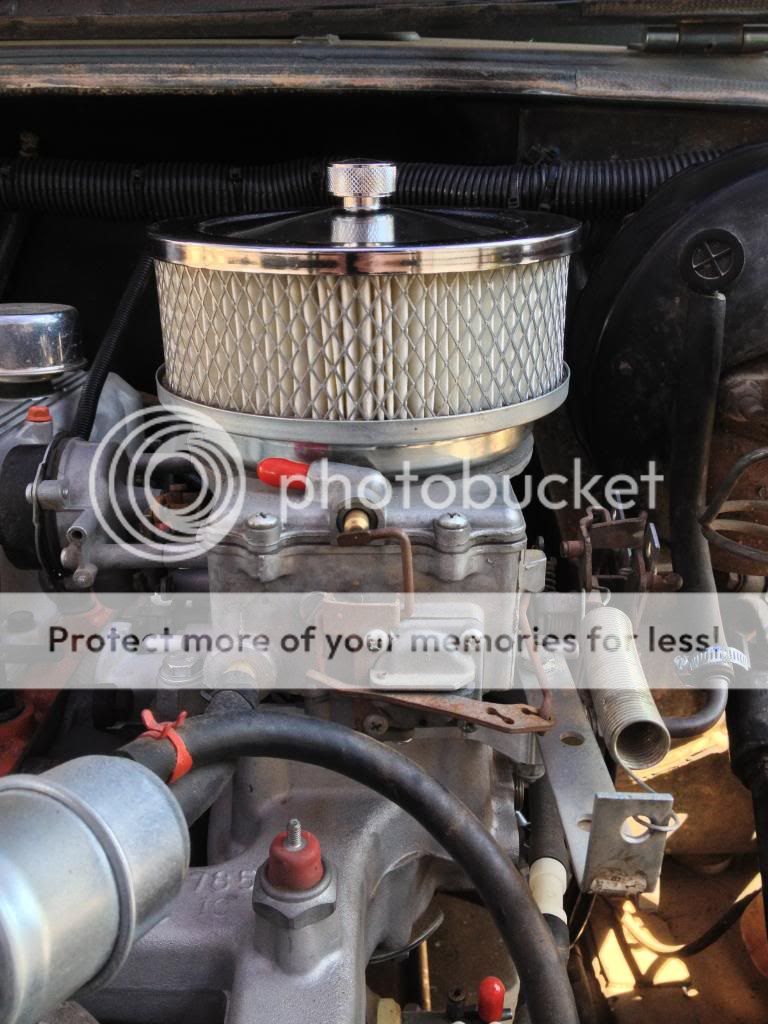

So, for the time being I'm running just the plenum and the filter directly on the end of the plenum like so:
I cant say enough about how much the kit improved the performance of my Jeep. It's running great now and has eliminated many of my complaints. It's also provided a noticeable boost in power.
