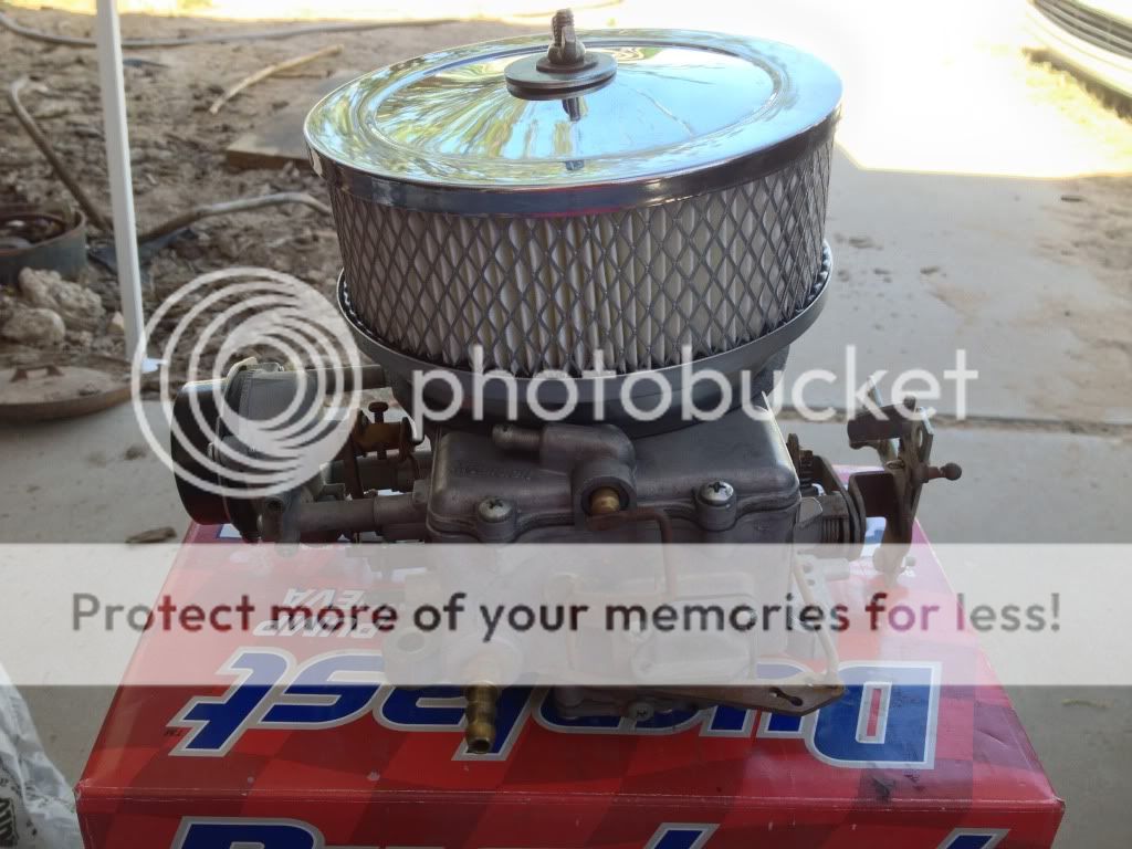

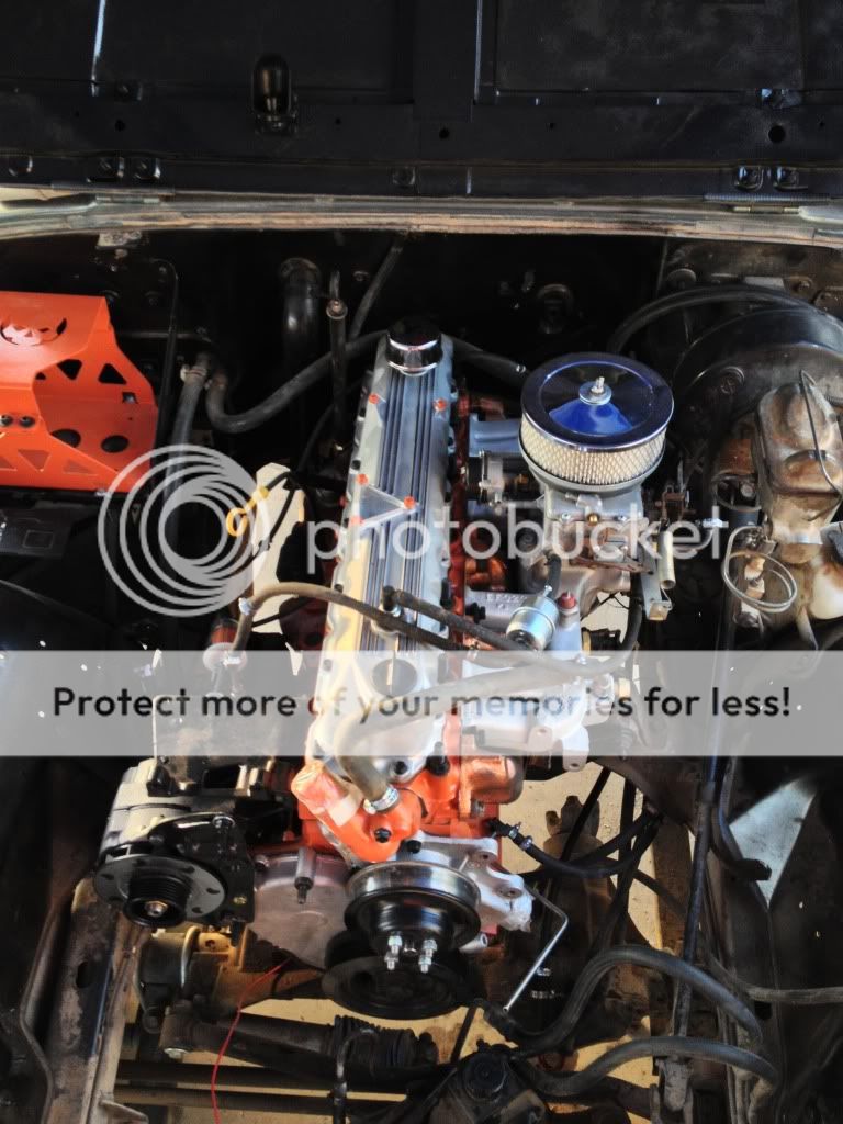

I started off today rebuilding my MC2100:

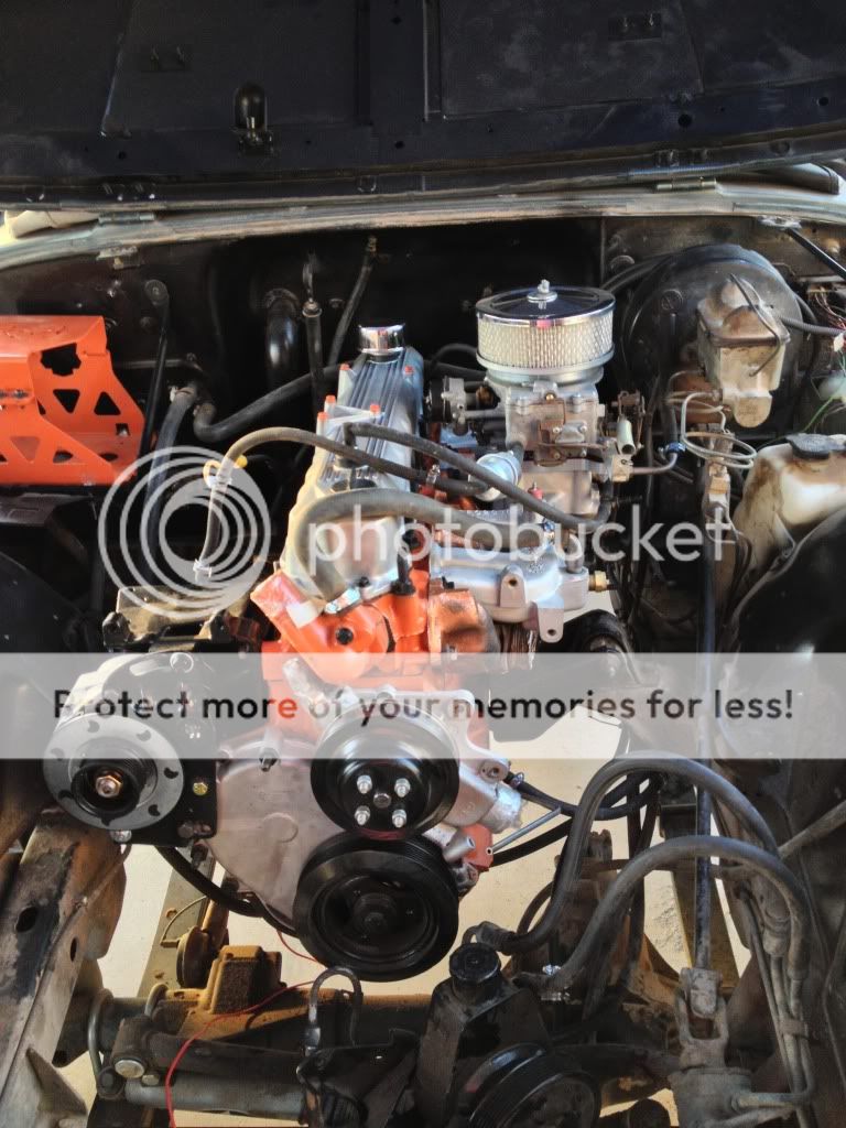

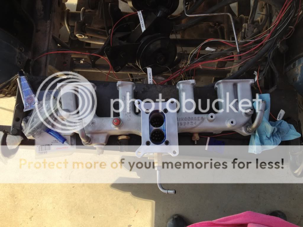

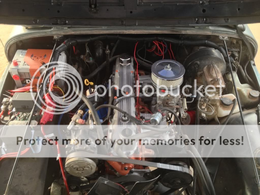

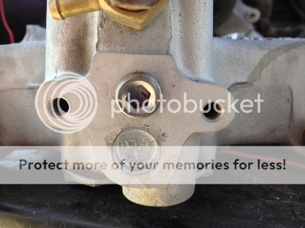

Then I picked up the intake manifold from the machine shop. They cleaned it up, milled it so it is flat and plugged the EGR holes for me for $20. I didnt take any pics before I started mounting the carburetor but here is what I have:
I then mounted the intake and began running vacuum and fuel lines:
I added a cheap clear filter before the fuel pump to try and prolong the life of my fuel pump. We'll see if it effects the ability of the fuel pump to pull gas from the tank. If it does, I'll get rid of it. If it works it will save me a little money and headaches over time.

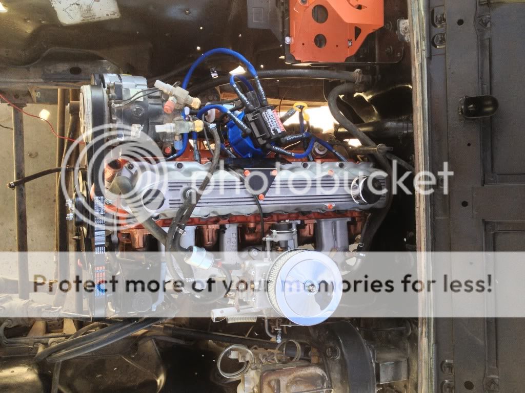

Started off today by installing the distributor. I timed the engine at 8* BTDC just based on the timing marks. It should be close enough to let me start it. Here's a pic:
Question about initial startup though. This is a new motor with a freshly ground crank and a new cam. I know you have to do the cam break-in, but how do you work that in with setting the timing and adjusting the carburetor? Do I just start it and perform cam break in regardless of whether its running a little rich or lean? What takes priority? I've never done this on a carbureted vehicle before. Any tips would be appreciated.

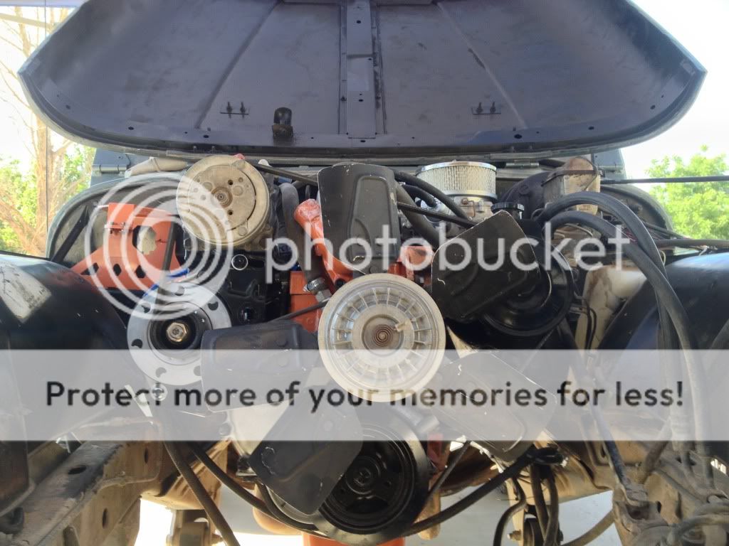

Serpentine belt drive all set up:

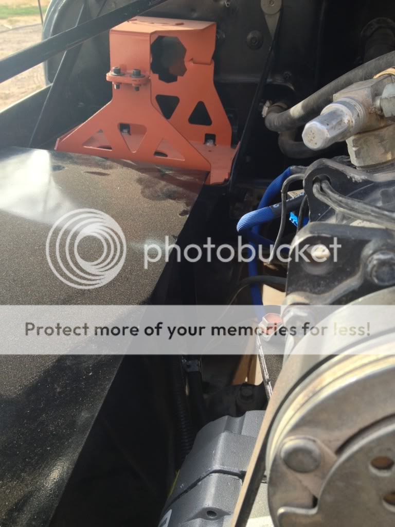

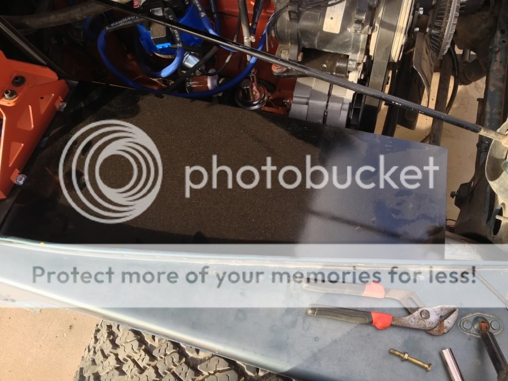

I also fabricated the shelf for the inner fender well that all of my electronics will be mounted to. No pictures of that, but I'll take some when I install it tomorrow. I plan to start re-wiring tomorrow.

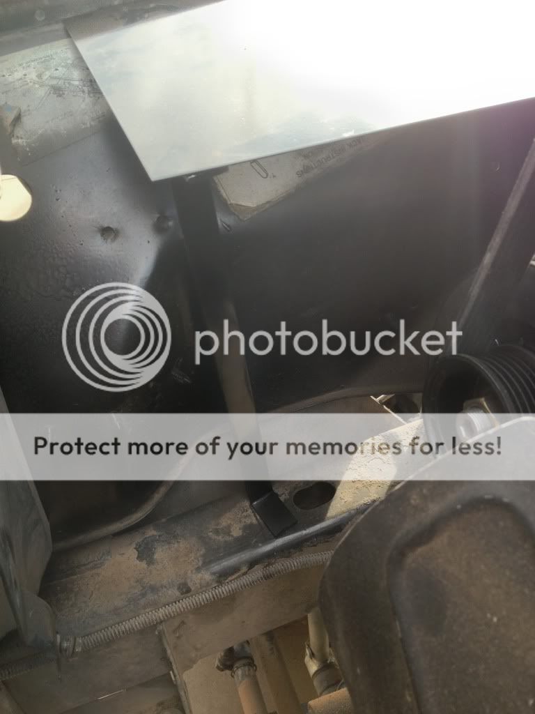

Alright, so not a lot happening lately. I was supposed to start my internship Monday which didnt happen for various reasons. I spent about an hour working on the Jeep today, so here's a short update:
I re-installed the grill and could not get the hood lined up properly with the fenders. I tried all the usual tricks (loosening all the bolts and pushing things around, repositioning hood, et cetera) but nothing worked. I loosened the new battery tray and voila! everything fit perfect. So off to Tractor Supply I went to pick up some longer bolts and spacers. With the spacers in there everything lines up perfectly.
My wife was also nice enough to take off the old fender flares for me. I'm replacing them with bushwacker pocket style flares for her sake (she doesnt like the mud that gets thrown inside the jeep by the portion of the tires sticking out past the flares). Pics of those within the next few days (hopefully), but here's a pic of the jeep without any flares:
I also mocked up the shelf i made for the fuse and relay boxes and various other electronics. It was rather windy today so ignore all the dust all over everything:

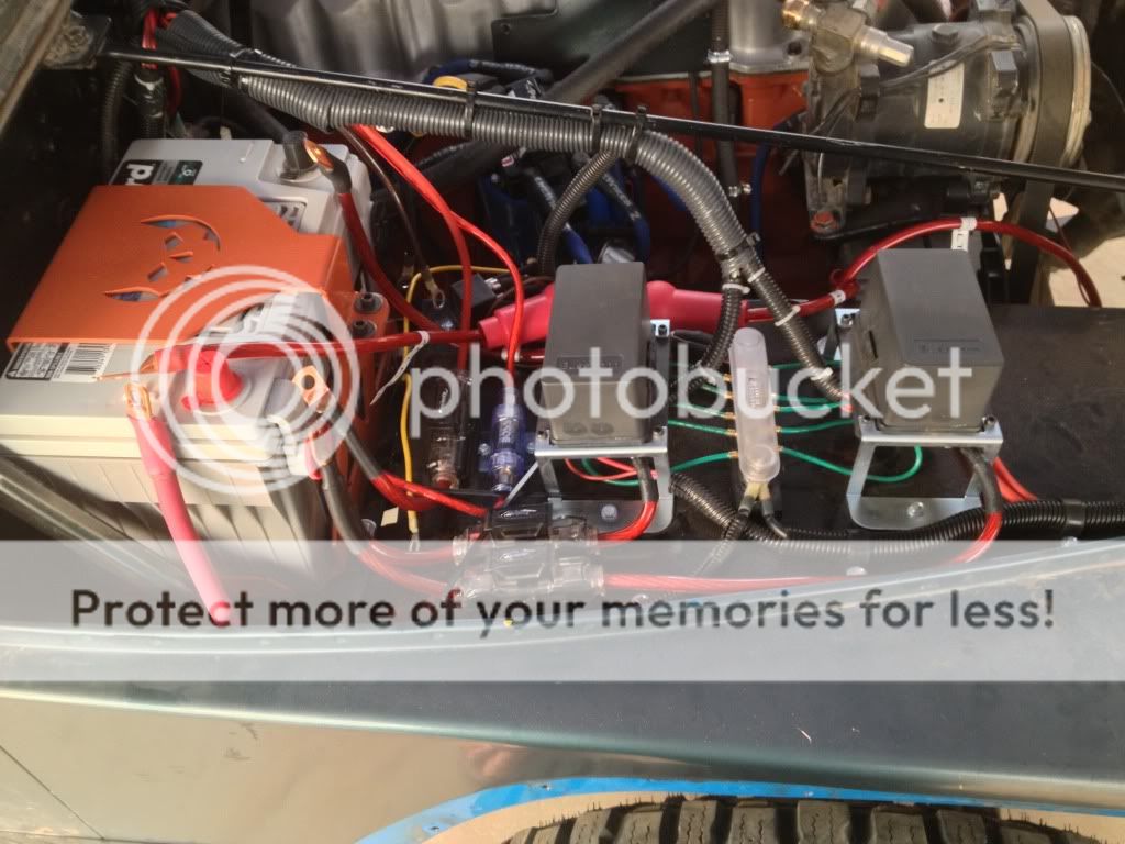

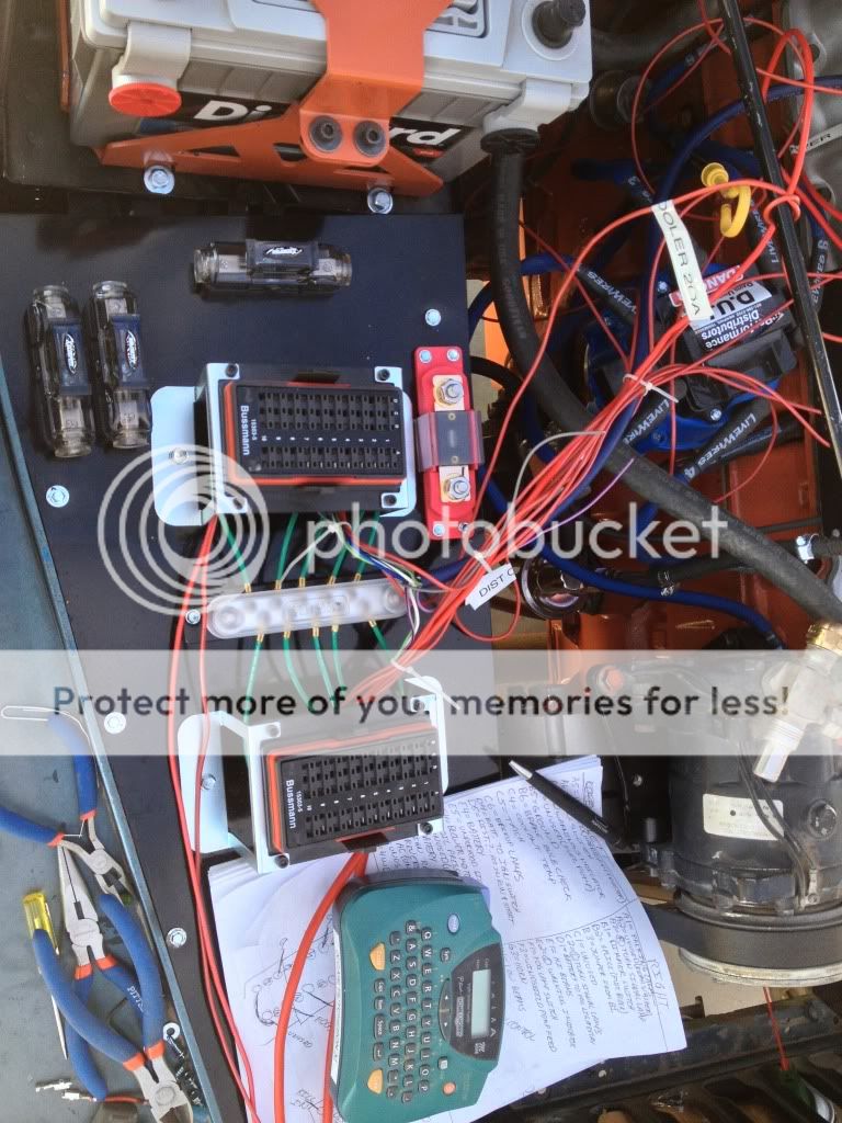

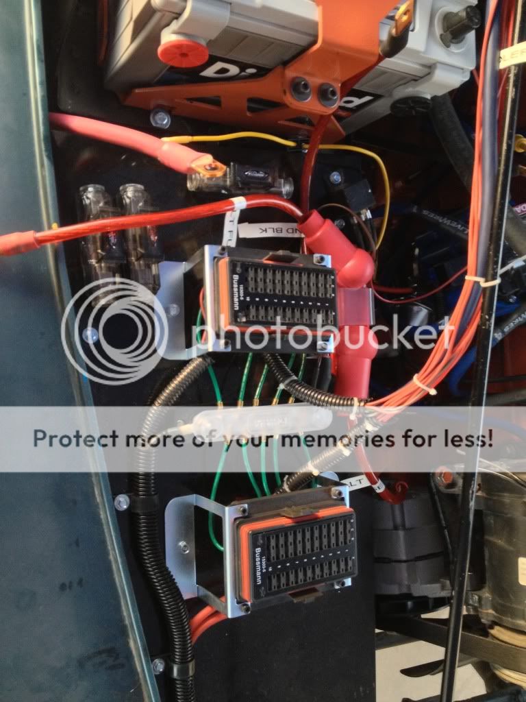

Got quite a bit more done today. Started the wiring in earnest, finished the shelf and got the relay boxes wired and installed. Tomorrow I hope to finish the wiring (haha yeah right!) and be able to fire it up on Saturday. Anyways, heres some pics:

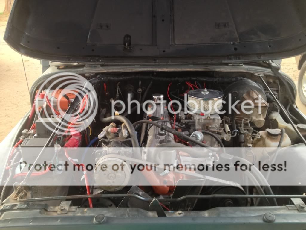

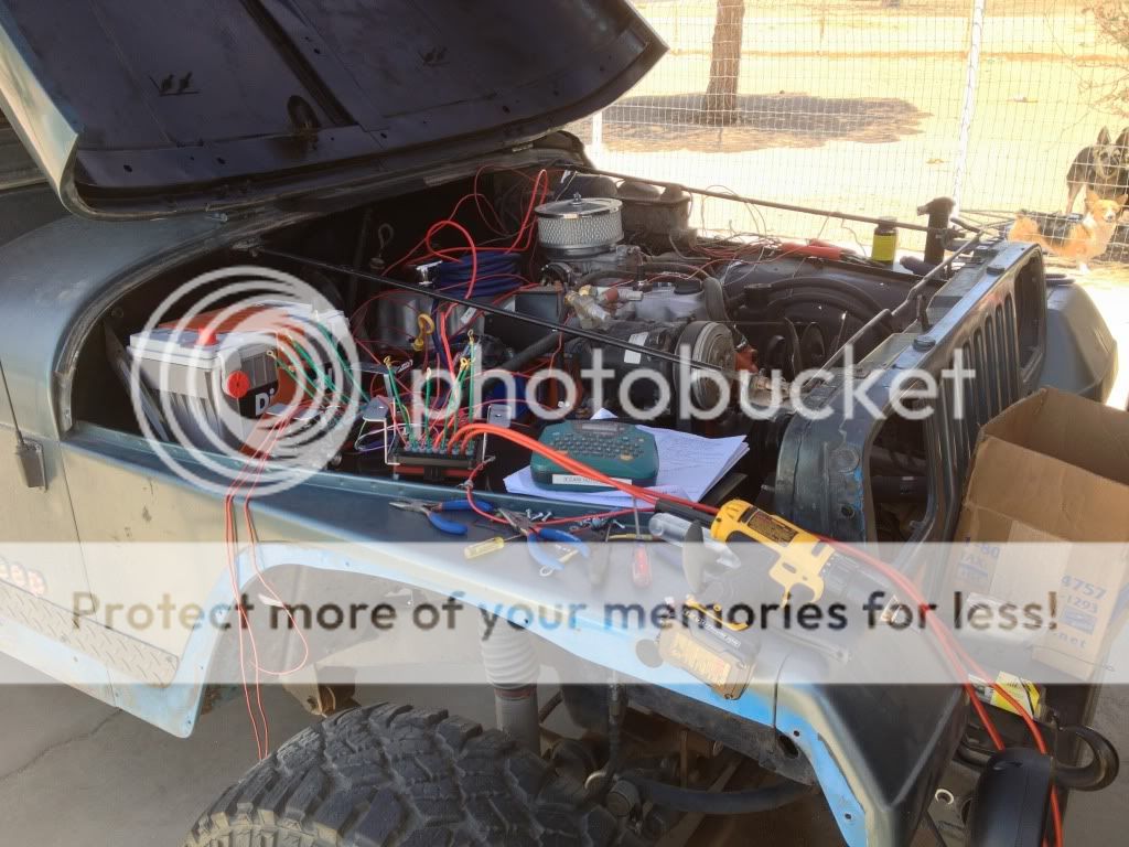

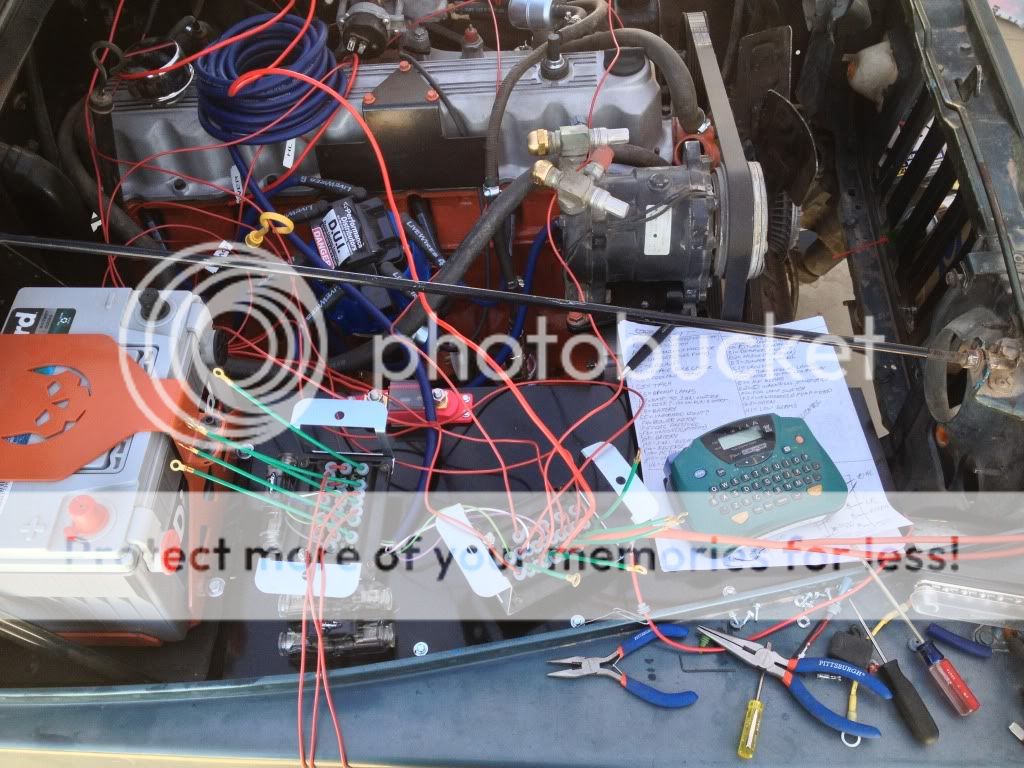

Alright, so the engine bay wiring is 98% complete. I just have to finish up the electric choke and if you look closely in one of the pics there is a spool of 10g wire that needs to be run back to the reverse lights (via the loom with the wiring for the trans cooler). Once I'm done re-wiring behind the dash I will hook the battery up and start testing connections to ensure everything is wired correctly before I try starting her for the first time.
As part of this re-wiring the headlight harness was upgraded using two of the relays in the relay boxes and run with 10g cable (i had extra of it so I figured why not) and most of the connectors were replaced. This included:

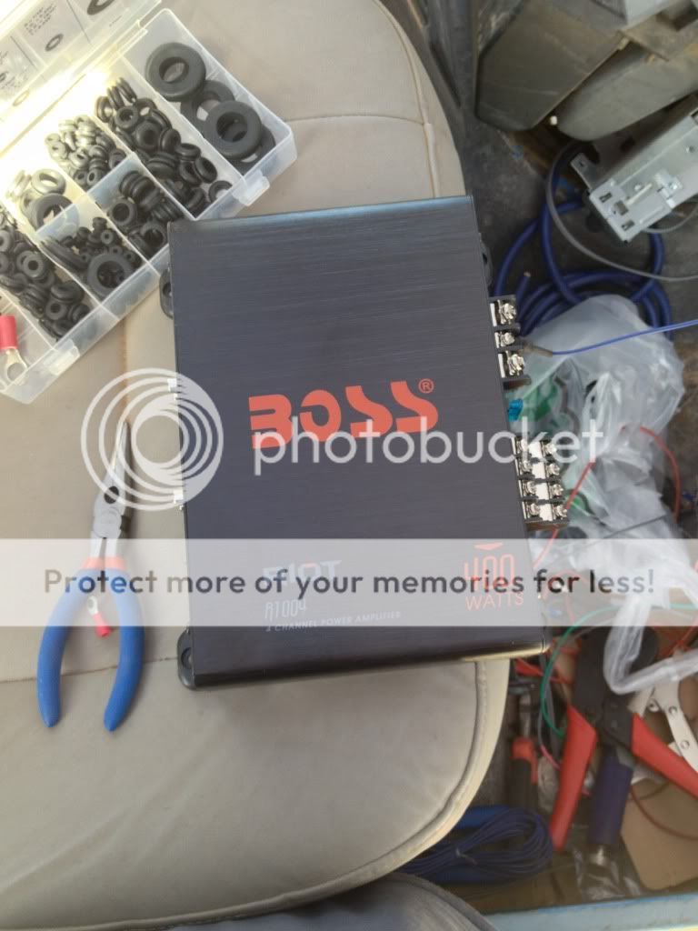

I also ordered a small 400W 4-channel amplifier. I have a cheap marine stereo in the Jeep now that cost me all of $30 and nobody has ever even attempted to steal it because it isnt worth the time. Thus I want to keep it, but its max rated output is 30W on 2 channels. It does however have pre-amp outputs, so the little amp will give me a bit more volume and the ability to add rear speakers a little later. I plan on installing the amp in the dash where the computer used to go.

Nah, I actually work for a company here in town. I'm hoping I'll have more of an update later this afternoon. Fitting the amp in that location in the dash wasnt as easy as i had hoped, but it looks like it will work with a little work.

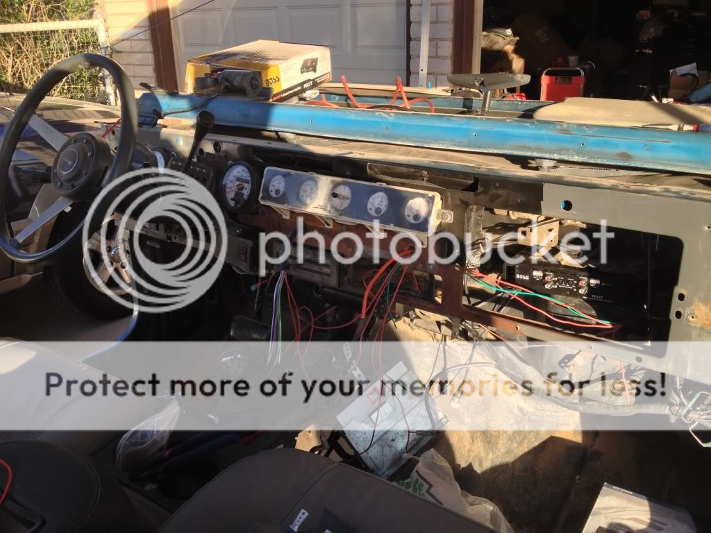

I started out installing the amp and re-wiring behind the dash. It all went pretty smooth. The amp was just small enough to fit in there though I had to use RCA cables with a 90* bend in them because of the tight fit against the back of the glove box.
Here's a shot of the dash wiring. I'll post a finished (or nearly there) pic tomorrow.

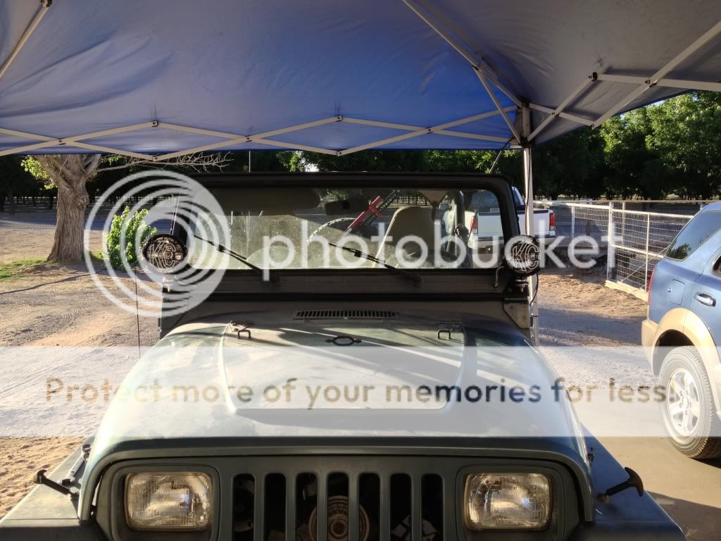

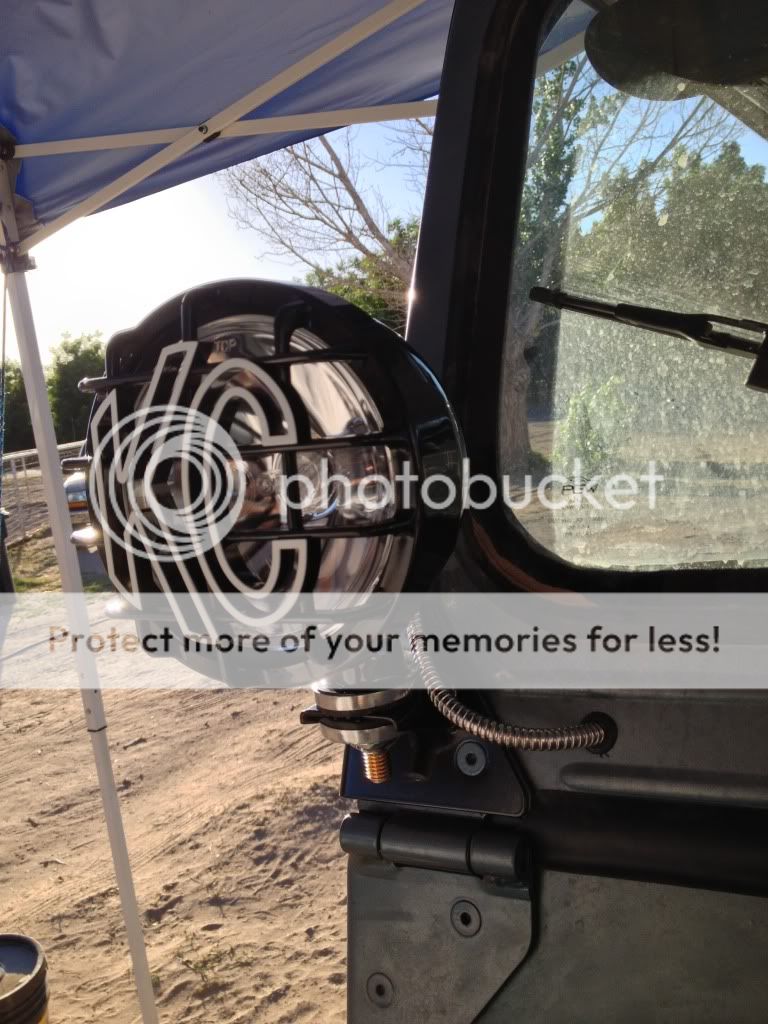

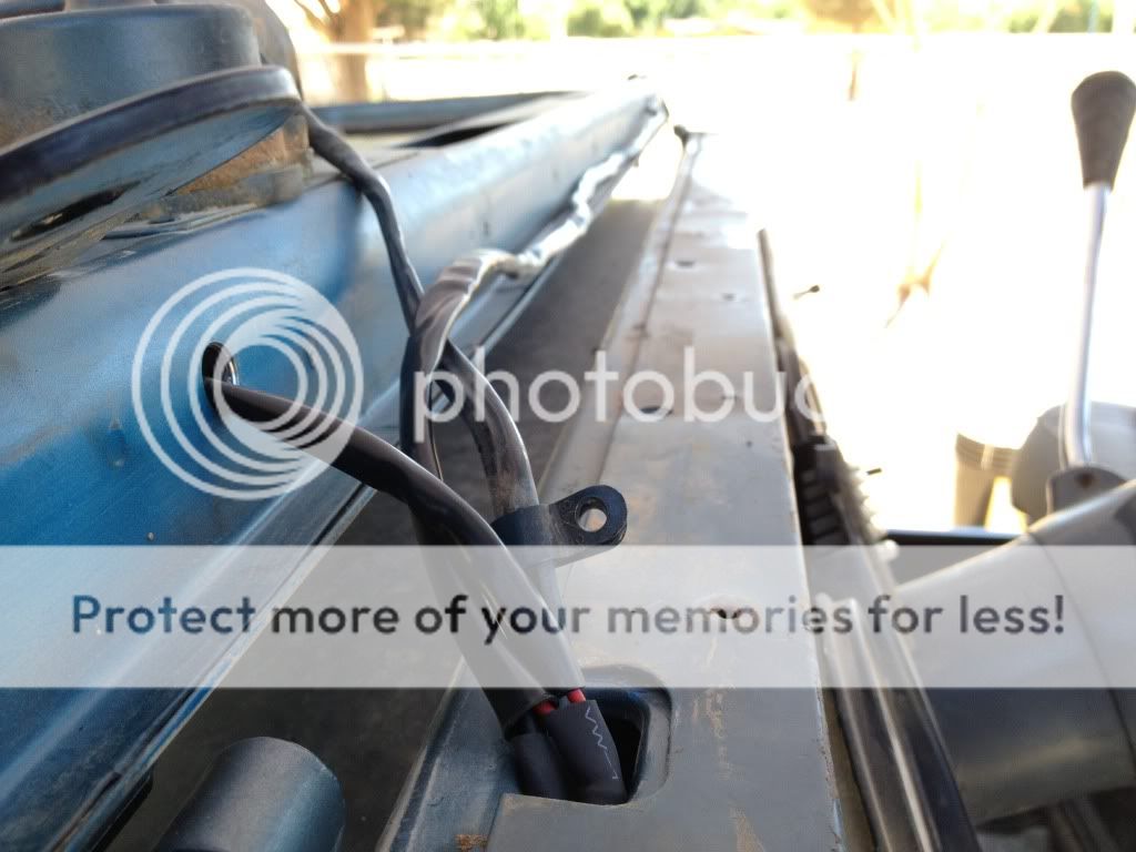

After that I began installing the KC daylighters on the windshield so that I could route the wiring under the cowl. I'm going to leave you with just this one pic:

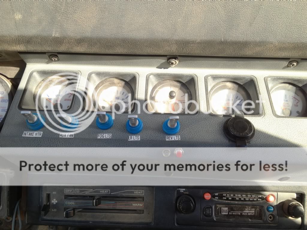

post #45 of 60 Old 06-05-2013, 11:12 PM Thread Starter
tslroper
Location: New Mexico
Posts: 379
Ok, another small update here:
Wiring for windshield mounted KCs run:
Lights mounted:
The yellow covers had to go:
Interior wiring completed:
