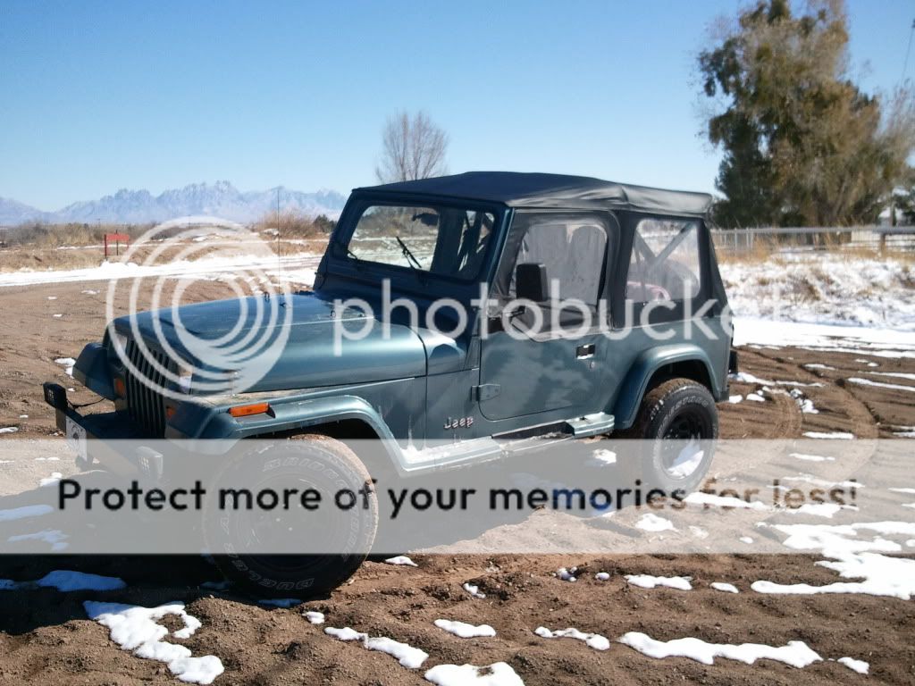

About 2 years ago I purchased this yj for $1000. It was running (barely) but was well worth the money spent. The owner prior to the guy I bought it from had done a full frame-off restoration before selling it. The frame was in pristine condition and the tub had been rhino-lined inside and underneath. The only problem was the rebuild motor caught fire when he went to start it. It scorched the underside of the hood and ruined quite a bit of the wiring. He gave up and sold it to the kid I bought it from. This owner went and purchased a running 4.2L from the junkyard which according to the receipt had 283k miles on it at time of purchase. He dropped it in as it was and got it running, but it kept overheating. He replaced nearly every single piece of the cooling system and it was still overheating. I found it on craigslist, made the 4 hour drive and snatched it up. Nursed it home over 8 hours without overheating it and got to work.
Here it is as it was the day after getting back with it:

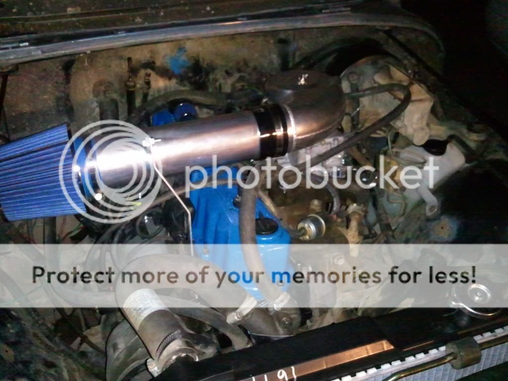

I knew the headgasket was bad, but given that my work was only 4 miles away I wasnt too worried about it. I did however start troubleshooting some of the other issues. It had an older carter carb without the stepper motor, but the performance still wasnt what i was expecting. I decided I needed a new carb and started shopping. All this turned into a top-end rebuild, on which I spent a grand total of $650, most of which was for the carb.

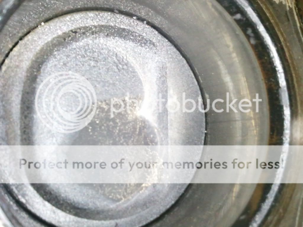

Cylinders at time of top end rebuild:
The head after getting it back from the machine shop (the owner is a friend of the family, so it only cost me $120 for cleaning, surfacing the mating surface, 3 way valve job and assembly):
New timing chain and gears:
New carb on:
TFI ignition upgrade (helped quite a bit, but i had a lot of problems with the canister coil):

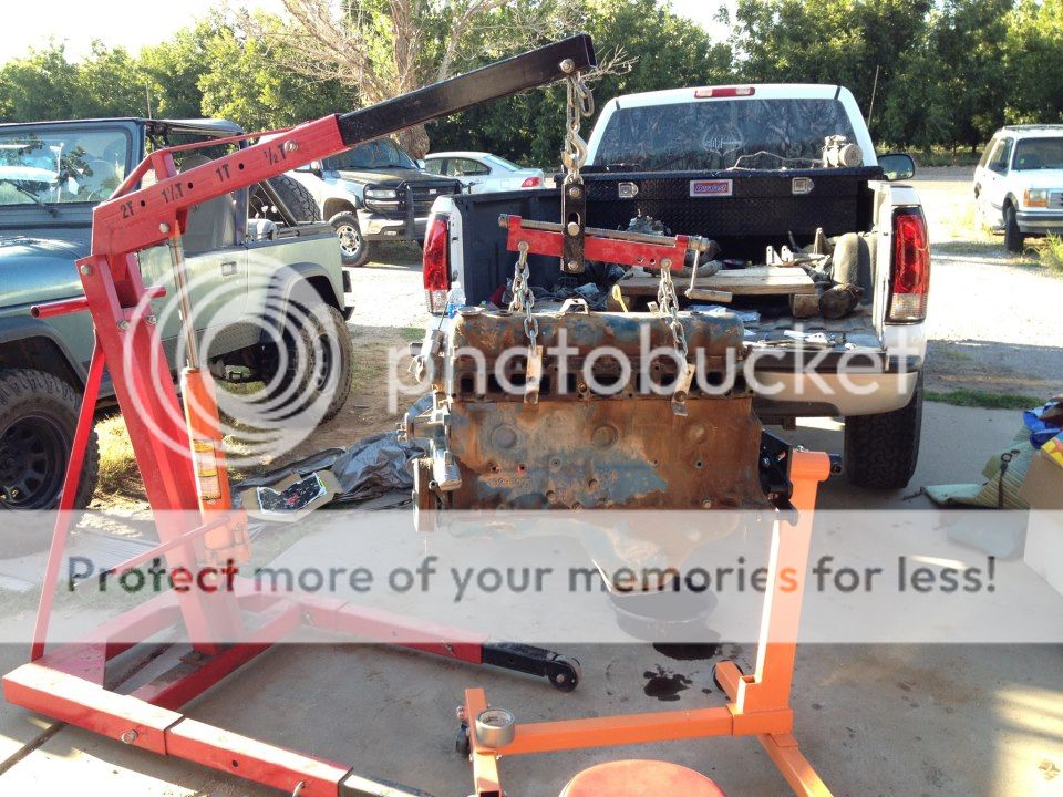

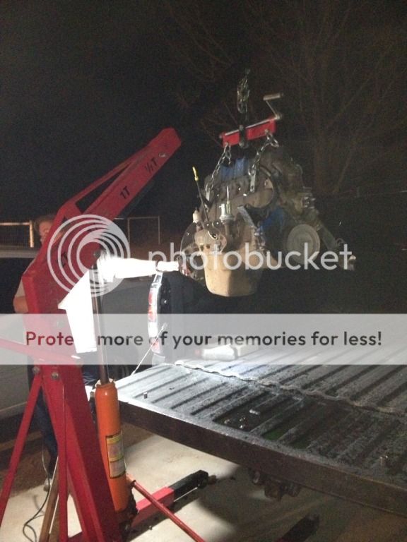

Last fall i started getting pretty bad knocking from the lower end of the motor. I had also lost 2 piston skirts in the last 8k miles, so it was getting close to time to rebuild the bottom end. I purchased this motor which someone had dropped for a V8 swap for cheap. It had already been bored .060 over and had 60k miles on that rebuild, but it had a serpentine belt drive system and the correct crank in good condition. $150 well spent.
That brings us up to date. Friday night I pulled the motor from the jeep and dropped both of them off at the machine shop. He's doing all the work including assembly and warranty for $1000. Not bad, and saves me time (which I dont have a lot of right now).

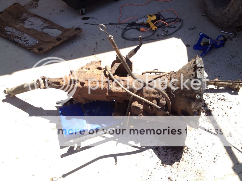

In the process I determined the PO had cracked the bellhousing where the started bolts and had re-attached it with JB weld. So out came the transmission and tomorrow it goes to a local shop to try welding it back on.

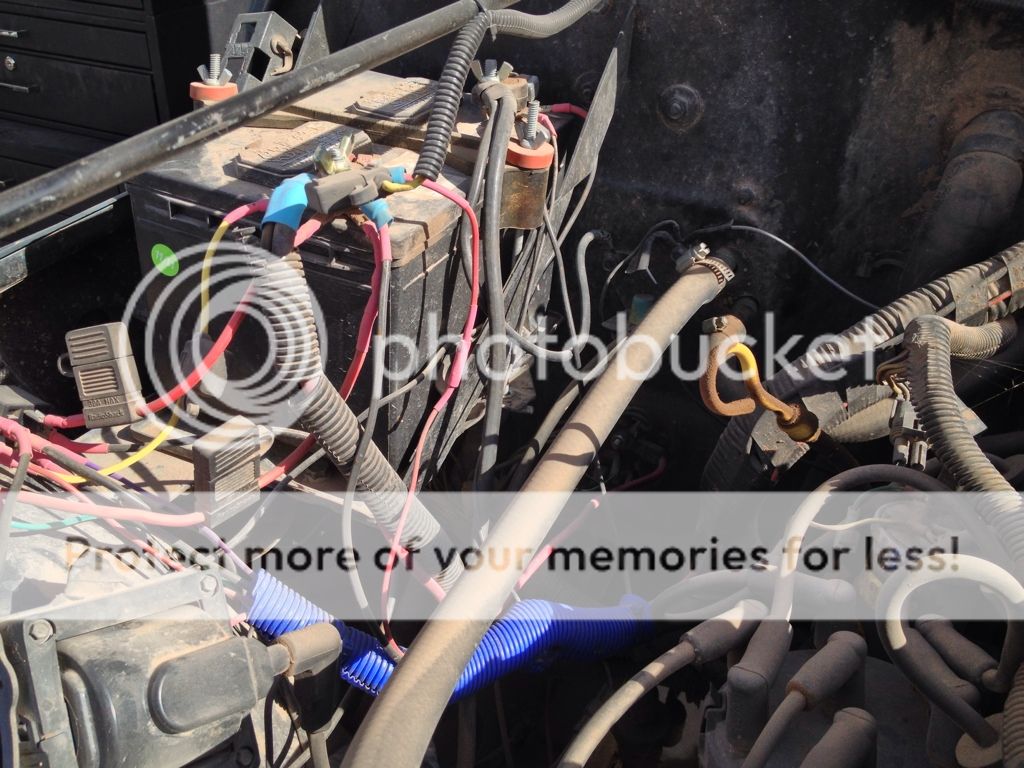

Here's a few pics of the wiring prior to pulling the motor:
So, while the motor is out I'm re-wiring the entire engine bay and pulling the computer out from under the dash.

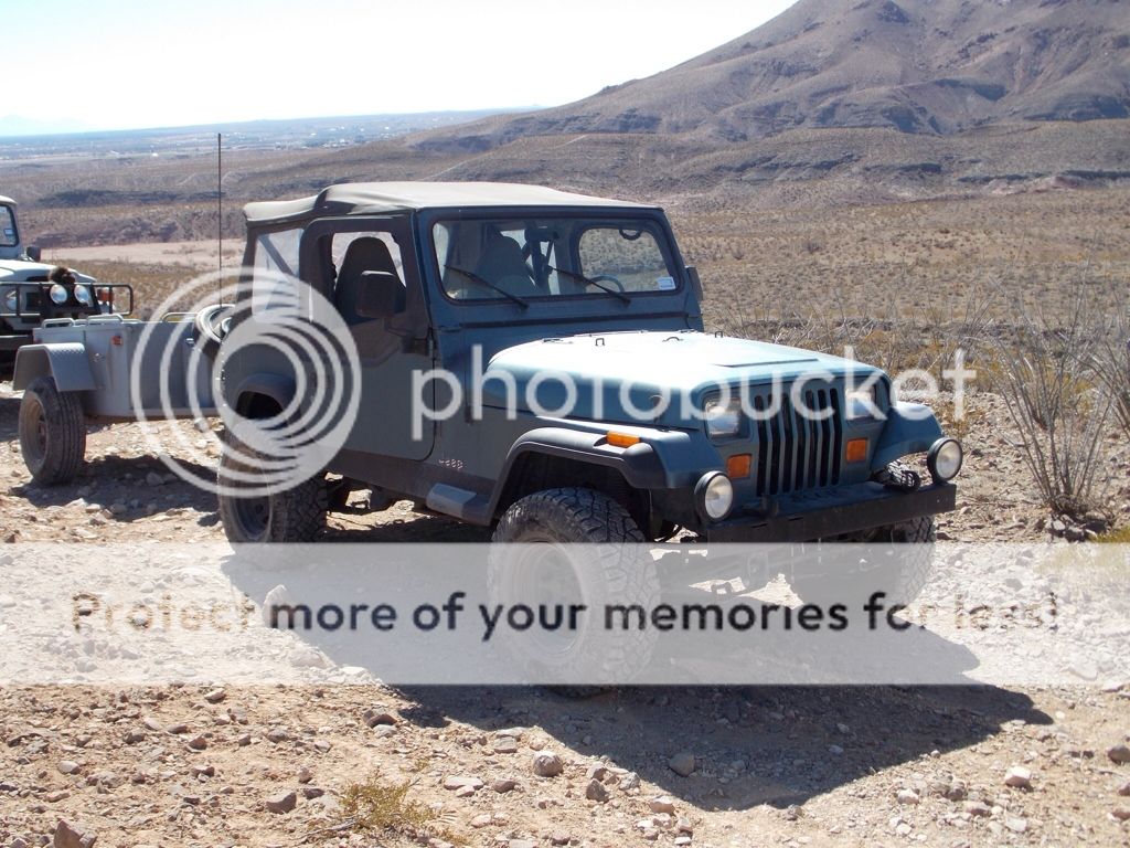

Back in February of this year we again participated in the Chile Challenge. This year we only had time to do a single trail, but we had a blast and pulled the trailer the whole way.
Airing down:
An arroyo on the trail:
Where we stopped for lunch:
Unfortunately I again dont have any action shots of the jeep, but it was a good trail. It was challenging, but not horribly so, and the trailer added a level of difficulty to it. It certainly helped me prioritize things to come on the jeep:
