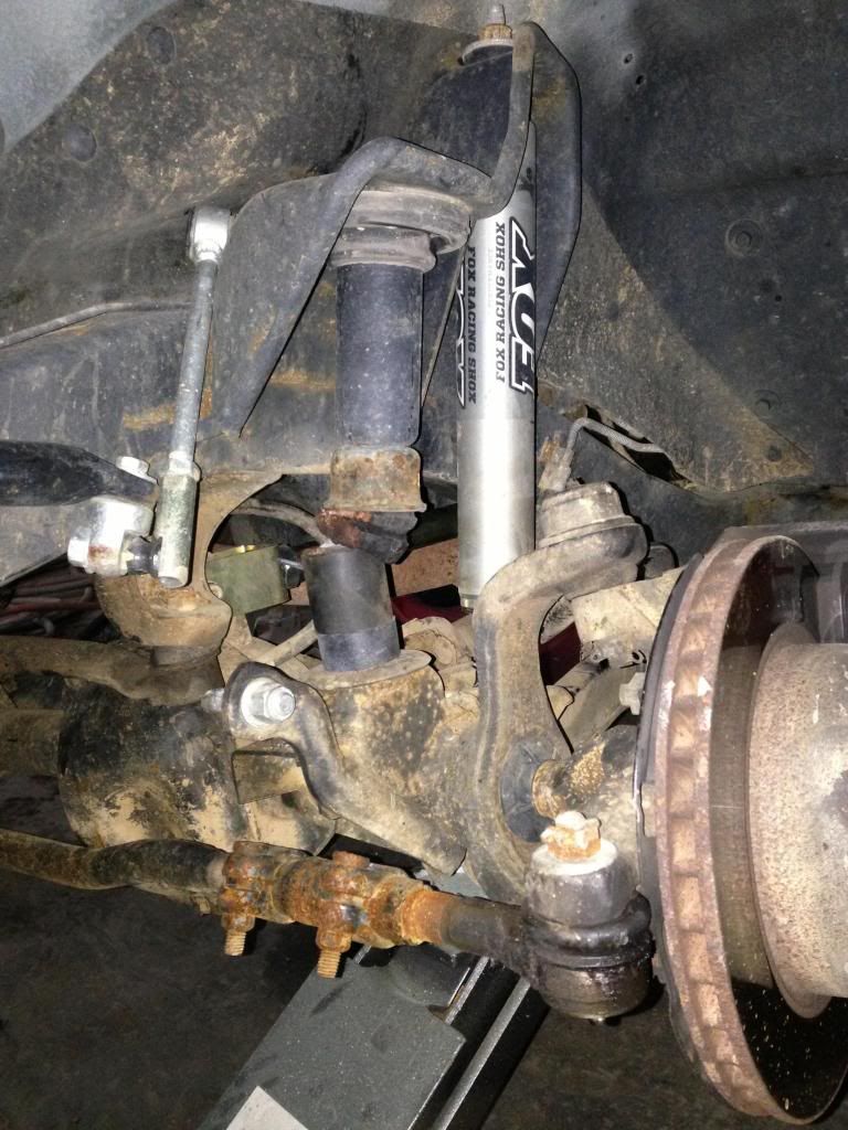

Well yesterday we got the front bumpstops done. Turns out that I needed 3" extensions. We stacked a 2" body puck and a 1" body and Jake made some self-tapping bolts that worked perfectly. And, to my surprise, the first contact point was tire-fender instead of the shock being collapsed. I believe there was about a half inch of shock showing at full bump. So I guess these Fox shocks really aren't too long after all. I'm happy.
We also got the front uppers installed. And, despite me taking both off at the same time, they went on fairly easily. One axle side had to be widened a little bit to fit, but other than that they fit perfectly. Ill get a pic sometime today.
The biggest issue we had was getting those ****ing coils back in. They just didn't want to go. We had to drop the trackbar and take off the axle side bolts on the uppers to get it to droop enough, then we still had to fight to get it in.

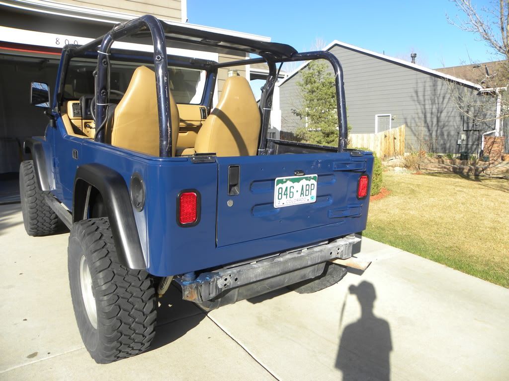

As I'm putting money away for the axle swap, ill be doing minor little mods. The next purchase will probably be some frame tie-ins from Barnes, then eventually a tail plate (still not sure from who). Also, while searching around the forum I found a guy who looks to have rotated the stock tail lights and sunken them in almost flush. I think it looks very good and since I'm having trouble finding flush lights I like, I may look into the more and try it. If anyone has any info on it, I'm all ears.

I wouldn't do that...if you go that route, it sort of limits your options forever. & stock taillights aren't much to write home about.

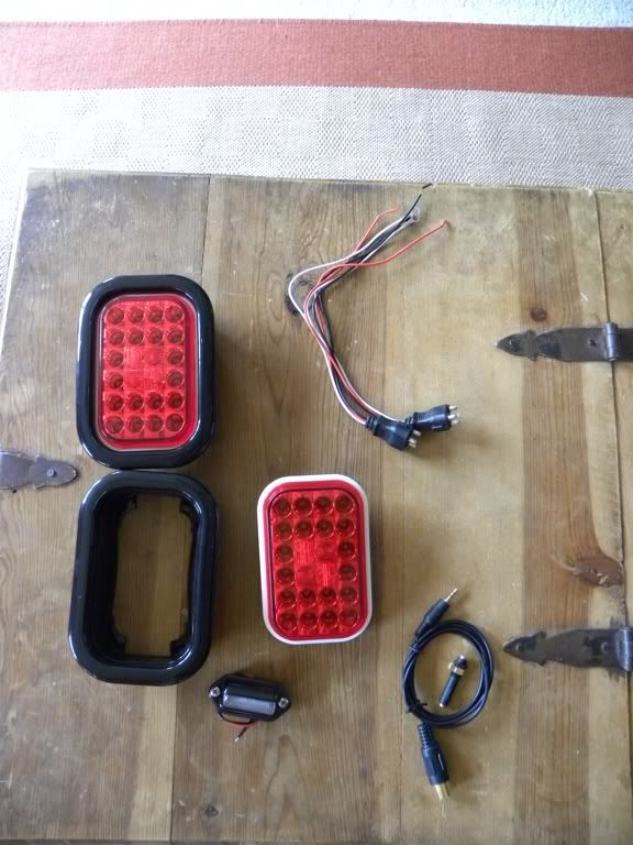

I just did some led flush mounts, they were $30 for the tails (or $32) & then I bought some big'ole reverse ligths too. But you could just do the tails & license plate light if you want.
....I have my old led taillights for sale...but they stick out.....if you're committed to cutting a giant hole, flush mount them

Yea, I got to say I'm not a fan of the stock tail lights in any other configuration than stock.

See I actually like the stock tail lights. Maybe I'm just weird
