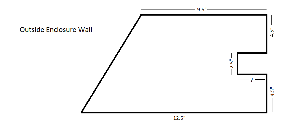

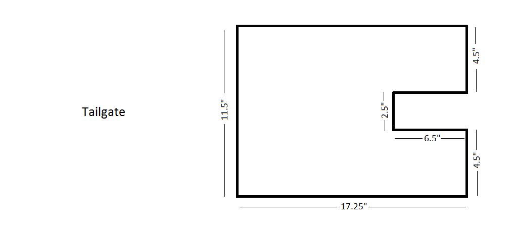

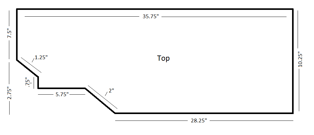

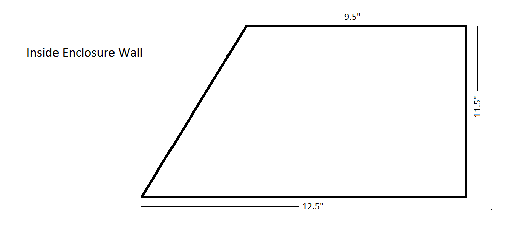

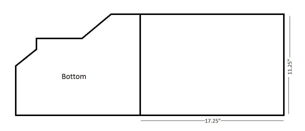

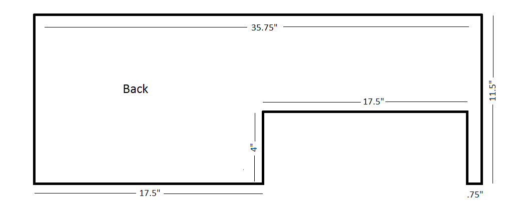

I have had some requests for dimensions of my trunk/enclosure. I built it one piece at a time, so I didn't have any original plans for it.
I put these together getting the measurements as accurate as I could. The dimensions represent each individual piece.....not the assembled dimensions.

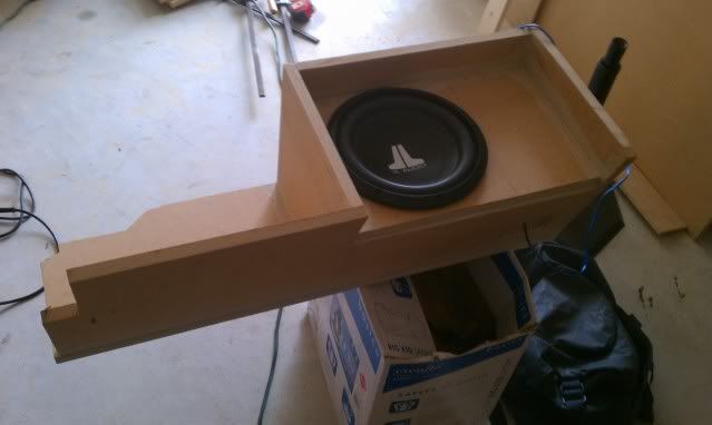

I did not illustrate the cutout for the sub because that can vary depending on sub. As you can see in the pic below, I did mount mine over toward the middle of the trunk to clear the cutout/box for the third brake light.
The bottom piece (where sub mounts) rests on the "back" and is secured there. On the inside of the enclosure, I attached a lip for the rest of the bottom piece to attach to. It is nailed and glued from all sides.
I did not include the dimensions of the little box for the brake light cover cutout, but that is easy to figure once those two sides are pieced together. Rather than trying to match the angle needed, I went with straight cuts and a rectangle piece. There is a very minimal loss of air space, and it is an incredibly shorter construction process.
Also, I decided not to add a piece to the driver's side against the side of the tub because it fits so tight, it would not be possible to install it if that piece was there. It is so ridgid otherwise, it's not an issue at all.
Patrick

And you can take that enclousure in and out with little effort? Are there quick connectors for the wiring? This would be a really attractive option for me but I haul gear in the back quite a bit and would need to be able to remove that sub quite often...

The trunk comes out fairly easily. It is a very tight fit so it doesn't just pull straight up (designed that way), but is is no issue to remove on a regular basis.
I did not use a speaker wire terminal for this enclosure. I have used them in the past, but my last couple of enclosures all just get a tiny hole to pass the wire through (and then the hole is sealed).
The couple times I have removed the trunk, I just undo the wires from the amp that is under the seat.
When I move the amp from under the rear seat to under the steering column I will need to come up with a quick release near the trunk.
Click the link in my sig for the build thread of it.
