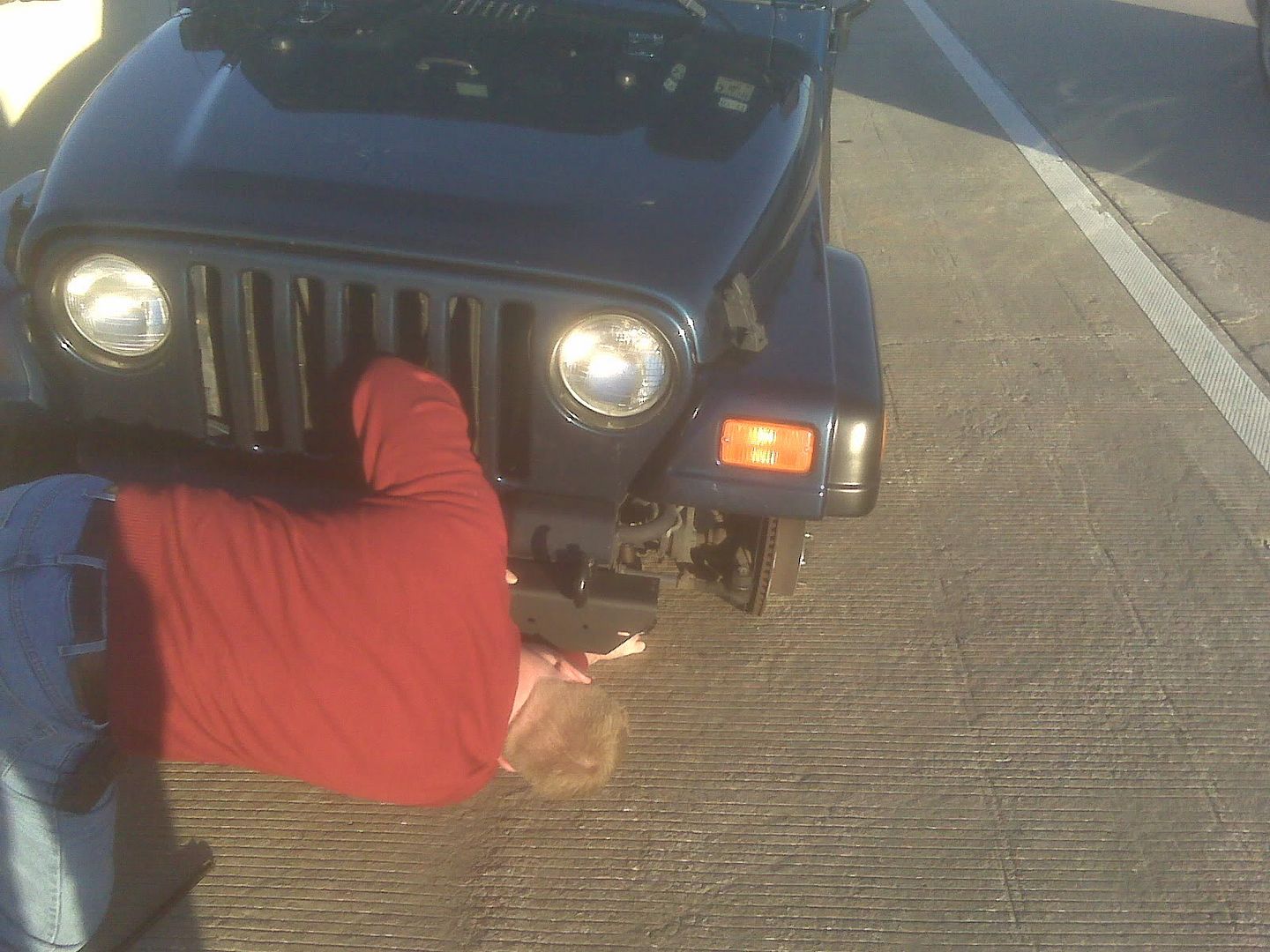

Driving home Thursday evening doing 65mph in the fast lane, my driver's front tire flew off. I think the lug nuts failed. The studs were pushed back, loose behind the rotor/hub, but the threads were not messed up at all.
My buddy was also on his way home and stopped to give me a hand. We jacked it up, pulled three of the studs through, and mounted the spare tire with the 3 spare tire lugs. It was enough to get me home to get it on jack stands.

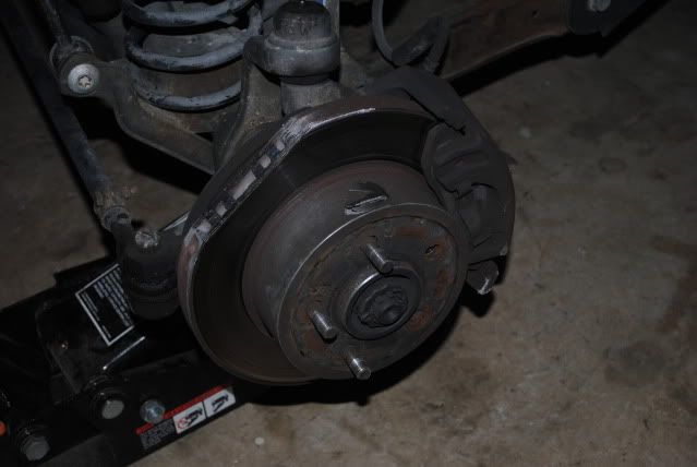

I have not had much time at all to work on the Jeep. I am ready to have it all fixed and back on the road...just need a couple spare moments.
I did however take the caliper and rotor off last night. I am glad I did because it exposed a couple parts that I needed to order from the dealership.
I knocked the three studs that are left, loose. I tried to remove them, but there is not enough room. From what I understand after a quick search last night, to get those out and the new studs in, I have to unbolt the shaft from the axle tube to gain enough clearance.
The tails of the three bolts that hold all of that together were obviously damaged when the wheel went flying. I figure it was the loose wheel studs that hit against them and messed them up.
I think I can cut the tips of two of them off so I can remove them, but the third was cut and ground smooth. I have a feeling that one is going to be a severe PITA to get out.
I called the dealership this morning and they have the 3 bolts on hand, so I won't have to wait for those to come in. I am leaving work early today, so I hope to get a good head start on working on it.
Check out all the holes in the rotor.....
(Think I can get just get that machined out?) HAHA

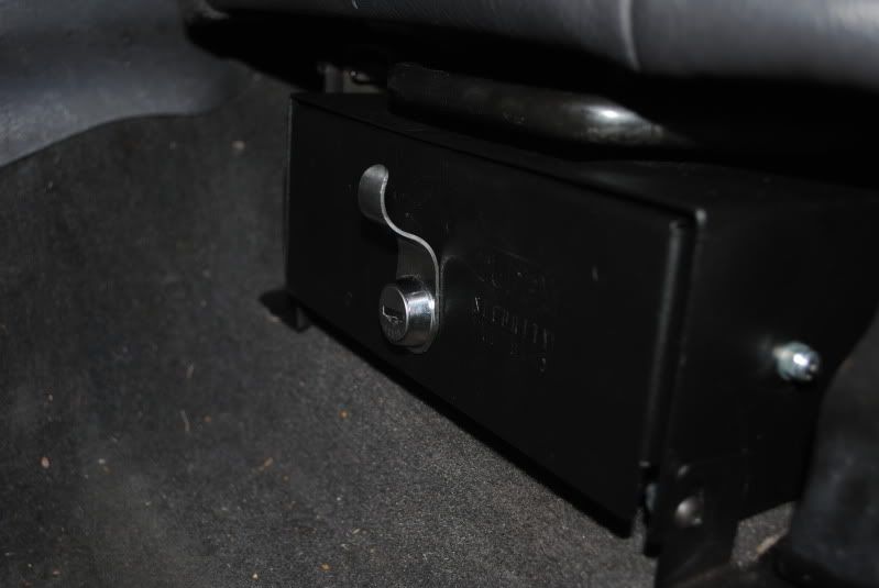

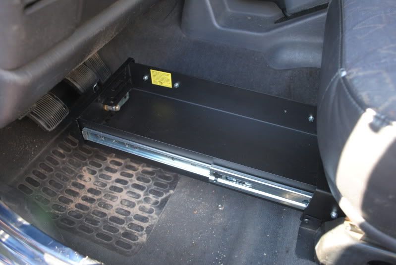

I FINALLY got around to installing the Tuffy Conceal Carry drawer. My friend Paul hooked me up with a seat bracket swap. I had the fold and tumble and he had the standard tilt bracket. I wanted the full length drawer more than the fold and tumble function, and he wanted it, so it was an easy swap for us.
The drawer is about 16.5" long when full extended and about 7" wide. Tons of space for those little expensive things like radio faceplates, sunglasses, Ipod, etc.
I cut a piece of non-slip drawer liner to keep stuff from....slipping.

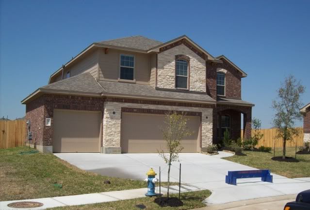

On another note....the house is coming along. They poured the flatwork on Friday. It will be easier to explain with the updated picture of it, but they had to curve the driveway portion for the 3rd car garage to go around the fire hidrant.....as opposed to a full 3-car width driveway. I talked to the 'super' about it and he said it would be the cost of a small car to have the hidrant moved. So it is what it is.
