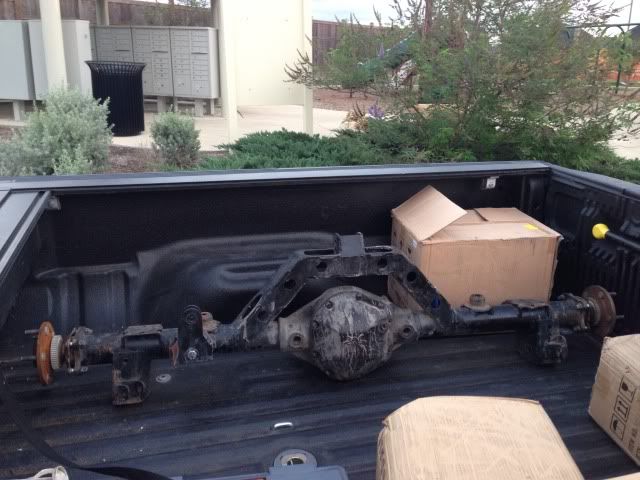

Made a trade with someone locally. This is going to be good! Now to find a front....
JK Rubi d44. Has factory locker and 4.56 gears. I will set this up with 5.13s from the start.
It has a truss on it from a Rock Kraeler kit that will obviously come off along with every other bracket.
I am planning to get the TNT Customs truss and bracket kit to line everything up for my TJ. I will go ahead and sleeve it while it is torn apart and getting welded on.
I think the PSC diff cover can stay.

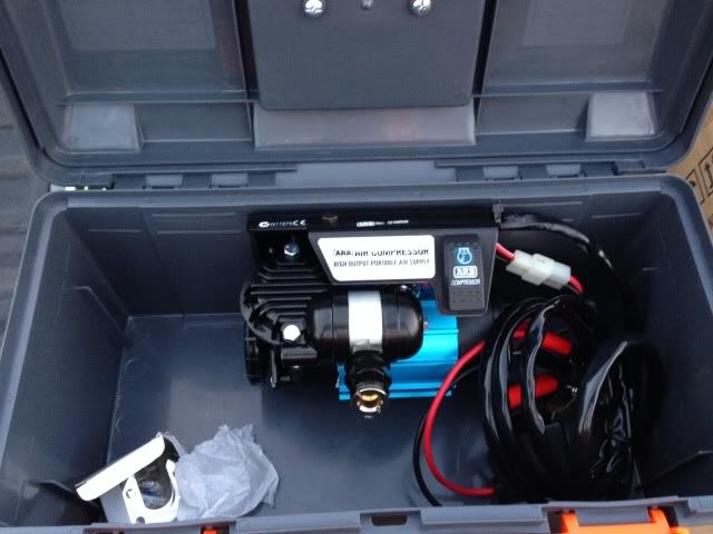

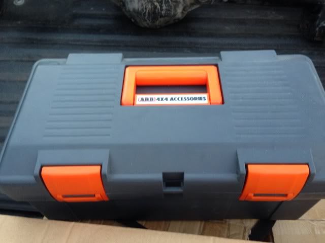

In addition to the axle, I scored an ARB heavy duty air compressor setup.
I run a CO2 tank for filling tires, but it is possible the axles could see ARB lockers if I have to upgrade the carriers for higher splined axle shafts.

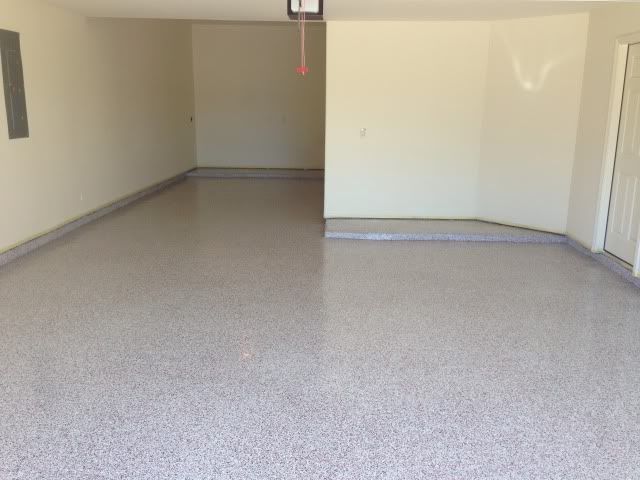

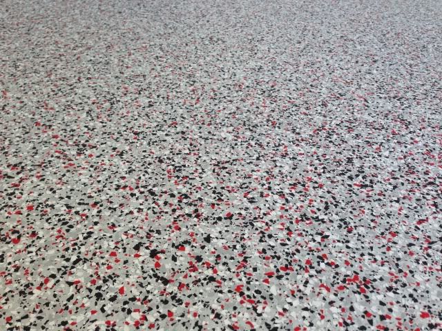

We closed on the house this past Thursday. I spent the weekend moving small stuff over so we can live. The big move of stuff from storage goes down this Wednesday. In the meantime, I had the garage floor epoxy coated. I definitely spend a lot of time out there and want to set this garage up the way I have wanted to do all the others.....I'm just actually getting it done this time
The company I had do the work uses a product from Arizona Polymers. It is a 4-part, industrial grade epoxy system.
I went with what the company calls "Marble". It is a light grey base coat with black and white chips. I asked them to add some red chips to tie in my overall color scheme.....yes, there will be a color scheme I had them do a 75% broadcast of the chips as I wanted to see some of the grey showing through.
The last coat of clear went on yesterday, so it can be walked on today, but they suggested I wait another 3-5 days before driving on it.
