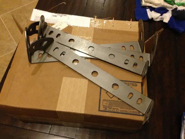

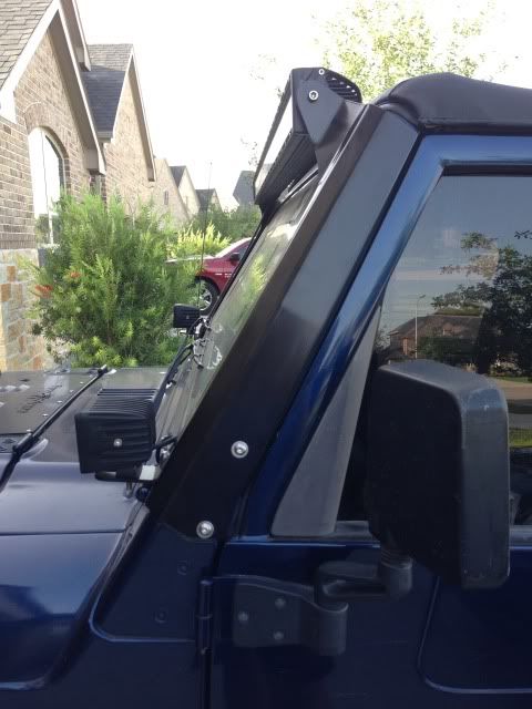

Picked up the brackets. They turned out great!...excuse the greasy finger smudges.
These are from Motobilt (www.motobilt.com). They are a great design and I can't say enough nice things about Dan Dubose (the owner of motobilt); he has been great to deal with on these and some other products.
You can look back to previous posts about the Poison Spyder mounts that I was testing out. They are a solid mount, but had some design shortcomings. The Motobilt brackets pick up where PSC left off and created a great setup.
These brackets have a thin spacer welded to the backside down where it bolts on that space the mounts away from the windshield frame enough to run the wires down so you can get them behind the cowl. The PSC brackets don't have this which makes hiding the wires impossible.
These also go all the way down the side of the windshield to utilize the lower bolt hole where the PSC mounts come up short and do not use that bolt point. The design makes for a more complete look.
Like the PSC brackets, these are made with 3/16" steel and have a slight bend/break in them part way up to keep them as close to the windshield frame as possible.
Motobilt also offers optional lower light tabs for a nominal fee.
I hope to get these mounted up soon!
Patrick

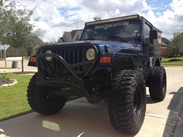

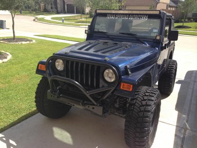

Thanks! I forgot to post the installed pictures.....
Patrick

Posts: 1,448
That came out great! Bet those lights turn the night to day!

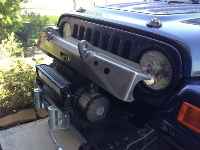

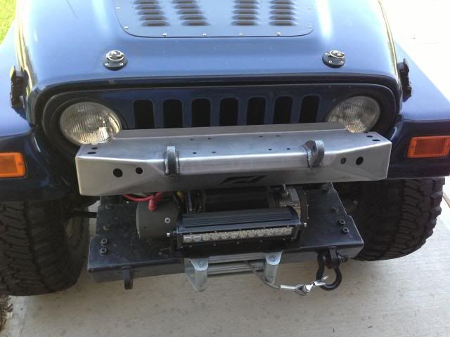

My new front bumper from MotoBilt came in yesterday, along with some universal light bar mounts for my 13" bars.
I am totally excited about this bumper. Dan DuBose is a wizard with the welder. I saw this bumper when I was ordering the light bar brackets and just had to have it. It fits my 'stubby' front bumper preference, and adds some style that mine does not have. It is all 3/16" plate and weighs gobs less than my current 1/4" plate bumper.
I will be adding the Genright trail stinger to it....glad I never got around to installing it on the current bumper!
I just ordered his fairlead mount to go with this. It is also 3/16" steel and mounts under the winch, so effectively, the winch mount is doubled up 3/16" steel.

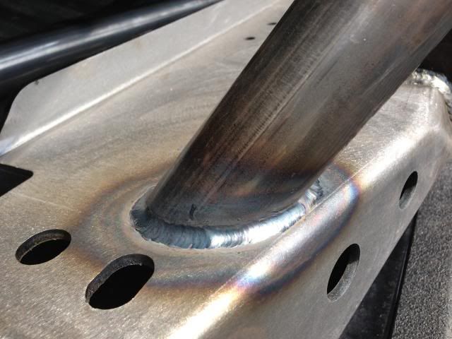

I dropped the bumper off in the shop this morning to have the trail stinger/winch hoop added. I still have the grille hoop, but I am not sure I am going to incorporate it with this bumper design.

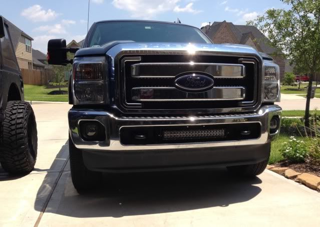

In non-Jeep, but tow-rig/DD news, I added a 21" LED light bar to the F-250. I modified a Rigid mount to work with my brand of light bar.
Patrick

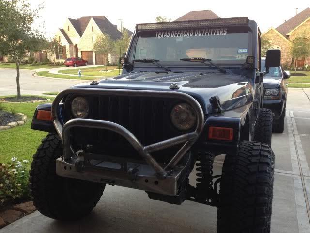

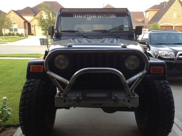

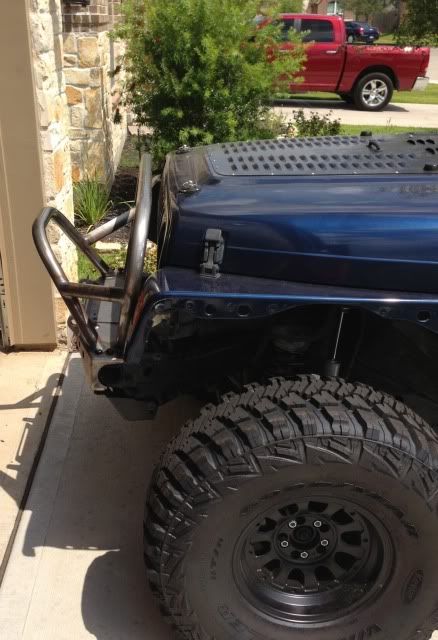

Finished adding the tubes and the fairlead mount came in.
Patrick

That turned out awesome!
Do you have a pic from the side to show how far it sticks out from the grill?

Pictures can be deceiving, but you can basically fit the flat of your hand between the grille and hoop. It's far enough away no to interfere with popping the hood, but close enough not to look silly.
Originally Posted by bclark11 View Post
Awesome!
Thanks!
Looks even better coated! Picked it up from Westside on Friday. They did awesome work again!
Haven't had the chance to mount the winch yet or really bolt it down. Just two bolts to keep if from falling off
