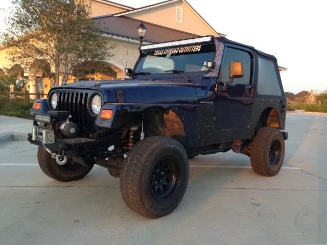

It was Friday night, lift night.
Decided since there was a nice breeze and the temperature dropped down to the low 90s, I would install the BDS 2" coils and N2.0 shocks I've had sitting, waiting to be installed for several months.
Patrick

Started mounting the Genright mini-boatside rockers today. I would've gladly finished the first side, but I can't find me 11/32" drill bit for the rivnuts....and it's like 135* outside.
Once you get past banging the ever-livin' stuff out of your perfectly good rockers, the install appears to be a breeze. When it is all bolted up, I will mark the rear of the guard and trim off the excess.....they come long enough to accommodate a stretch.
With these installed, it will make building the front fenders a bit easier since we will know how to trim them to clear the bend in the rocker, from the start.
Since I have the tubes on the rocker guards, it is getting me thinking about adding some to the rocker armor as rub rails.
