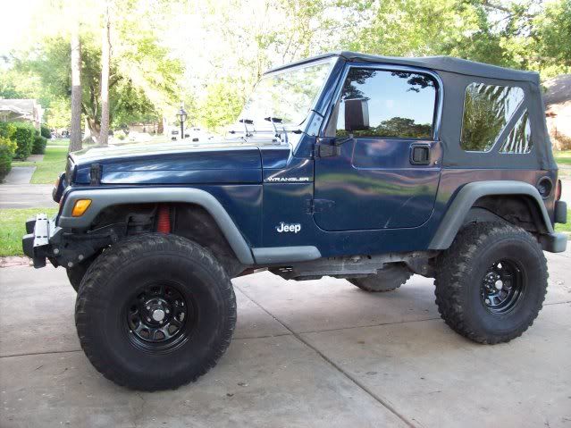

My wife and I purchased the Jeep in April 2010. It had about 87k miles, 4cyl, 5spd, and no A/C and was in overall great condition.
One of the previous owners installed a 4" Rough Country Series II lift, 35" Pro Comp MTs, and black steel wheels. The Jeep was otherwise in stock condition........oh, other than about 10lbs of stickers and rags for a soft top.
This was me leaving the lot about to start a 200 mile trip back home.

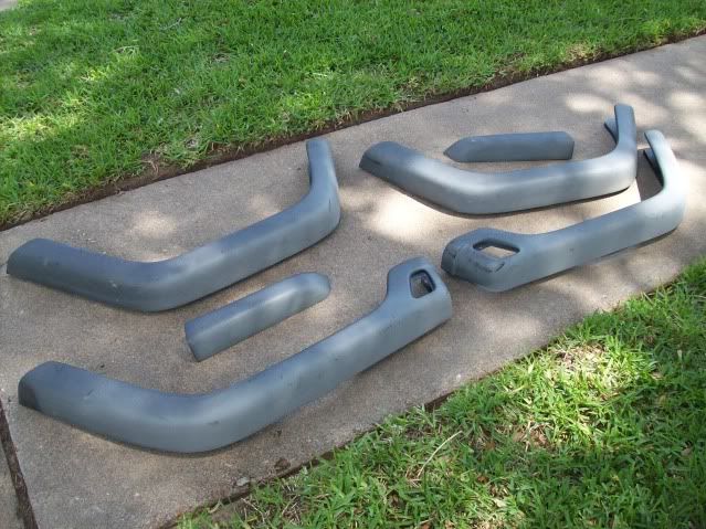

The fender flares were terribly faded, as what tends to happen. I pulled them and prepped them for paint. I used Krylon Fusion 'satin black'. I have used this paint on both of my previous TJs and the results have always been great. I think 'flat black' would also be a great option.
While the Fusion painting was in progress, I painted the headlight rings too.
It really is starting to look like a different Jeep. The simple cosmetic things are silly to some, but make all the difference in reality.

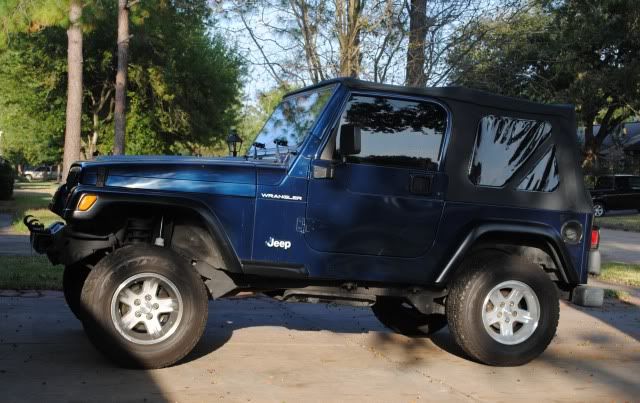

I decided with the 30" tires and the stock suspension now in hand, I would remove the 4" kit from mine and bring the Jeep back down to stock. There is just no point in running 30" tires with 4" of lift; especially if you plan to remove the lift in favor of another setup anyway.
I started with the rear. The PO had installed (or had someone else install) a dropped pitman arm, so I had to order and wait for a stock pitman arm to come in.
The rear track bar bracket was welded on instead of being bolted, so that had to be cut off.
Otherwise, it was a pretty smooth uninstall and install of the stock suspension. The rear shocks had barpin eliminators installed.

Last Friday the stock pitman arm came in. I was able to finish the transformation on Sunday by uninstalling the front lift and installing the stock parts.
Not only did the Jeep have an unnecessary dropped pitman arm installed, but it had a track bar lowering bracket installed. Like the rear bracket, it was also welded in place. More grinder fun .
(In case you are wondering, the bracket is made by Tuff Country and I have absolutely no idea what its purpose is)
The lower control arms from the kit can be fairly rigid. They happened to rip the front passenger side lower control arm mount from the axle. The PO had a plate welded on in addition to having the bracket re-welded to the axle.
When it was all said and done, I had removed track bar brackets front and rear, swapped a dropped PA for a stock PA, swapped back to stock lower control arms, swapped in stock LJ coil springs, swapped in stock LJ shocks, and swapped in stock sway bar links front and rear.
This gets me to how the Jeep sits today.
As unfortunate as it is to be soooooo low and stock, it really is a good feeling basically now starting from a stock standpoint. Every modification from here out is all me. There is a good feeling there.
The good side is that it rides 10x better than it did with the lift.
