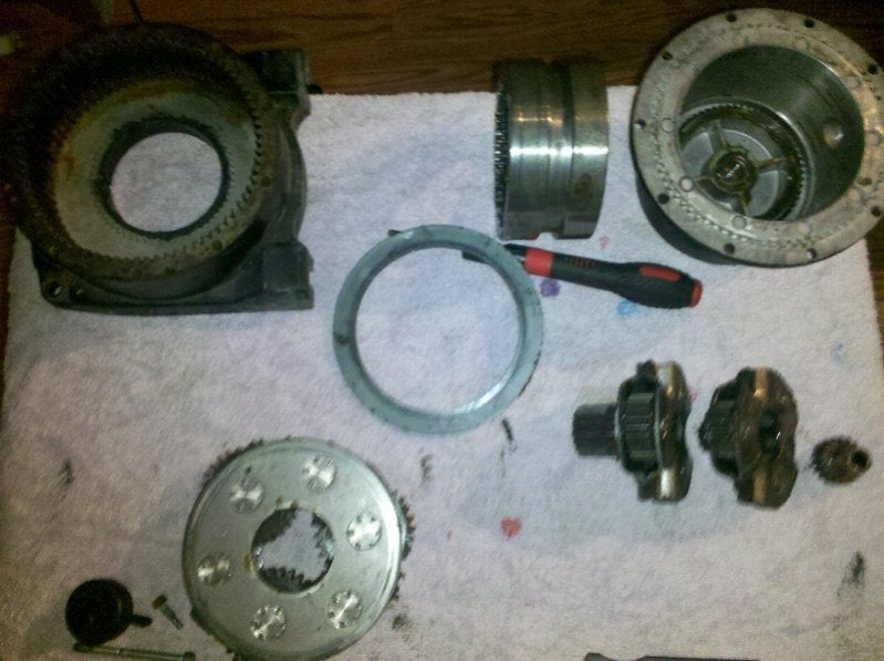

Tore apart my winch today.
Motor is in good condition
Planetaries were dry of grease and starting to show a bit of wear so I greased them and counted the reduction.
156:1 Interesting, seems the only difference between the M6000 and this MX6085 is the width of the drum.
Anyway, seems my lack of power must be coming from the jeeps electrical system. Afterall at #6000 the winch is pulling 450 amps! So I'll redo the grounds, cram a bunch of battery in there, clean up the noid pack, maybe upgrade the alternator, and always carry a snatch block.

Winch is cleaned, greased, and painted.
Here's the planetaries for anyone that was curious.
Sorry about sideways pictures; my phone is ghey.
