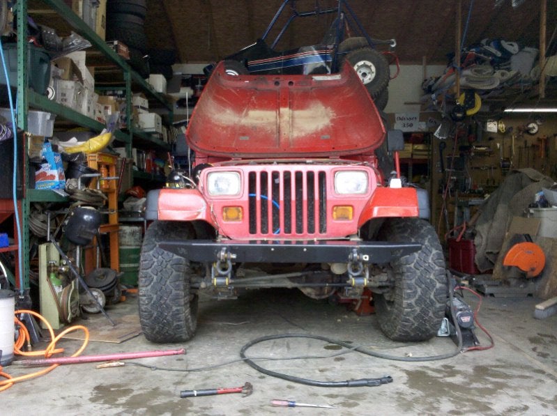

Took off my front bumper and sighed at how bad my frame is.
Went to go mount my surprise bumper and winch to find it was completely impossible and unacceptable.
Did a coin flip on whether or not to get to work and it landed heads.
Here's how I left it. Shackle angles are 65 passenger 60 driver and 27.5" to the top of each frame rail. Should work out okay!
