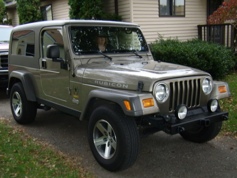

In june of 2010, I found myself looking for a set of wheels for the wife to drive for a while.
I was mostly looking for a wj for her. We went to look at one, but it was sold.
While we were there, she mentioned an lj or 4dr jk could work for her. BONUS!
So looking at wjs went out the window, and the lj search began! Jks need not apply.
I wanted to spend about 15k, and it have pretty low miles. That was tough to find.
Not long after the search began I stumbled on to an auto trader add, at a local toyota dealer.
drove there immediately! They had no idea what they were selling. To them it was just another jeep. They were about to close. I walked in and said "I want the wrangler, here Is a grand to hold it". "Where are the keys, I wanna drive it" . The next day I picked it up for 16k out the door. Every other rubicon lj I saw was over 20k, most near 25k. It was exactly what I wanted! Loaded, dual tops, new kenwood tuner, new tires, and brakes. The best part was, it was traded in the day before, by an older guy from colorado. so no michigan salt!
Here it is at the dealership, the day I picked it up.

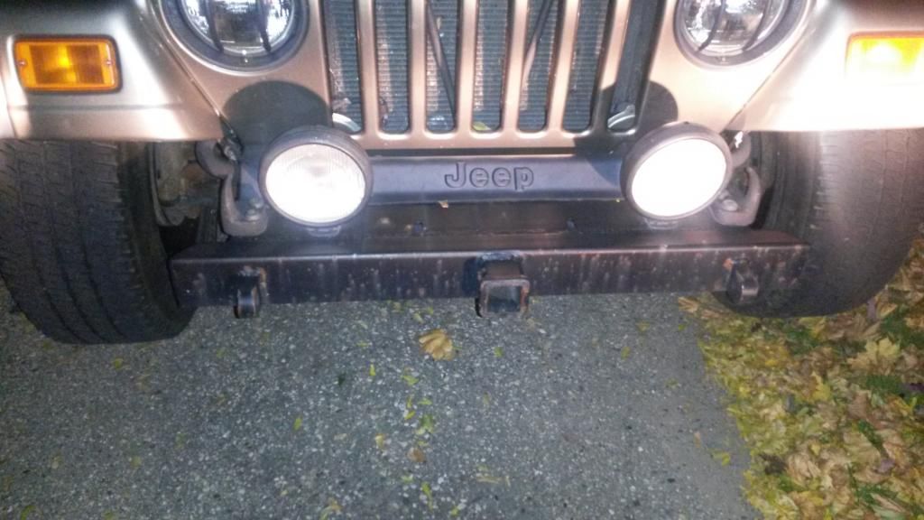

I was looking for bumpers. I did not wanna drop the coin on them though.
Im no fabricator! I have basic welding skills, but never did it much.
I wanted a very stubby front bumper, with 2 d rings, a 2" receiver, and a winch mount.
I started by buying an a to z fab bumper mount kit for the front, but it was a little wide.
I bought a bunch of 2x4x3/16s steel. I then narrowed the mount.
I cut the 2x4 tube to my desired width, then counter sunk the d ring tabs, and hitch.
The hitch and d rings are welded to the front and rear of the bumper, then also the bumper mount.
they aint coming off! I dont have a close up picture in my phone, but here is a pic.
its got a bunch of stone chips in it now. gonna monsta line it, the rear, and the sliders soon.

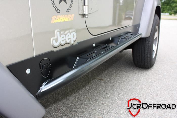

during that time I got extremely lucky! Jcr off road makes some great stuff, and are really nice guys!
They were designing rock sliders for the lj, and needed a test mule for a few days. I happen to have one I can spare!
I dropped off my lj to them. They make, fit, and install a really nice set of sliders with tube steps at no cost!
They really were not free, they are quire a distance from me. I paid for gas. Im guessing about $150 in gas, and a good portion of two days. Definately the best $150 I ever spent! They actually used pics of my rig on their site for advertising.
I usually dont think much of product reviews from people that get free parts, but I really like them!
I guess im a complete hypocrite! Sue me!

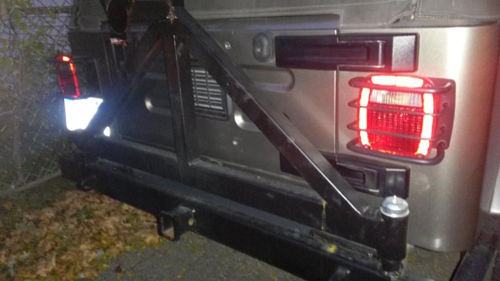

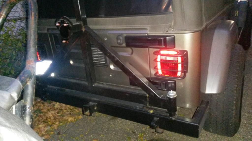

one of the first things i did was start on front and rear bumpers. the front was done pretty quick. the rear took much longer.
i finally finished it (almost). it is mounted, and being used. still gotta get a destaco latch for it. thinking about dual jerry can mounts.
also gotta add a cb antenna mount. it will be monsta lined after all the rest of the changes are made. u will notice on the sides my bumper kick forward.
the extra rear length of the lj in the rear makes them a little more likely to be damaged. it stops at the edge of the rear flare, and is cut at the same angle.
im not sure if i like the look yet, but it is functional, and strong. in the future the sides will be tied into the rear bumper tie in brackets.
i did put a zerk fitting in the dust cap for the spindle so i can grease it easily, kinda like a bearing buddy. the main part of the bumper is 2x4x3/16s steel. it uses an a to z fab heavy duty spindle to support the swing out. the swing out lower bar is 2 x 3 x 3/16s steel. the upper a frame is 2 x 2 x 1/8th steel. it has a hitch receiver, and 2 d rings.
i have pulled about 6k lbs with it. had about 800lbs tongue weight. the bumper did not budge. its a work in process, but it does what i need it to do.
