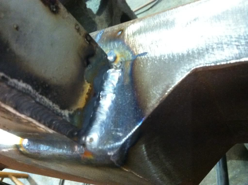

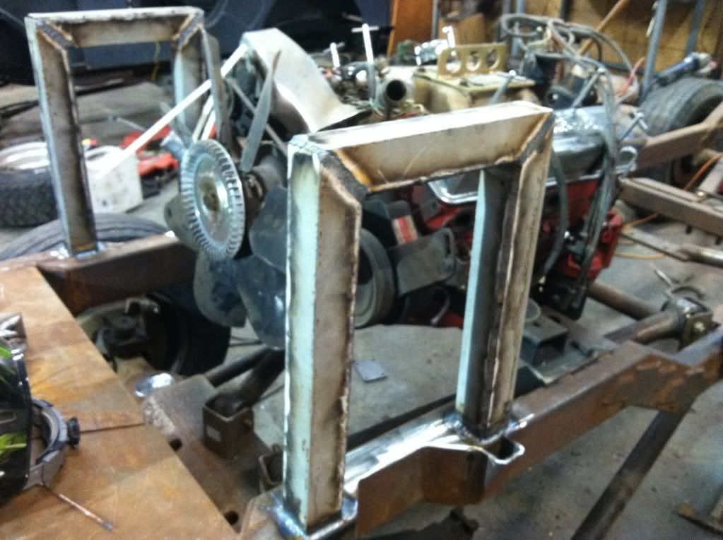

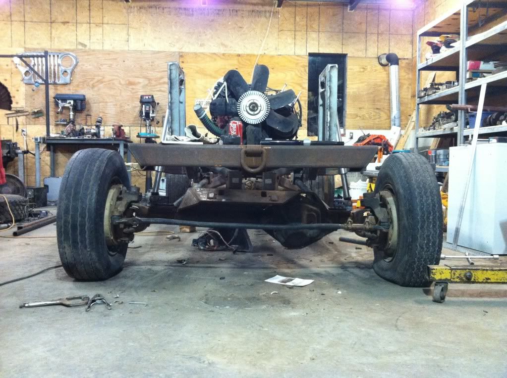

got the entire front suspension on and burned in!!! now gotta finish gettin the 4 link front completely burned in because when i flexed the front to figure out the angles when at full stuff the tacs on one of the upper link mounts broke.

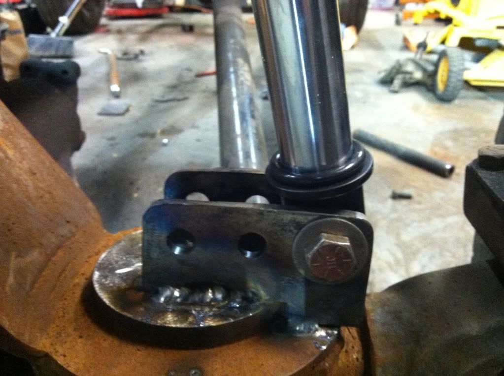

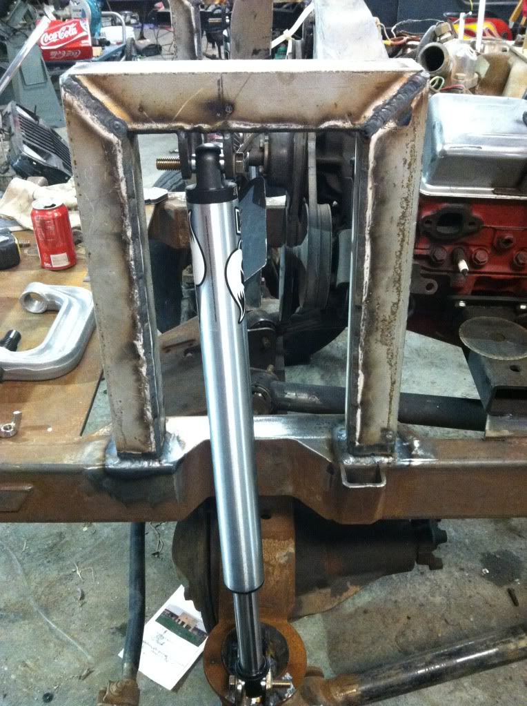

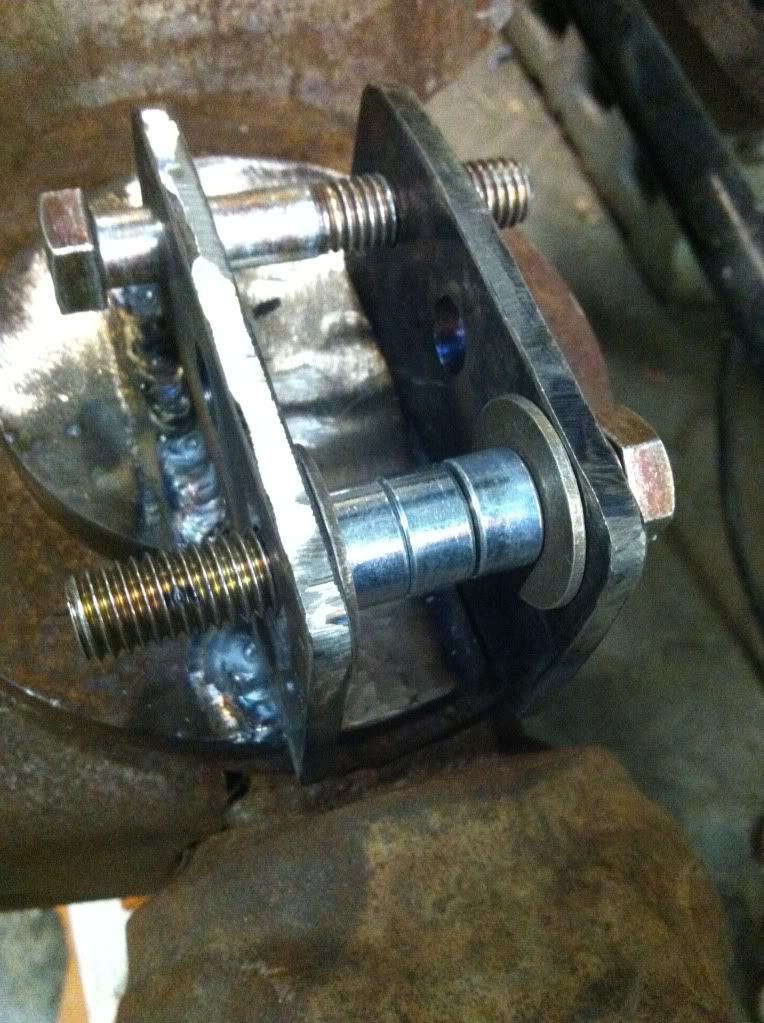

as you can see above i mounted the shock toward the front at the top so it will be perp with the frame at full stuff.
we made the lower mounting brackets adjustable so the angle can be changed and the ride height too slightly. but mostly for the angle at full stuff and at ride height of 10-12*
