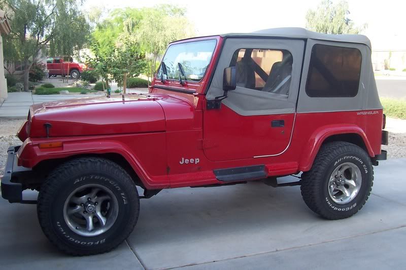

Had this YJ for about 5 years now. As far as I can tell it was originally sold in Indiana, then moved to Kentucky in 2000, something happened and was salvage titled in KY in 04, then brought to Arizona in 06. I originally intended it as a "cheap" vehicle for my daughter to commute to school and I'd use it occasionally for some trail riding. Ha--little did I know! Me and my son took it camping a few times, and quickly decided we wanted to do more.
My daughter named it "Traxx", since he leaves tracks whereever we go (But we do tread lightly, though). Here's what it looked like when we bought it...

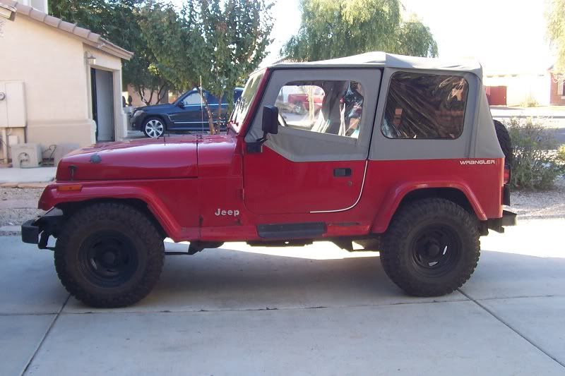

Up to this point we mainly just did maintenance-type items. New exhaust manifold, cat and cat back exhaust, replaced the drive shaft and front axle u-joints, replaced the fuel injectors, and things of that nature. (Unfortunately, the first "mod" that I did was the "hood to windshield at highway speed mod...not the best one to start with!) I have a replacement hood from the junkyard and am slowly working on getting it ready to install. And also need to replace a the busted up passenger fender.
We purchased a new soft-top and replaced the BFG T/A KO's (one got torn on a trip to the KOFA wilderness near Yuma, AZ) with Goodyear Wrangler DuraTracs (31x10.5r15) and new Blackrock Blade 15x8 steelies with 4" backspacing
