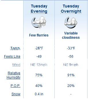

holy *explicit*! thats some cold weather. i thought single digits and teens was cooler but that is COLD! guess i couldn't wear shorts year around there? haha The jeep looks great! coming together well! Also on back to the engine light but no code problem, the obvious thing is the gas cap but Ive also heard of vaccum leaks and air restrictions to cause this. And the forum helps us again heres some options from others http://www.jeepforum.com/forum/f9/he...tored-1123590/
