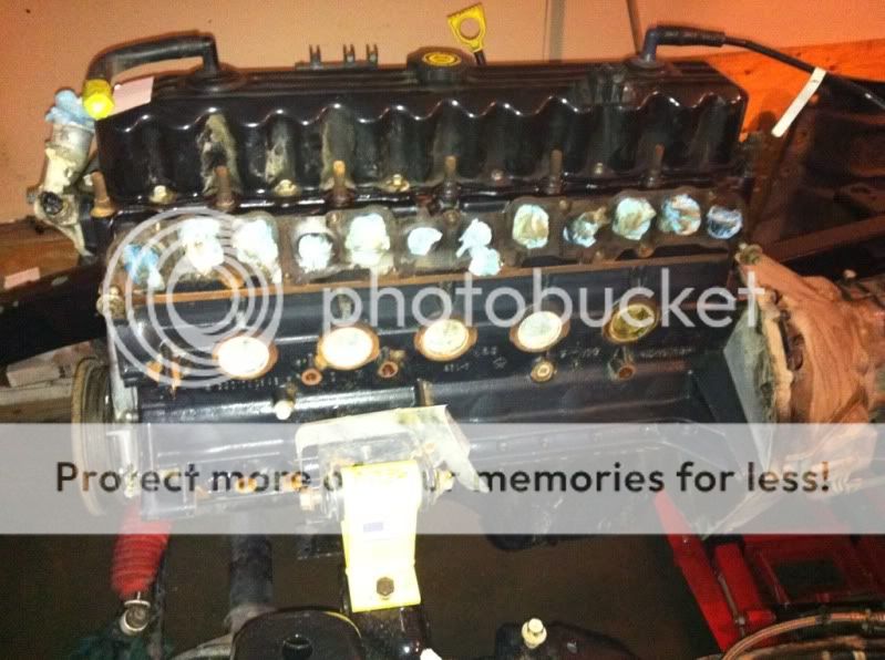

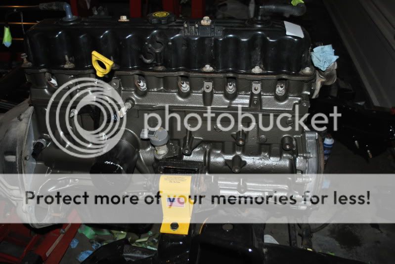

Finally found the time to clean, degrease the engine, then paint it.
De-greasing was quite a pain in the ***, but it was worth it.
The list of things to do before I can put the body on:
- Fuel Pump
- Stripped bolt on T-Case
- Brake/Fuel Lines connected
- Wiring connections
- CKP sensor replaced
- Top-coat frame
I think that's it.

The engine looks incredible painted like that.

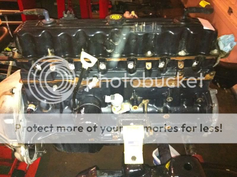

It is pretty sexy.

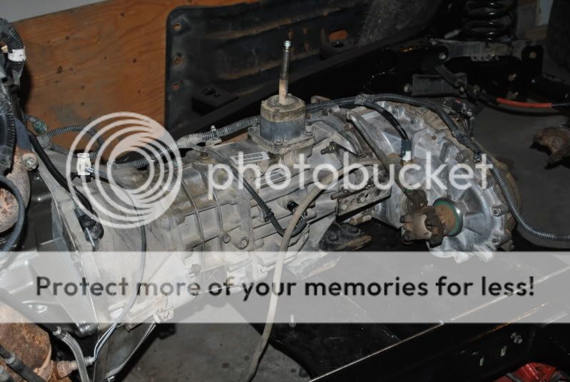

Little Update:
Got everything put back together. Got a new CKP sensor, water pump, fixed t-case and now I'm just waiting on the fuel pump.
Link to the whole album:
Rebuild Project
Have to fix yet another stripped out thread, this time on the transmission where the CKP bolts to. One was perfect, the other just decided to let go.
Quick fix.

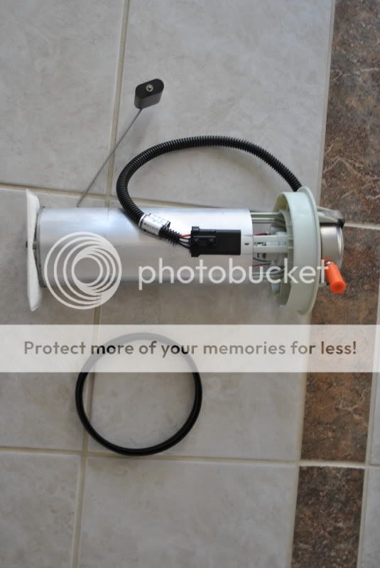

Update time again:
Fuel pump arrived today. Installed it right when I got home.
Also painted the bottom of the frame with a rubberized coating. Solid stuff.
You can see where the old pump broke.
It's getting closer.

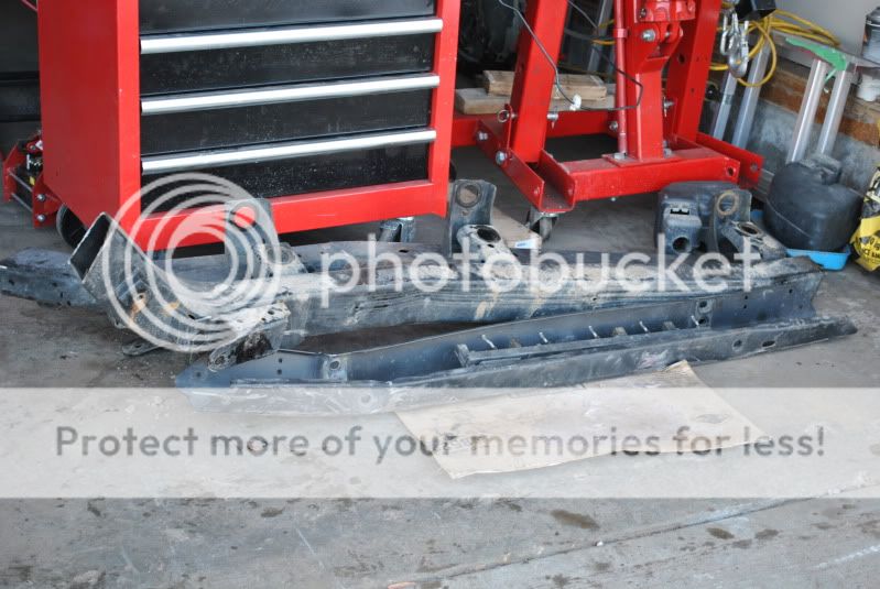

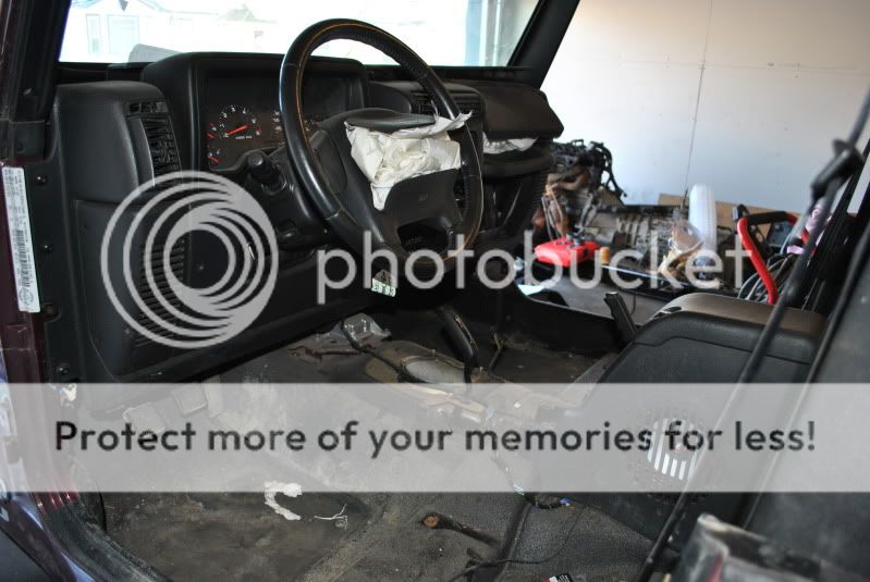

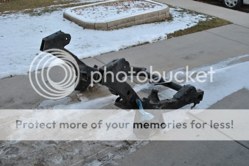

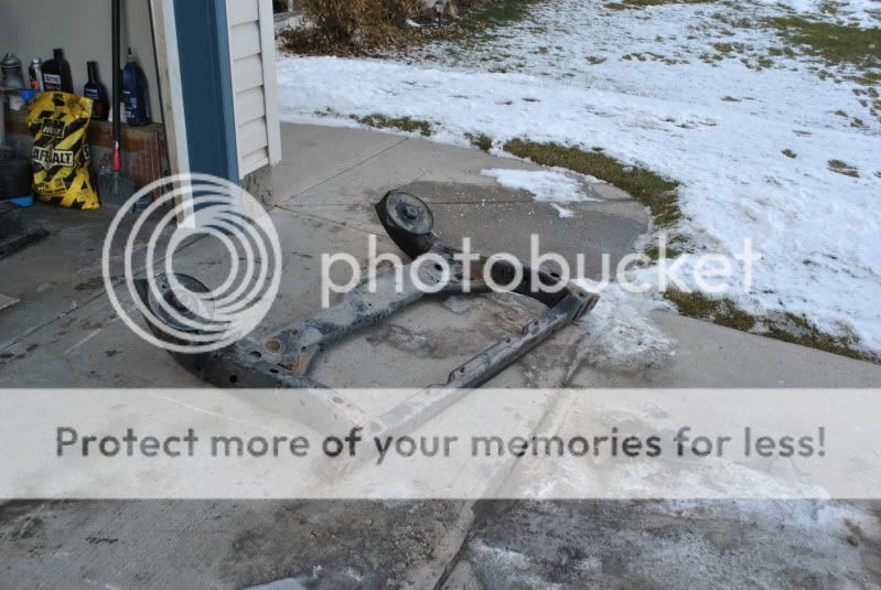

Posts: 863
Update time again.
Did a good amount of work today, with the help of my dad, was able to get the following done:
- Removed old frame
- Cut frame into pieces
- Gutted the interior
- Put body on stands
Just need to do a little body work, fix a few things then I can swap it over.
In the meantime, I'm going to get the airbags out of the way and replace those this week. Just need to get that damn steering wheel off.
Also going to paint the rear calipers, diff cover, re-install the brake lines on the 44, and torque a few more things down.
Sienna Pearl Coat Club Member #24

Air bags are done!
