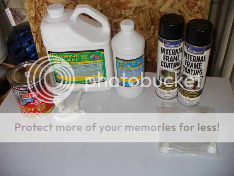

Already started with the wire wheel, thing works wonders. I would, but I already ordered the Por-15 kit. Just have to get my prep right.

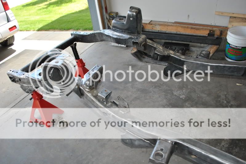

Little update:

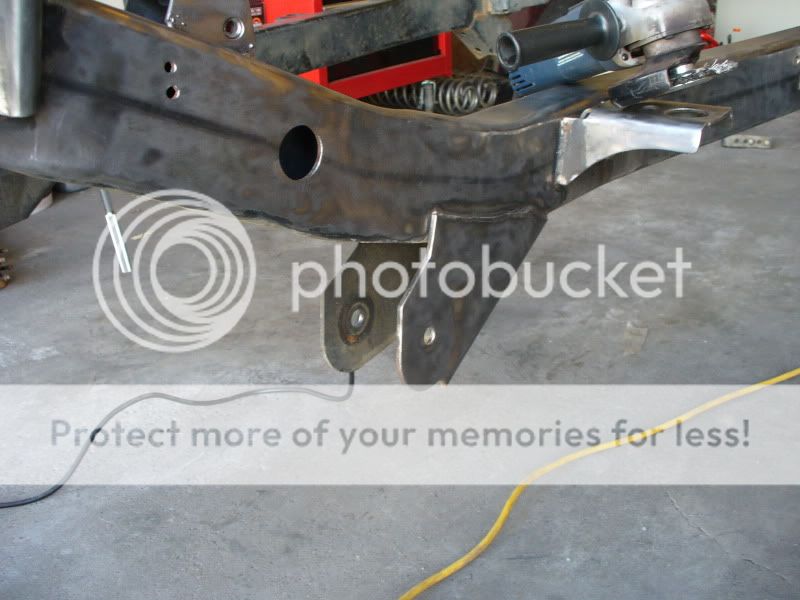

Been working on the frame the last little bit, almost done half.
Does this look good enough for the Por?

From what I've read if you aren't applying it to tight rust then you wanna make the metal as rough as possible, I'm pretty sure a 60 grit sanding disc should do the trick (that's what I've been using). You definitely don't want smooth metal as the paint won't have anything to grip to, for mine so far I've just sanded the factory coating til its rough (not down to bare metal) and also removed all the loose rust rust but left the tight stuff...should be starting applying Chassis Saver this week

I took your advice, and bought some 60 grit sand paper, been roughing up the frame afterwards.

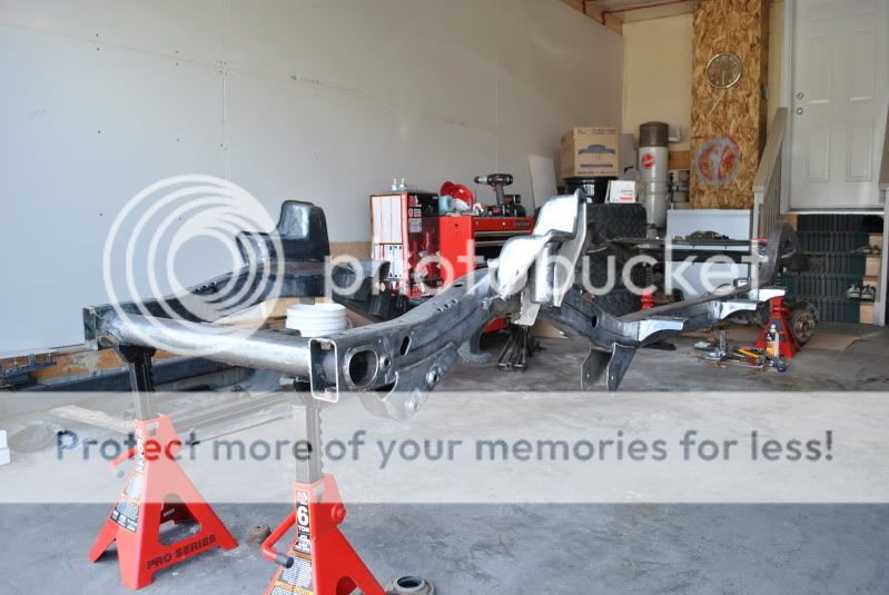

Update:
Frame is pretty much ready for por-15. Just finishing up the scuffing in a few areas. Afterwards going to wash and do the degrease and metal-ready prep.
Sorry for the slow updates, been working a lot. More work=More Jeep parts

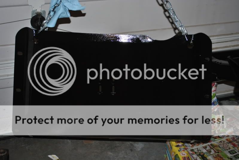

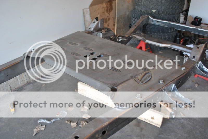

Also got my UCF skid plate today. Thing is pretty sweet.
EDIT: In the end, I wish I would have just gotten the frame sandblasted. Wasted too much time and money with ****ing wire wheels.

I think you've got it upside down , seriously though, it looks good

I knew something was wrong...
