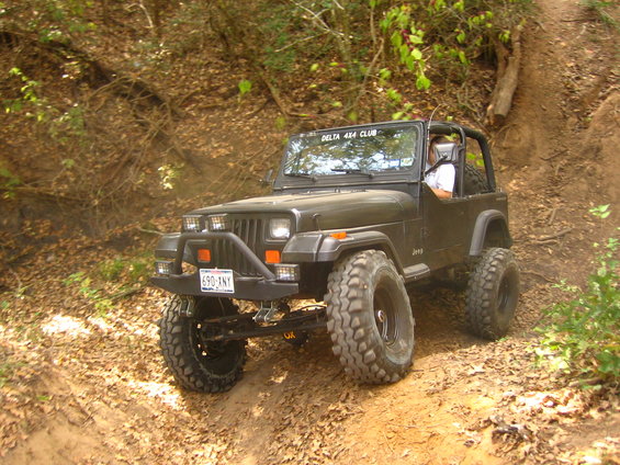

post #27 of 892 Old 11-11-2007, 12:43 AM Thread Starter
Tommy R
Tommy R's Avatar
Location: Austin, TX, USA
Posts: 1,604
Went wheelin' today in Bastrop with the local Jeep club. Really tight, very technical trails...
Pics are right here.
Here's a few.....

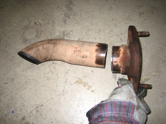

Posts: 1,604
I made mine a lot louder. Cut the muffler off and welded in a turndown to make clearance for the triangulated 4 link I'll build....hopefully soon!
Re-used the OEM flange and tailpipe:
It's too loud and "trashy" sounding to keep fulltime, but for the interim it'll work until I can determine how much muffler clearance I'll have with the new suspension.
Tommy
