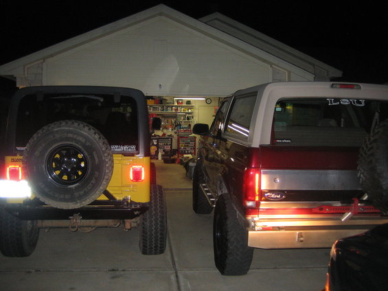

Here it is next to the Bronco it was about to replace...

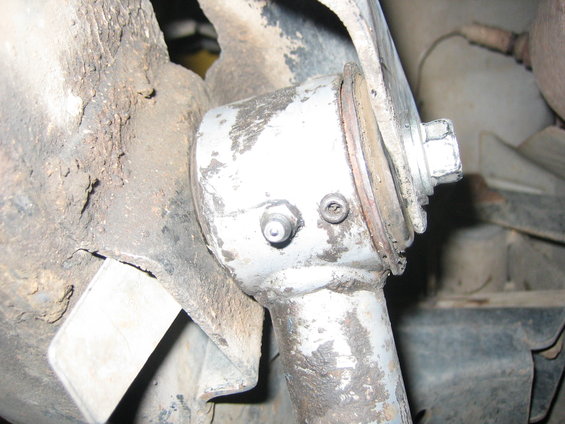

I replaced the front lower control arm bushings and noticed that the bolts for the uppers were a bit smaller (.100") than the holes in the chassis. Thinking this might be contributing to my DW I made these shoulder washers...
Here they are installed (barely visible under the bolt head):
They helped, but the DW still pops up from time to time, just less frequently.

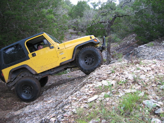

It was mid way though the day I noticed the Jeep was doing the "spool lift" pretty badly. It was at a break area that I noticed my rear sway bar endlinks (PLASTIC!!) was broken so I was running with no rear bar! Given the off-camber situations we were in that made for some very, VERY scary moments.

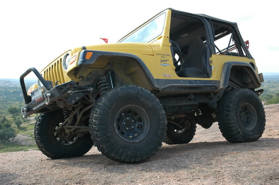

Here's a pic showing how the Jeep jacks when taking a tight left hand turn on a grippy surface like granite. I'd turned the wheels to the right in an effort to flatten it out before we got out to have lunch:
Scary as hell!!! Especially when you consider I was only half way through the turn at the top of a mountain with a steep drop off.
Fortunately, I managed to get through the day without rolling it.
