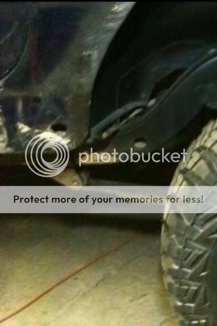

Gribbles... I need a few good pictures of yours or Smokes front frame spring mounts for Reference. I am building my own so a few pictures would help.
easy man. they are ruffstuffs xj leaf hangers - mine don't have the little slider though that they've included, must have added that recently. Its a good idea tho.
mounted.
Smoke mounted his facing the other way, but isnt thrilled about it - works more like a slider this way.
Its the only decent one I have - if you need more I can get a couple for ya when I get home. Good nuff?
are you going with a BTF rear xmember?
mounted.
Thanks, maybe easier to buy them then. Nope, going with frame mounted like Kyle's TJ. With 1" YJ shackles.
Just get about an 8in piece of 2 2/4in i.d. box tube, cut it diagonally and bam! you have 2 spring hangers. That's how I made mine.
Ya they are cheap - who is this Kyle and does he have a build thread?
I'm running the same ones. I'm happy with them.
