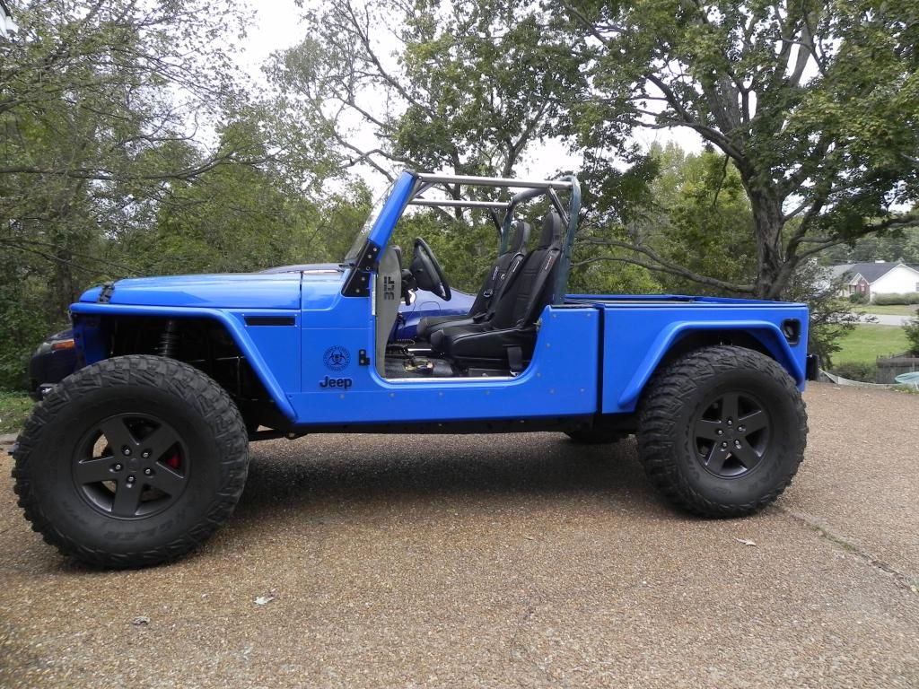

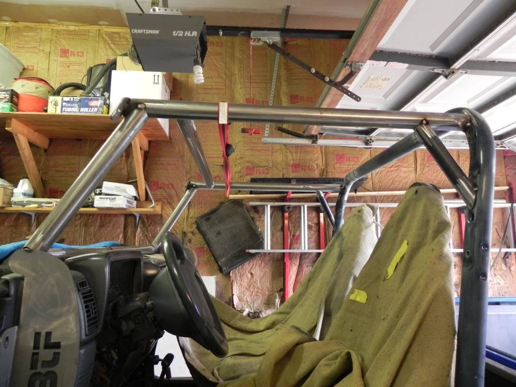

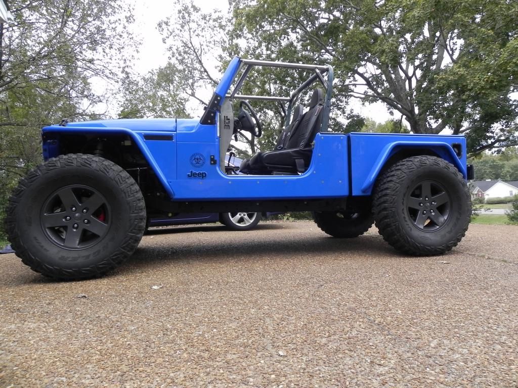

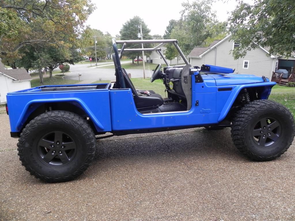

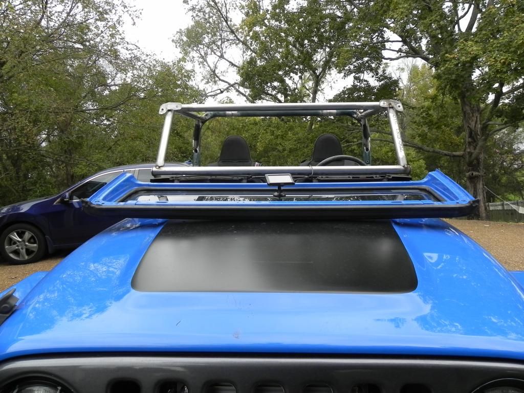

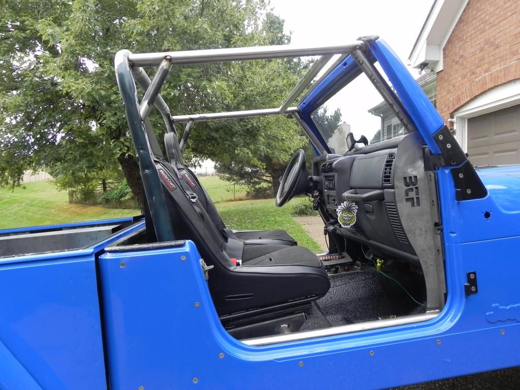

I spent most of the day trying to finish up the cage. I started by adding the windshield tubes and gusset to the spreader bars. Then spent most of the day trying to remove the cage. And Failed. Never again will I build a cage with sanctions and a stock B pillar.
This one will get painted in the Jeep I guess. I cannot figure out how to get the cage to move past the braces for the door latches now that its all one piece.
Next cage that I build in the spring will be through the dash and custom built to look like the half cab is there even when its not along with a double B pillar design in the cab. And a full cage in the bed.
Here are a few pictures.

Awesome!
Are going to wheel with the rear that low?
ashland82391 is offline

Use ratchet straps to pull in the ends of the cage so they clear (unless, of course, you have the cage running under the seats, then this won't work). I have to go back and follow the wheel-well to clean, you kinda cant do that, though.

Awesome! Are going to wheel with the rear that low?
not a chance, if I do not raise it a little I am going to high line the rear flares to match the front.
Can't to that, the seats are mounted to the cage with tubes running across the tub. I can cut out the door striker reinforcement to get the cage out, but I really do not want to do that.
