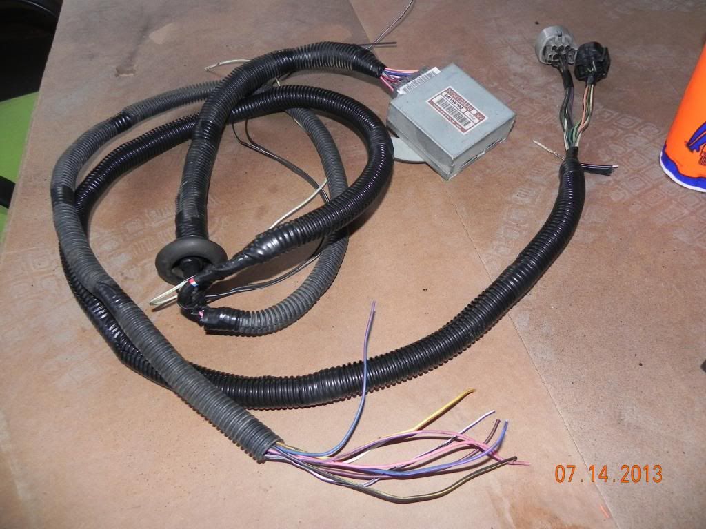

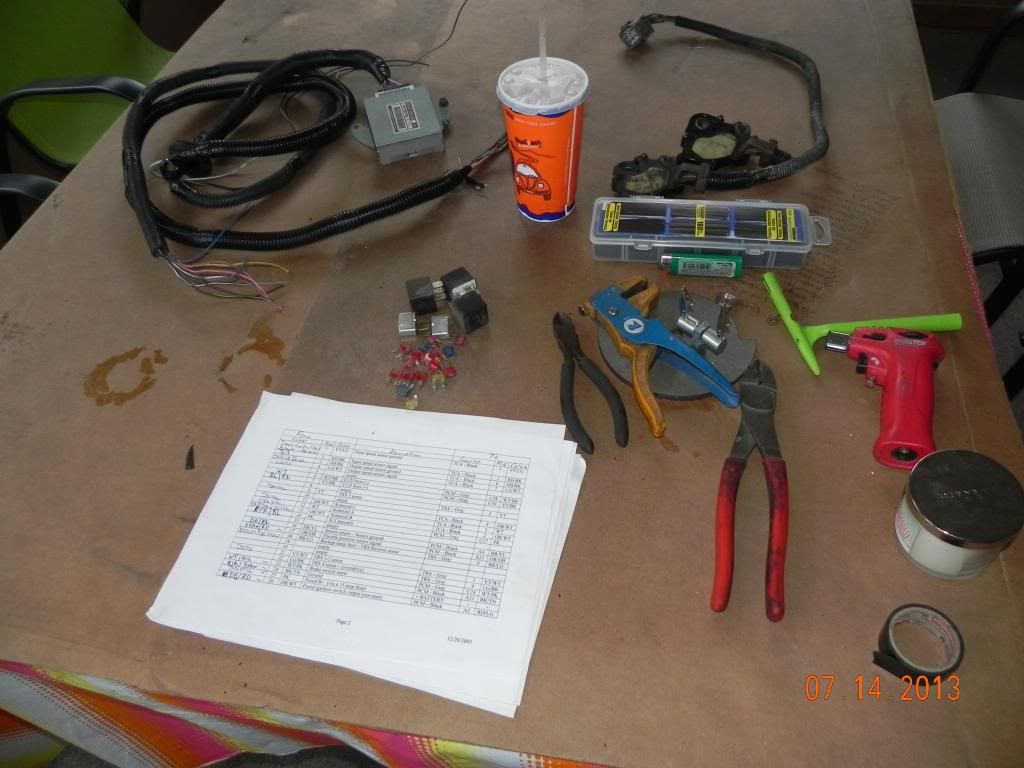

Here we go guys, we finished the harness today all but attaching it to the Jeep.

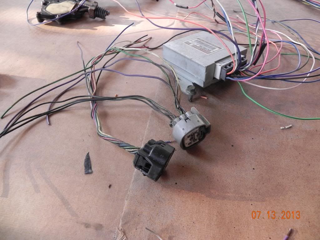

Standard parts needed to do the harness. Black trans plug, Gray Trans plug, and TCU.
Start out by figuring out the wires that just get connected back to the gray and black plugs. Should be all but 12.
Then solder the splice wires to the TCU. I tried to stay with the proper colors. I salvaged enough wire from a junk harness to get almost all the right colors with marker stripes to do the Job.
Necessary tools required to do the Job.
Finished product.

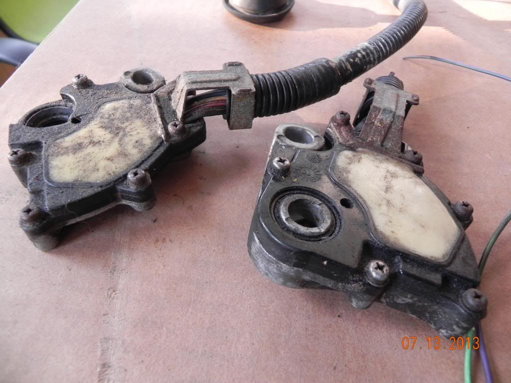

Still need to transfer the harness from the electric shift selector thingy over to the good selector thingy.
Thats about it. I am just about over this stupid cold. Maybe I can get some real work done next week.
