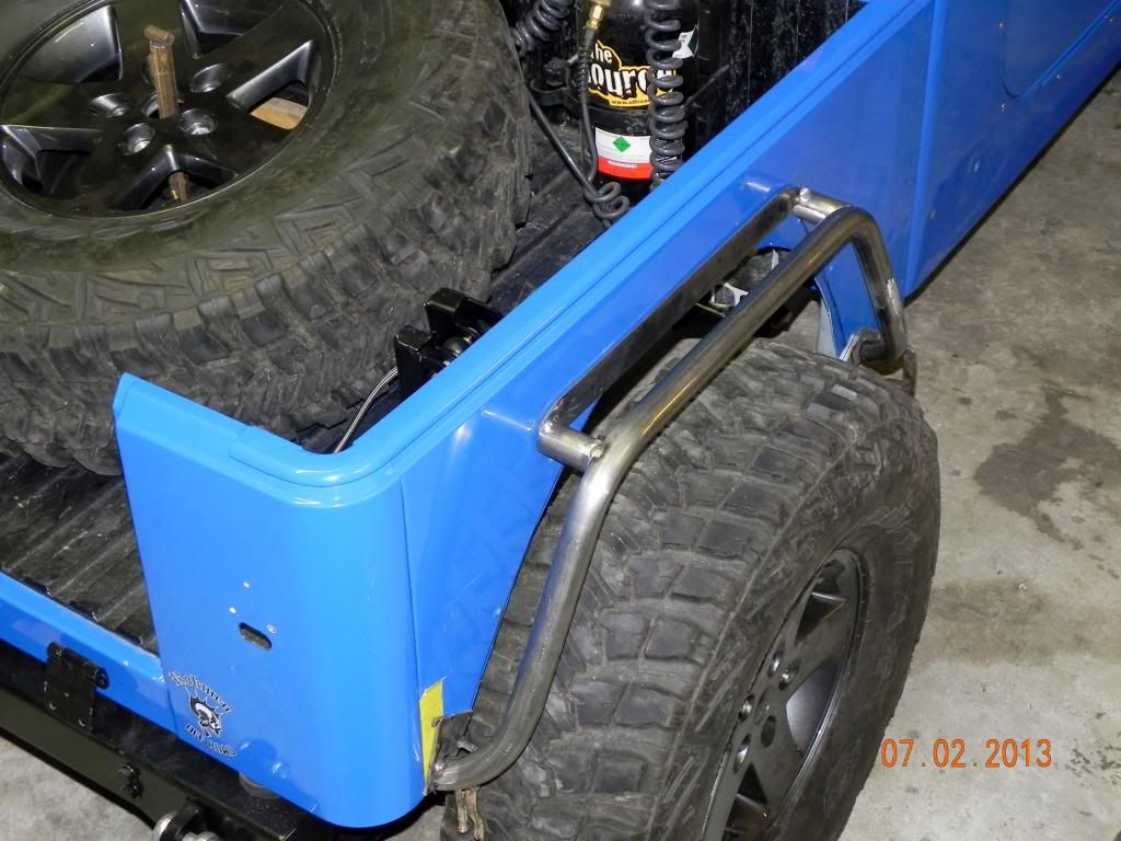

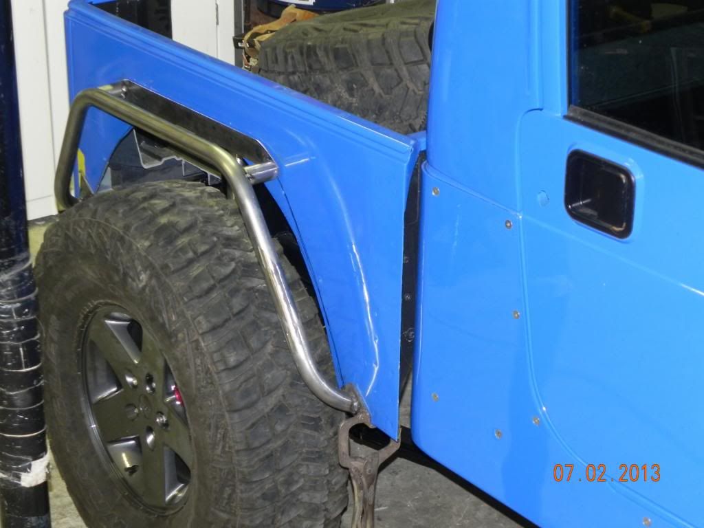

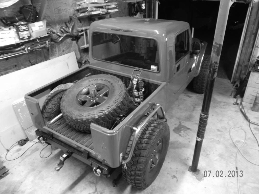

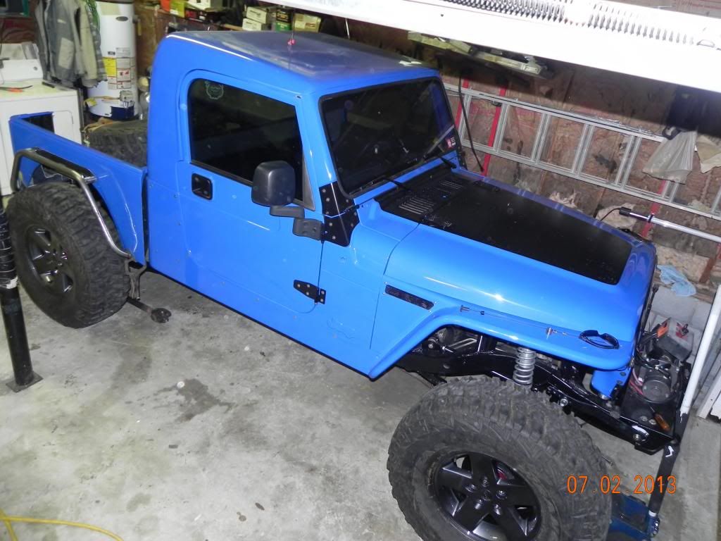

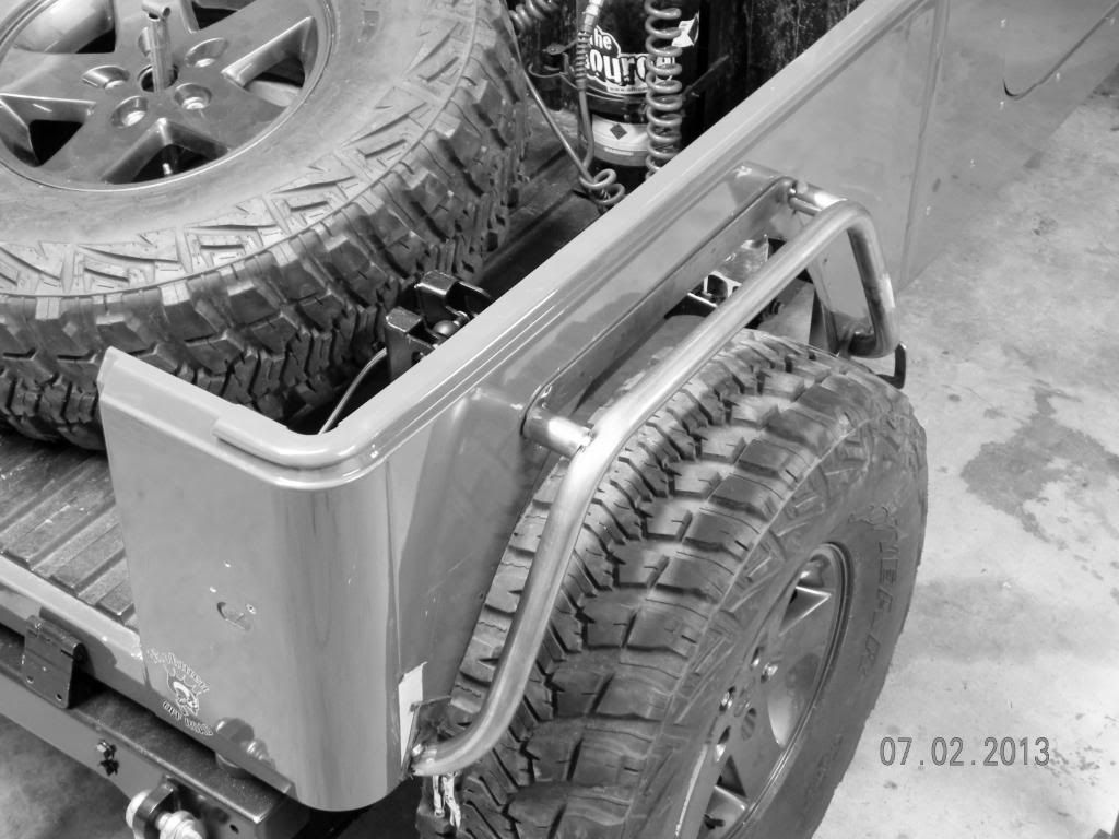

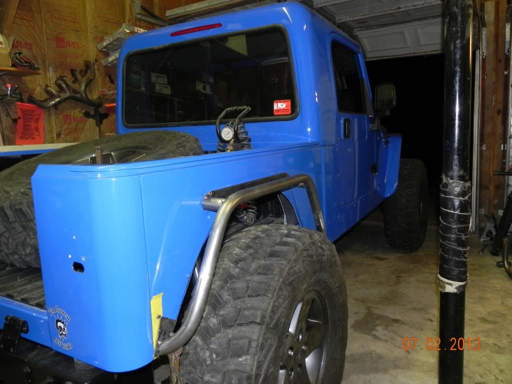

Here's that update guys.
The flares are bolt on Kyle, I was thinking about welding. But incase of an accident I want to be able to just replace them separately.
I just need to extend the driver side then the flares are ready to skin.
I used the black a white to show the flare better. To me the blue was a little distracting.

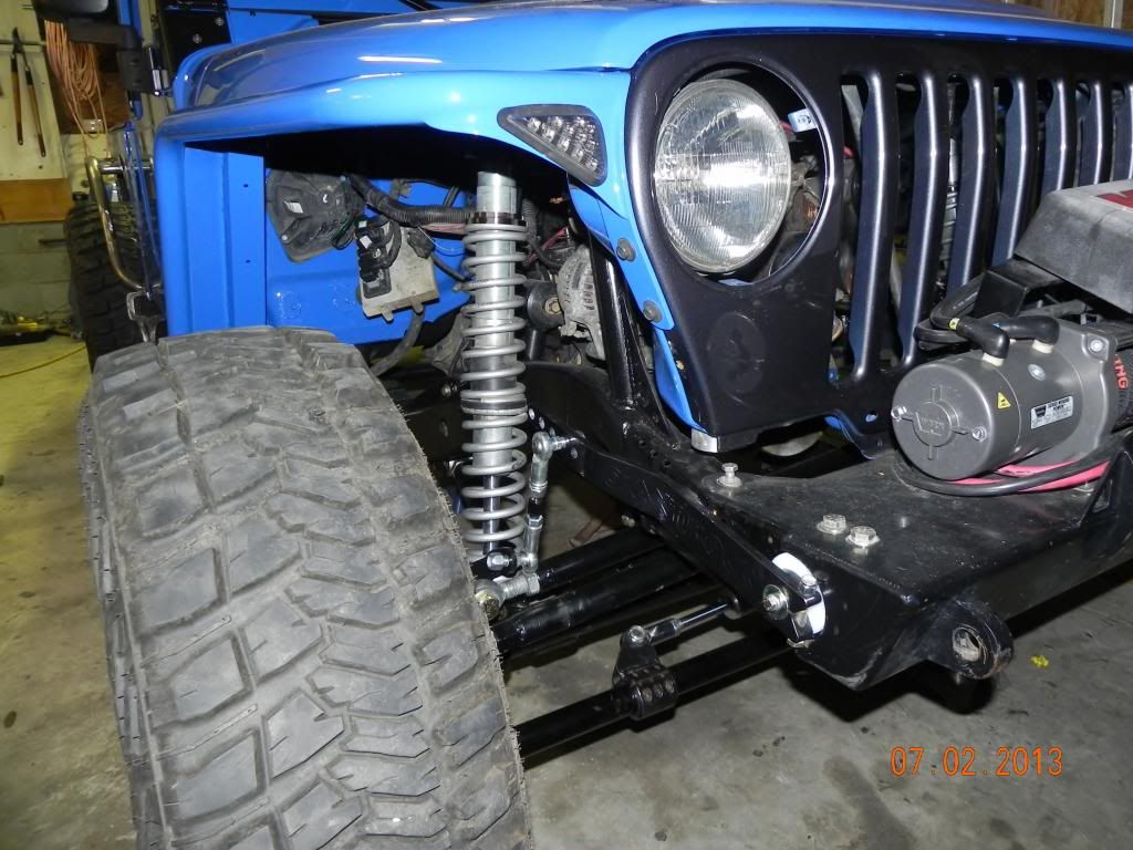

A few from the front.

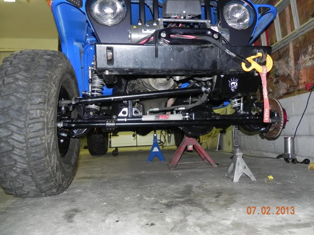

Back to the front end, everything is finished except bolting up the DS, adding fluid, and torquing all the bolts down.

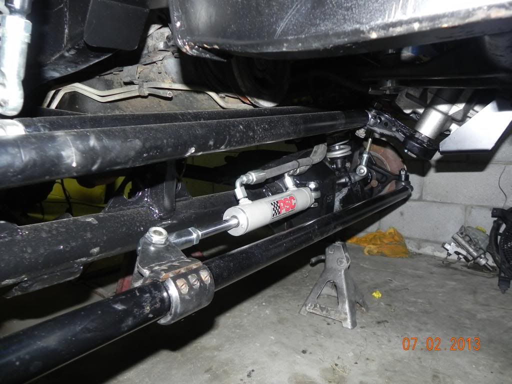

Some sexy steering.

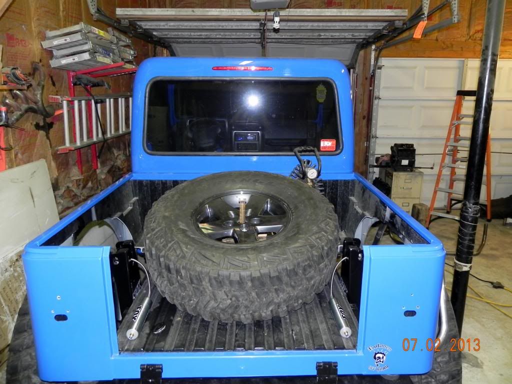

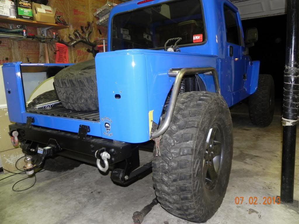

And a few more from the back. Spare in location, I just have to cut the hole through the floor for the mount.
Some sexy steering.
drool! I love it! Makes me hate my Jeep lol

From what i can see of your steering, Does your pitman arm clear the tie rod at full bump on both sides? Looks mighty close. Cause mine used to hit when i turned until i flipped the heim above the pitman arm. Obviously you can't do that though.
No chance at all of the pitman arm hitting anything. It's just an illusion. There's not enough up travel to get the tie rod up that high.

Very nice work Hendrix! Maybe off base question but have you considered a tire carrier or baja style spare carrier to move the spare back further? Might help balance the rig out a bit better, make it a bit more proportional and give your more usable bed space. Keep up the good work!
I could bring the spare back about another inch with the Rokmen tailgate. I did think about a baja style carrier without a tailgate, but not real practical. thanks.
