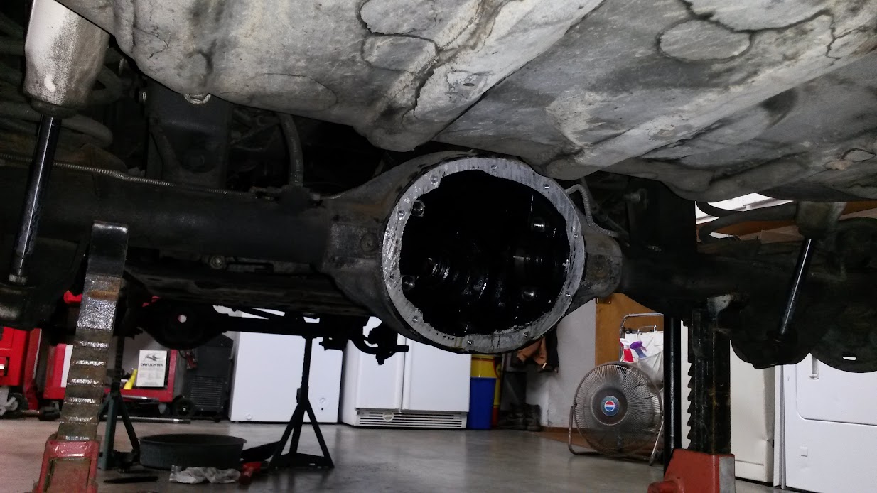

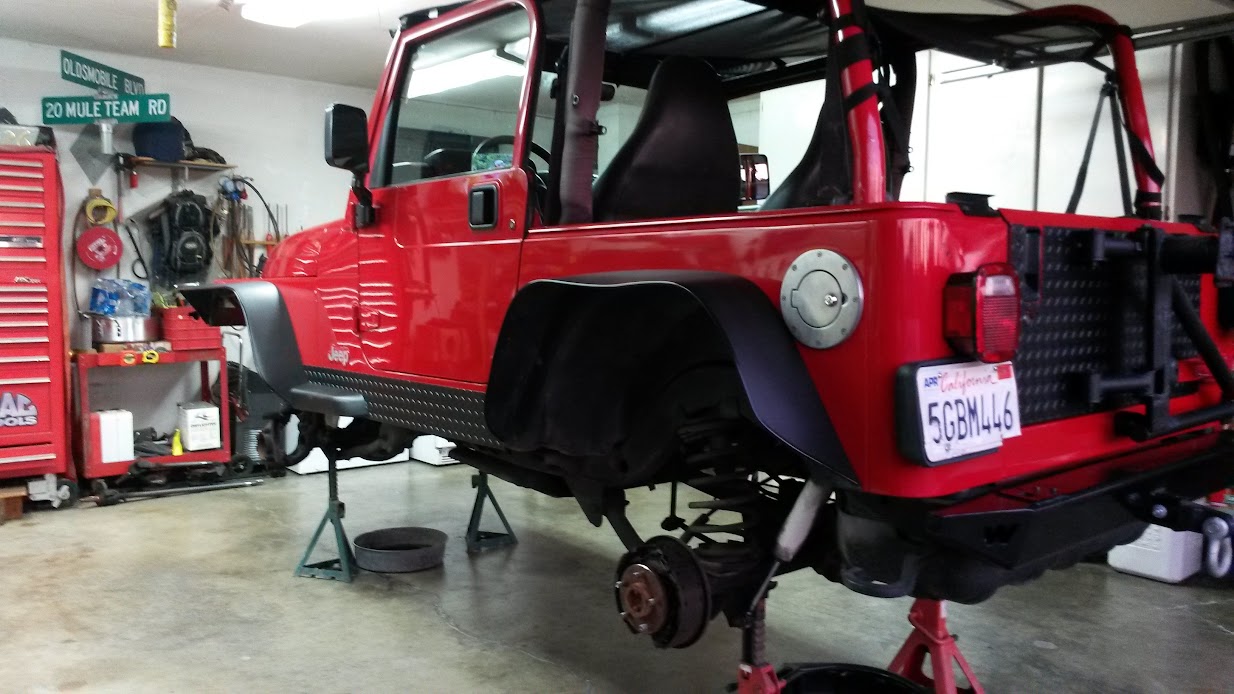

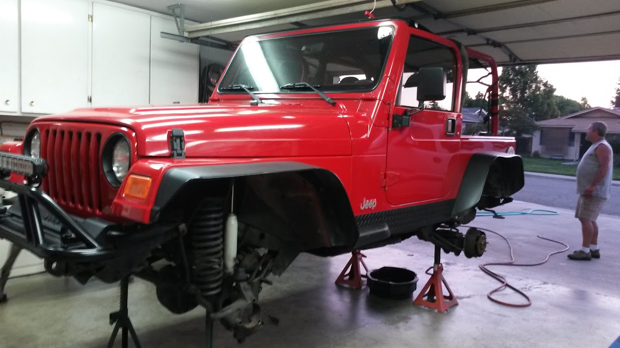

Starting the tear down at my dad's. I couldn't do the gears without him, he was a Chrysler Tech for many years. He was also the only local Viper tech, I got to go for a few rides in those before he left the automotive industry. I can tell you for sure, even the older Vipers were no joke. I remember tires spinning as he shifted into third getting on the highway and shortly thereafter seeing the speedometer climb above 120. Definitely get your heart pumping.
Borrowed a spreader
We got the rear end all buttoned up Saturday afternoon only to notice that we somehow installed the front pinion setup bearing in place of the new one. So after calling around town looking for a crush sleeve I decided to order another one along with a seal from Summit. (they have been really quick in shipping my parts, I got all the gears and lockers/ posi through them. I couldn't find any 4x4/ Jeep websites that could beat their prices either)

Over the weekend the Jeep got quite a few new parts thrown at it.
My dad gave me my Antirock birthday present early and we got it installed on Friday night. Then on Saturday we worked on the control arms, I bought the lowers and he got me the rear uppers so we could get rid of the transfer case drop. I was very impressed with the Savvy double adjustable arms, they worked out really well.
Started out on the front lowers and got them installed. My dad wasn't very happy with the slotted holes so he ended up ordering a set of the washers from Black Magic. Figure we will install them when we weld on the front control arm bracket skids.
Then we moved onto the back, everything went pretty well on the back other than it was kinda tricky getting a drill to fit up under the chassis to drill out the upper bracket holes. Ended up using an air angle drill my dad had, but we had to modify the drill bit to make it fit.
After we got the control arms in we started working on getting the transfer case drop out. One of the nuts inside the frame broke off so I'm running with 5 bolts for now. Anyone have a good fix for a broken off transfer case nut in the frame?
Ended up running about 2 deg in the rear driveshaft to get rid of the vibration. Had the lowers adjusted about as short as they go and the uppers were extended a bit to get there but I think it's all fine. One of these days I'll take the springs out and cycle the suspension to check the bump stops.
After getting that all sorted we started looking at what makes some of the clunking noises on the jeep. I think its mostly the shock bushings are worn out, but we also noticed the track bar moving again. We dropped it at the upper mount, decided that it doesn't have a tapered hole to match the stock track bar that is currently in it and again my dad ordered me a Metalcloak replacement out of frustration with the old one. I like it when he does that, sure does speed up the build process.
Not a lot of pictures of the action but I'll post a couple of after shots.
