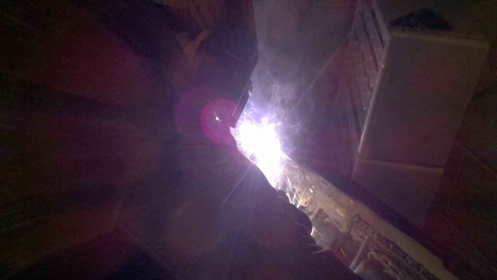

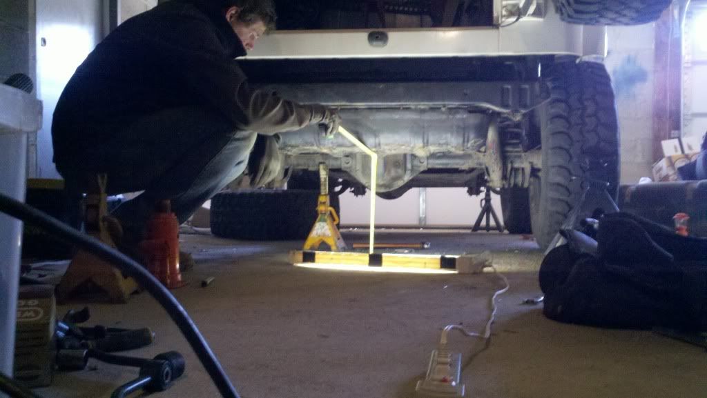

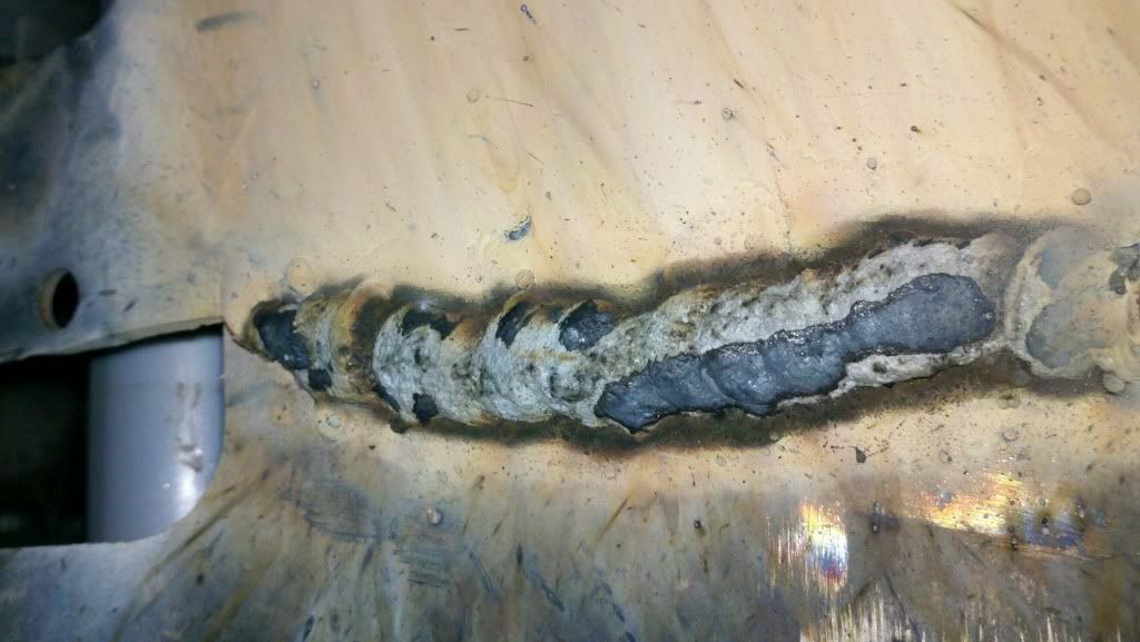

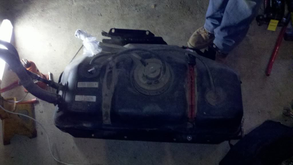

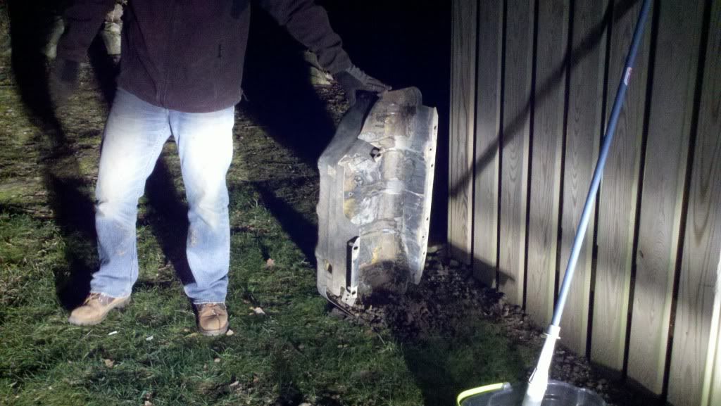

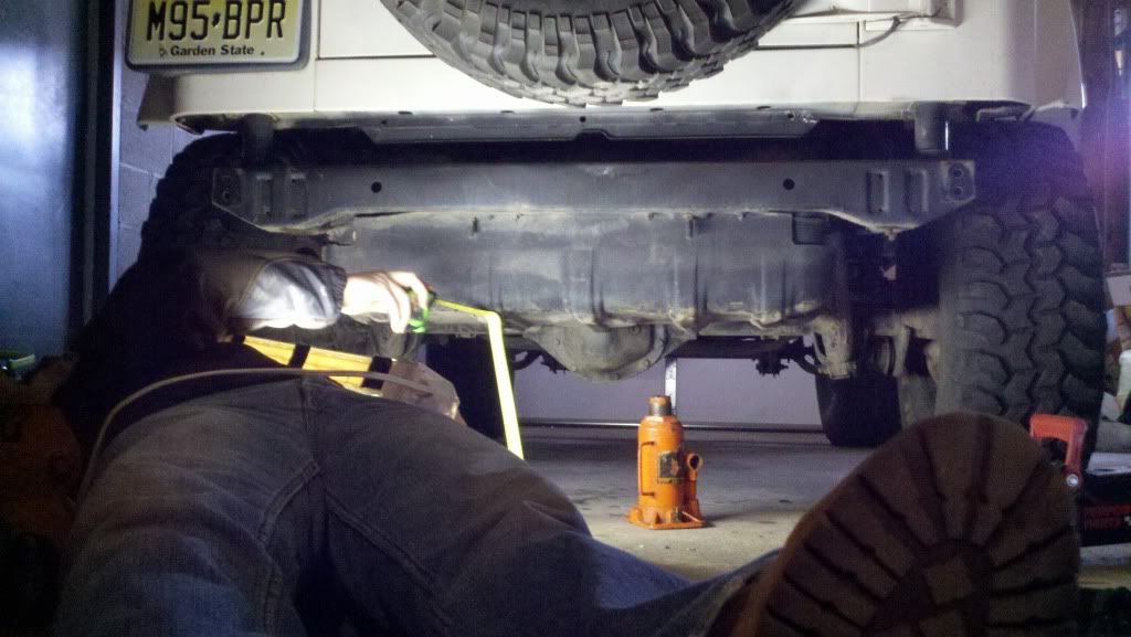

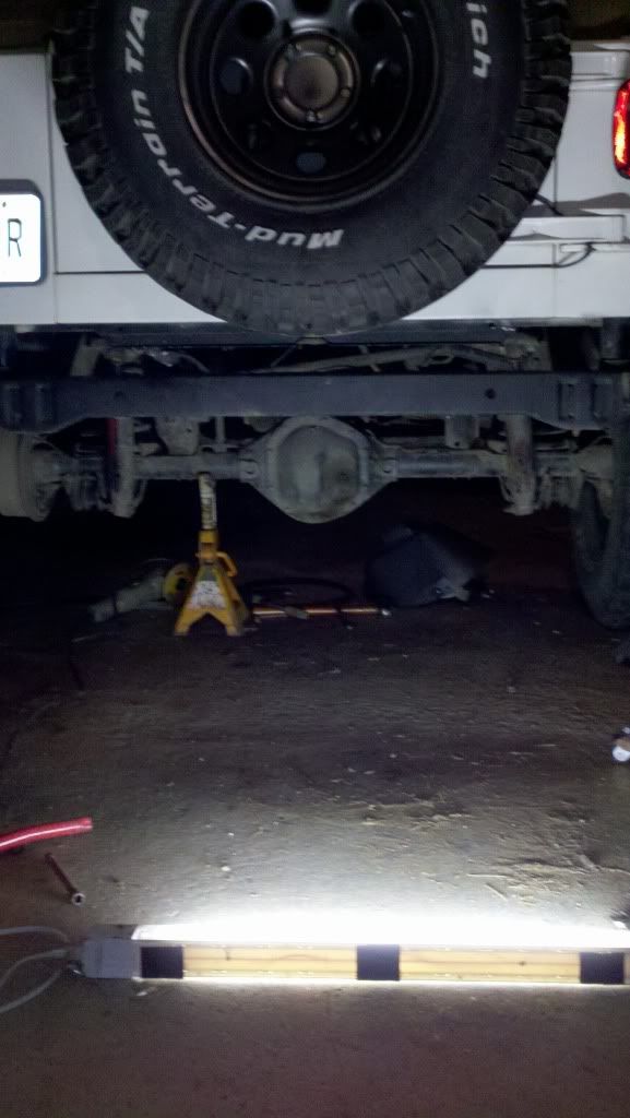

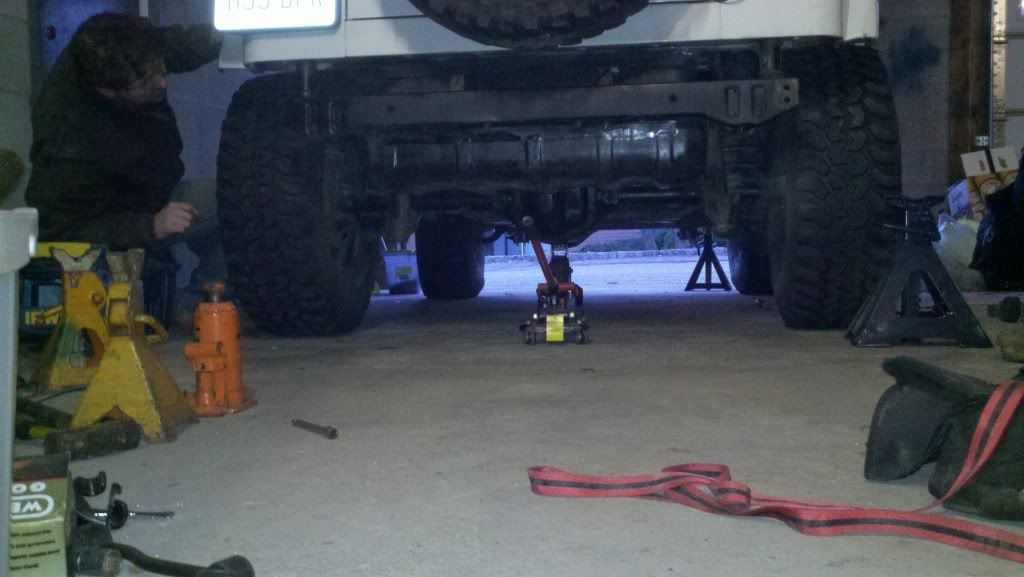

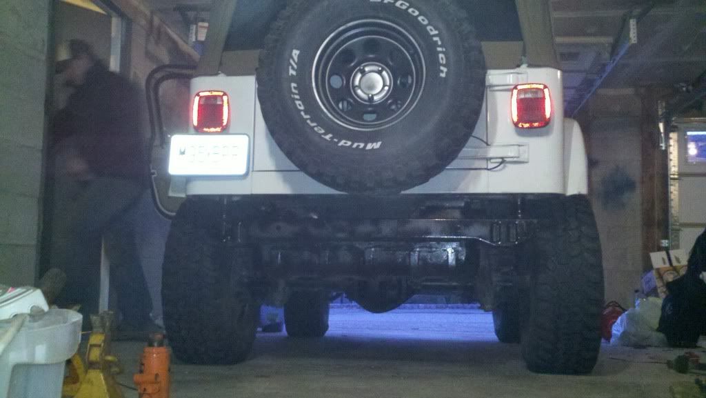

A few Problems along the way. the tac welds that hold 3 of the 7 bolt head heads broke. So in order to get the tank off i had to tac weld them back. in oreder to get to the one on the front of the plate i had to cut a V-notch to get to it and weld it back.
*BTW I gain 2"s of clearence*
tape is at the bottom of the tank sitting at 14"s of clearence
tons of mud and sand caked in the pan.
Clearence with no Tank
Please dont pick on the welds. its been 2 years
letting out frustration. lol
Chris getting a pic of me welding
Test fit. All Lined up. Tape now at 16"s
origional straps broke. I-bolts and rachet Straps works well. Didn't need it though. The tank is in there nice and tight.
Finally finished. Notice you can see the axle tubes now.
