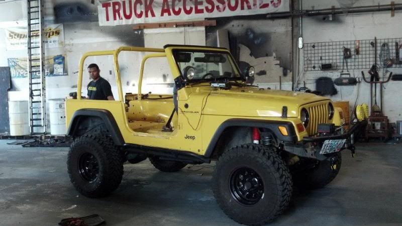

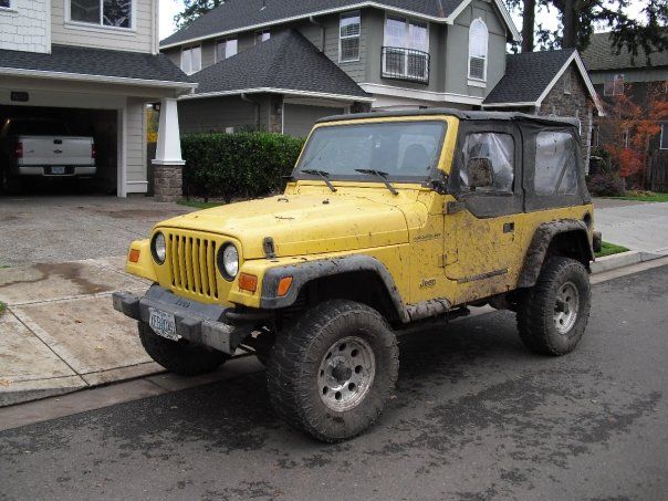

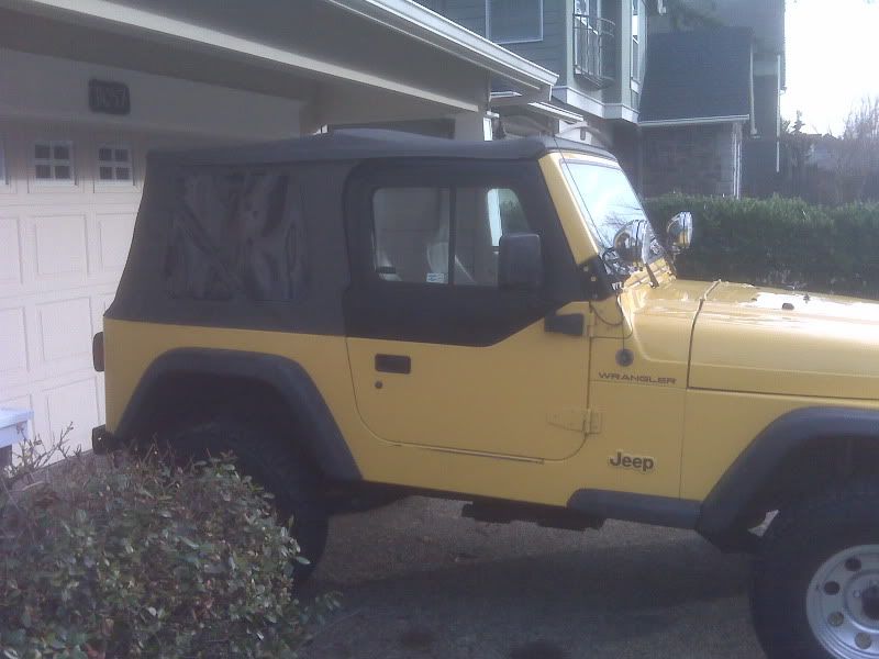

This is shortly after the rough country 2.5 lift and removing the front bumper caps, and painting the headlight rings. Also got a hold of some uppers.

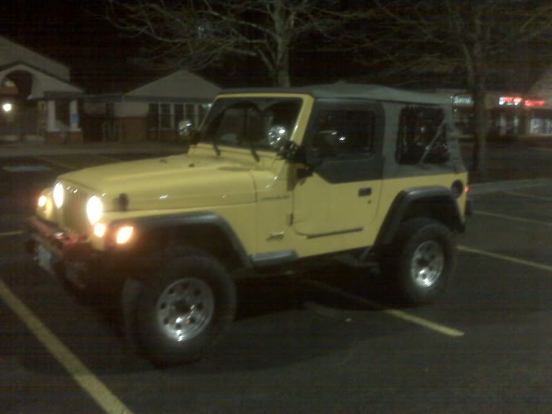

New fiberglass uppers and new sail cloth soft top.

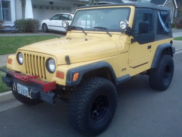

New 33inch BFG MTs, traded my trxus dune grapplers plus 125.00. Also bought some mounts to mount thee hilift to the front bumper along with some harbor freight d ring mounts. As well as a 3/4 inch puck added to the front and rear coils to get 3 1/4" lift.

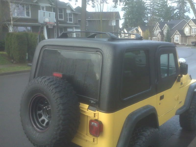

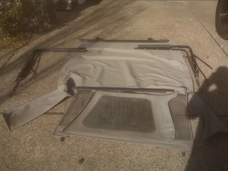

Found this hardtop on craigslist for 500.00. It was some wierd aftermarket one with rails and a sunroof. It felt kinda flimsy and didnt seem as solid as the factory one. I also wasn't really too big a fan of the windows. Once nice thing about was that it was carpeted. Sold it after about a week or so on my jeep for 1000, plus a light bar, an older soft top and some lights!
I ended up buying and selling a total of 5 hard tops some of them needing a little bit of work others needing none whatsoever like this one.

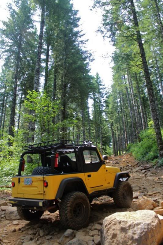

Buying and selling a variety of jeep parts has been how most of this jeep is funded... Buying hardtops in the summer selling them in the winter, repainting them re-fiberglassing small surface fractures things like that.

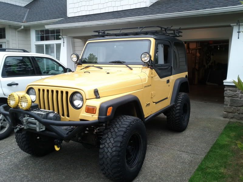

Here is a picture with one of the hard tops i ended up keeping, we went to the junkyard and took the roof rails off of explorer cut them down to size and mounted them on the hard top sealing it with silicone. As well as the light bar with the painted covers. We had to cut the corners of the light bar to fit around the windshield mounts.
The Wilderness rack i picked up from a lady who had divorced her husband and was just getting rid of a bunch of his jeep stuff he left behind. Unfortunately it was missing the other mounts for the door and rear bumper but for 80 bucks we worked around it. When we got it was covered in house paint, but it cleaned up nice.
Painted the flares with a krylon black plastic paint... (i wouldn't recommend this paint again for the flares, i'll explain later)

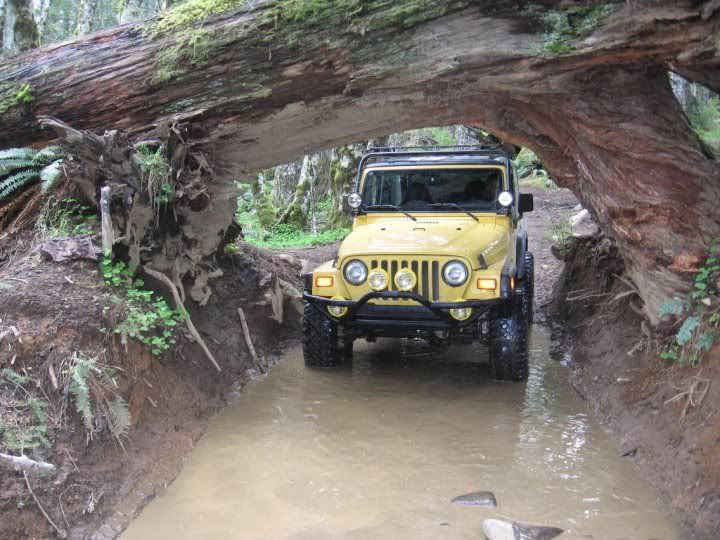

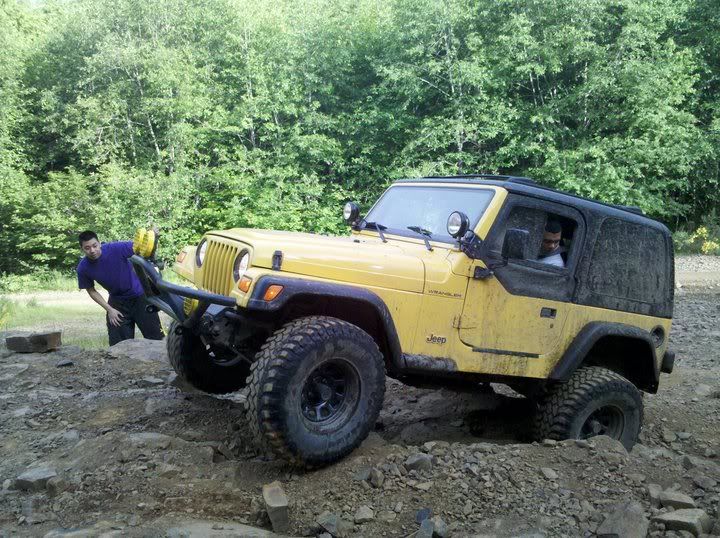

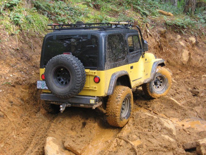

First time on Firebreak 5 at Tillamook State Forrest going down instead of up in the late fall. This is one of the more difficult and renown trails at TSF but in all honesty it has just gotten progressively easier each year. The other few are from Ceder Tree. I believe this is 2011.

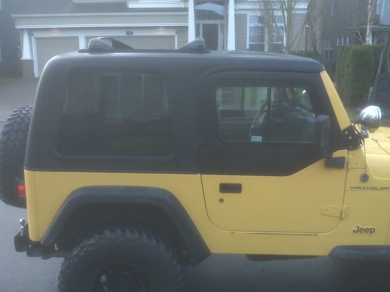

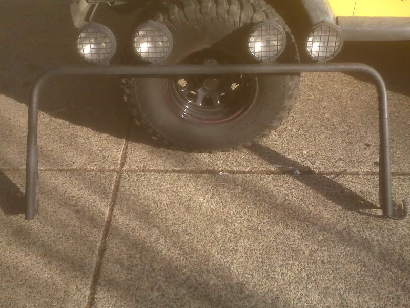

Here is a picture of just the explorer rails with the factory cross sections. I'll upload a better close up picture of how we sealed it and mounted it later.

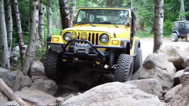

Replaced my Rough Country 2.5" coils with Rubicon Express 4.5 coils.
Rancho Shocks.
Added a Smittybilt XRC 8 winch i bought on craigslist with the TJ plate for 200.
I left the 3/4 puck in the front to try and offset the weight of the winch.
Also welded Trail-Gear sliders up to the frame.

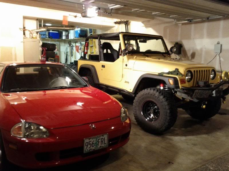

At this point it was becoming incredibly expensive to drive. Averaging around 14-16 miles to the gallon. Commuting to school, to work, back home, and occasionally farther south to visit my parents was becoming a little bit of a burden. So i picked up this 97 Civic Del Sol SI from an older couple in Battleground Washington. 85k 1 owner no accidents and averaging around 30 when you get on it, and 33 ish when i drive like a normal human being. My parents borrowed it from me to drive down to LA twice and once down to Florence for their anniversary, averaging 36,37.

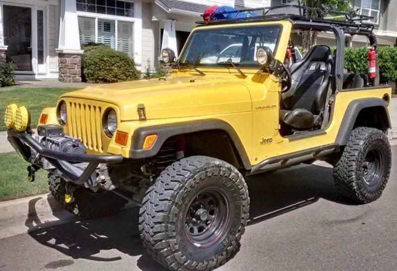

Eventually sold my BFGS for 200 bought some Toyo MTs for 500 from a guy in Vancouver WA.
Bought two bucket seats from a guy in Salem for 125, the driver had a small tear.
Fire extinguisher mounts.
Also used some hose clamps, urethane hose, and moved a couple of the bars around to mount the rack with no top. It ended up working out perfect for many of our summer camping trips. I would check to make sure everything is tight during a pre-trip check, i also wouldnt recommend putting an excessive amount of wait up there. However its pretty sturdy.
