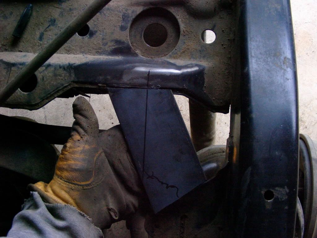

Tub mounts:
The LJ tub has two mounts under the cargo portion of the bed that do not hit the TJ frame locations (they are 4 ¾” off, C to C). WAC and I decided to make the new support from the frame cross member to the coil bucket. We used 3/16th plate. The new mounts were designed to not need the 1” BL pucks.
New body mounts in and ready for the LJ tub.
