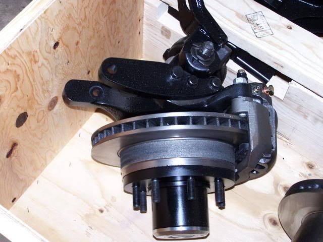

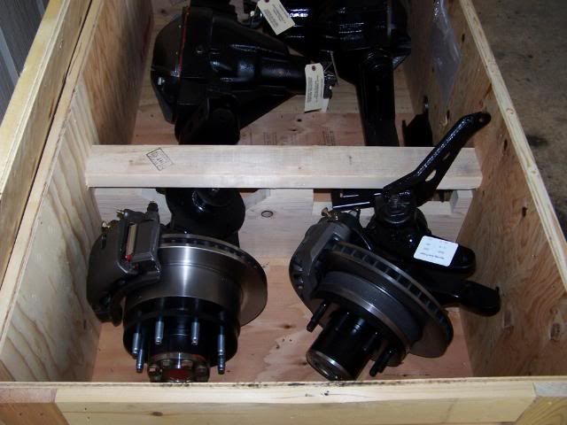

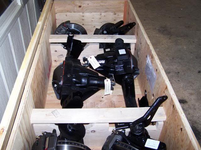

So I'm pretty sure that you guys might do a little flaming on me for these.... but here is a glimpse of what is coming my way. I was able to work out a pretty good deal/ partial trade for my Rubicon axles and wheels and tires.
Here is what will be going on the Jeep next.

Those look like bolt-in 60's......
Details, por favor.

post #60 of 111 Old 09-29-2011, 12:38 PM Thread Starter
razorback84
razorback84's Avatar
Location: Lonsdale
Posts: 468
Details, por favor.
Pro Rock 60s. Full Floating rear, 5.13's, ARB's, 65" WMS, 8 lug
I'm pretty stoked. I got a pretty good deal on them. They aren't brand new as they have been sitting in that crate for the last year or more. Never even taken out of the box. Partial trade for my 44's and my wheels and tires. I really wanted 5.38 gears, but like I said I couldn't pass these up.
Here are the specs.
Dynatrac Pro Series 60 High Pinion Front Axle Assembly
Dynatrac Pro Rock Housing Upgrade
Hubs, DynaLoc 1.5-35 spln - Axle Upgrade
Outer Shaft, 60F, 1.5" Diameter, 35 Spline - Upgrade
D60F Axle Shaft U-joint 1480 series
Inner Shaft, 60F, 1.5" Diameter, 35 Spline, Custom Length, Std. Alloy
ARB D60 35 Spl, FF 4.10
D60 Ring & Pinion, 5.13 Reverse-cut
Heavy Duty Dual Piston Disc Brake Assemblies w/ 8.6.5 Bolt Circle
Dynatrac Pro 60 Heavy Duty Outer Ends Package (Includes High Strength
Knuckles, Spindles and Wheel Hubs)
Stubby Hub Upgrade
Flange Yoke, D60, 1310, U-bolt
U-Bolt Kit 1310 Pinion Yoke
Custom Cross Over High Clearance Steering Package (Includes Heavy Duty
Tie Rod, Drag Link and RH/LH Steering Arms, Track bar Brkt)
Width - 65"
Dynatrac HD TJ Coil Spring Brkt Kit
PRO ROCK Cast Diff Cover, Iron
Axle Is Finely Detailed and Painted Dynatrac's Signature Gloss Black
Dynatrac Pro Series Reverse Cut 60 Rear Axle Assembly -
35 Spline, 1.5" Diameter, 1 Ton Heavy Duty Full Float Axle Shaft Assemblies
Heavy Duty Dual Disc Brake Assemblies with parking Brake - 8.6.5 Bolt Circle
Flange Yoke, 1350
Strap kit, 1350 Pinion Yoke
Width - 65"
Dynatrac HD TJ Coil Spring Bracket Kit
Heavy Duty Full Float Spindles, Bearings and Wheel Hubs
