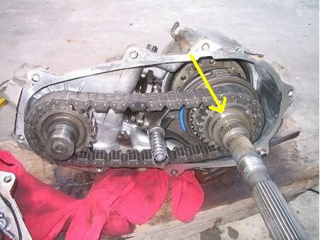

I was just looking at the picture of the case apart on page 2...
I can see the snap ring in question there on the paper-towels.
It looks like you've taken off the rear case, and removed the oil pump assembly.
So unless you'd also begun removing the front bearing retainer, it should be part of the rear assembly.
From the FSM I can see that there is a rear bearing snap ring that goes around the rear main shaft that holds the rear extension housing in place.
Maybe it's that.
Otherwise it's part of the oil pump assembly or what holds that to the rear case as part of a unit.

Yea I think its in the rear housing that I put it. Unfortunately, I just installed a new seal there. Hopefully I can pull it out and hammer it back in? It was like a $10 seal.

Just watched a video on an SYE install as I was trying to get tips on pulling the t-case. And well.. I sorta ****ted myself because I think I installed the one snap ring in the wrong place. Think I might email Advance Adapters.

As for the snap ring... which one are you referring to, and where did you put it as opposed to where should it have gone?
Try seeing if you can engage all gears manually, and if the appropriate outputs spin freely.
Of course... better to take apart and be free of mind, rather than having it weighing on you everytime you get in the jeep.
Otherwise, looks good.
Its one of the two that goes in the tailshaft housing. I thought only the one went in there. Turns out both go in to secure and center the bearing inside. And thanks!
Here's a pic of where I think I misplaced it:
