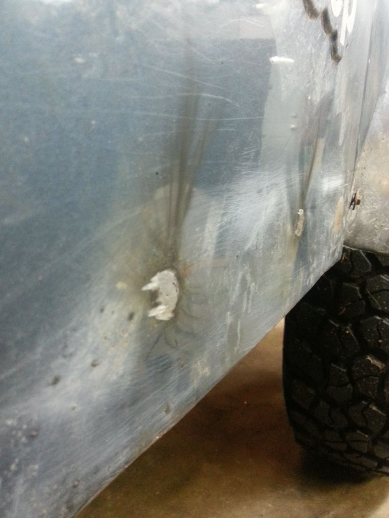

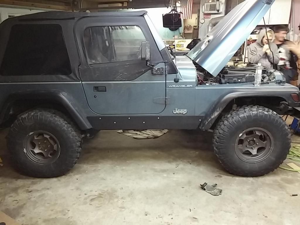

I'll look into making a new set of cables. It still starts so its not my #1 priority. In other news, I installed my sliders lastnight.
Filled in the flare holes with a tack.
Smoothed out. Sprayed them with some black paint after.
And done. I plan on adding some decent backing plates to the tub.
