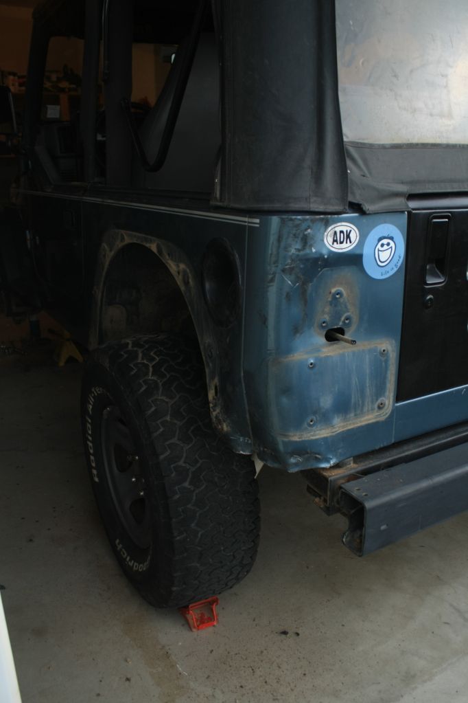

Took a hammer and big vice grips to the corner. Its getting there. Debating if I should get the pinch seam welded together? Its split 3/4 of the way up. LED's will be ordered soon. Looking at a set of MT/R's.

If you're putting corner armor on it, I'd skip it and save money. If anything, beat everything back to a reasonable shape, seam seal that crack, spray some primer/paint to cover any exposed metal, and then bolt up your armor.

My buddy would probably do it for free anyways... just a little concerned about the structural integrity of the tub. Maybe i'm just paranoid.

Corner armor would make it much more solid...weld or no weld. If it costs you nothing then I'd go for it anyway AND on both sides!

I may just weld up the seam on the inside then armor it down the road.
